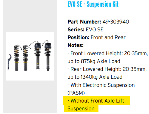

Posts: 1,041
Likes: 766
Is this the correct part number for the Turbo S? 49-320657
Old Feb 28, 2025 | 11:26 AM
  #67
SupremePower's Avatar
SupremePower
Basic Sponsor
Joined: Dec 2014
Posts: 3,798
Likes: 1,821
From: Southern CA
that is the correct part number 49-320657 if you have front axle lift.
EVO SE - Suspension Kit
Part Number: 49-320657
Series: EVO SE
Position: Front and Rear
Notes:
Front Lowered Height: FIXED Not Adjustable lowers 35mm
Rear Lowered Height: 20-35mm
With Electronic Suspension (PASM)
With Front Axle Lift Suspension
WOUT FAL:
Part Number: 49-303940
Series: EVO SE
Notes:
Front Lowered Height: 10-25mm
Rear Lowered Height: 10-25mm
Without Front Axle Lift Suspension
We have them in stock.
