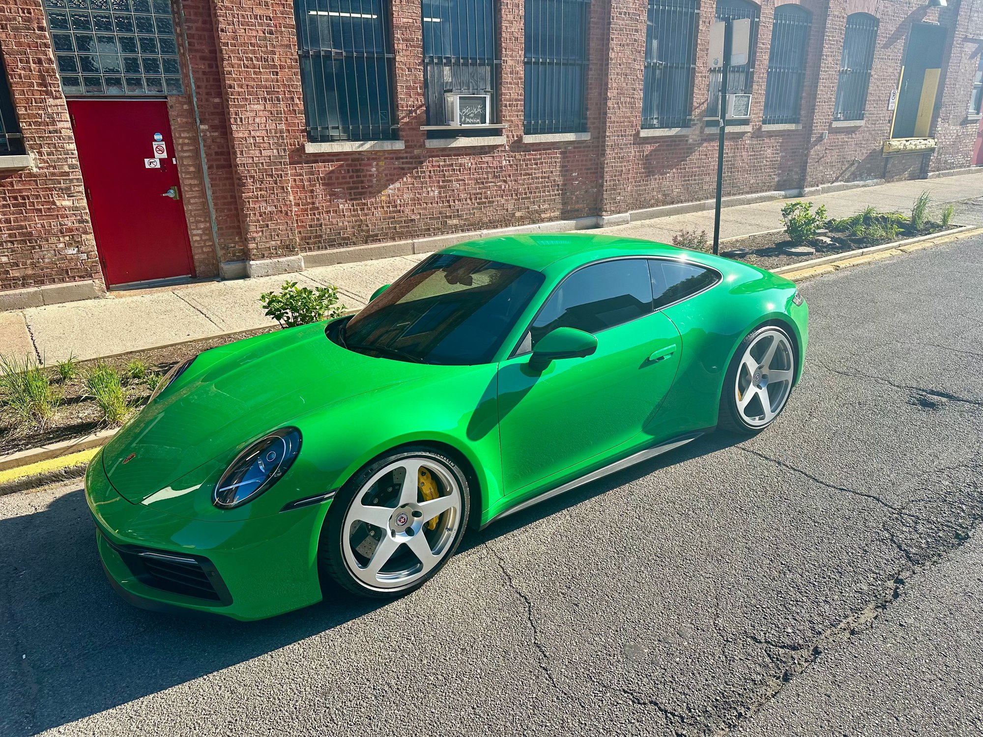

Installed! Ride quality is incredible, near OEM if not identical. It needs to come up a bit from the height pictured as my driveway doesn’t want to be a good partner in this relationship, but none the less, it’s money and time well spent.
Much much better. I am loving my Bilsteins more and more each day. They do break in and feel sublime.

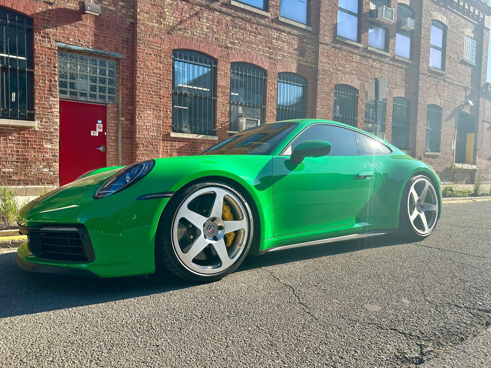

Just got them installed took about 4 hours

Will say initial ride is noticeably firmer than stock spasm.
not as firm as the firm setting on the spasm.
gona let the car settle for a week of so, get an alignment and put few hundred miles on it to see how it settles in.
