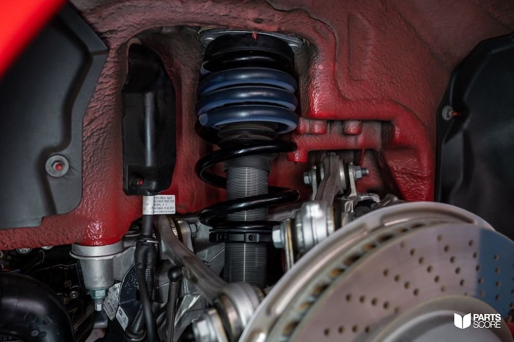

If you have FAL, that version has one set height for the front that drops it like 25mm or 1 inch. However the non-FAL version of the BIlstein EVO coilovers has a good adjustment range and you can set the front very close to stock SPASM and the rear can be easily set to stock height. Here are pictures of my lowered car and the front and rear spring perches showing how much thread is left to raise the car. There is a ton of space to raise the rear and I can raise the front end by about 5/8" which would put it close to stock height as my car is lowered about 3/4" lower than stock SPASM in the front and 5/8" in rear. So theoretically you should be able to set them at 1/8" to 1/4" lower than stock in front and stock height in rear:
Current height lowered 3/4" F and 5/8" rear:
Front suspension perch setting. You can raise this perch about 5/8" which would place it 1/8" below stock SPASM:
Rear spring perch setting. Note the massive amount of threads above and below the spring perch. You can easily raise the rear up to stock height or higher:
I very much like the stock gt3 Hight, so having FAL and getting to get just about that low is perfect!
