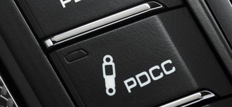

Or the easy way...
You'll have PDCC along with the shock icon on that button if it has. Just the shock icon if not.

Originally Posted by eysa
It does have the button with the shock icon above the traction button if that means anything.
That is the PASM button. In later cars that button has PDCC written on it to identify if PDCC is also equipped. In earlier cars those letters were not there even if so equipped. You have to rely on the build sheet or, if serviced by a dealer, whether the PDCC reservoir was checked or changed (at six years)

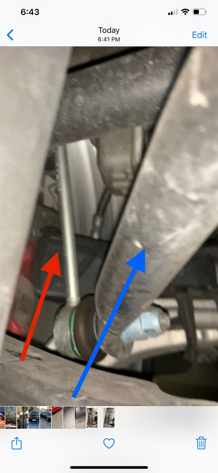

Is that the drop links pointed by red arrow and sway bar point by the blue? If so then it doesn’t have PDCC, correct?
Old Oct 22, 2019 | 11:46 PM
arter's Avatar
arter
Joined: Jun 2014
Posts: 1,077
Likes: 167
correct
Yup.
Originally Posted by arter
correct
And yup.
Prima facie: no PDCC.
