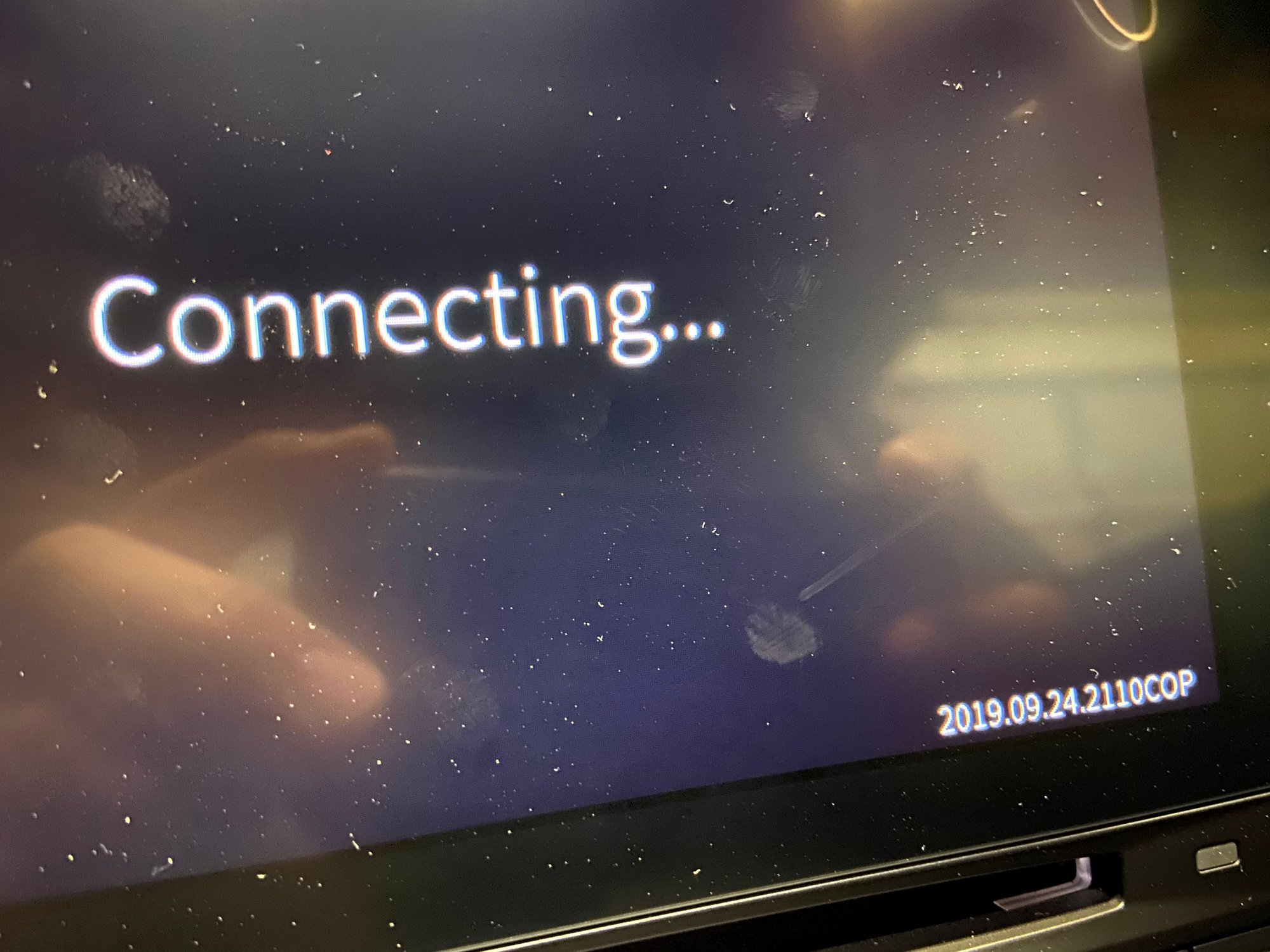

my firmware is same as this:
Originally Posted by porsche bud
My FW version is slightly newer it appears and I received the product a couple days ago.
My BT pairing and connection worked on the first try if that’s helpful for anyone. And now only connects via Wi-Fi when I get in the car.

As I showed in an earlier picture mine is 2019.09.16.1412COP I realize it's not the newest, and it's not in English. I have an X with iOS13.1.3

I cannot connect. It should be noted that I am very tech savvy.
Originally Posted by SeymourButts
For those of you who cannot connect, what version firmware to you have on your iPhone. iOS12 or iOS13? And what generation iPhone do you have? X, 11Pro...?
Xs MAX, iOS 13.2

Well I'm not tech savy. Here are the instructions I got to update the firmware. Can I use a USB Flashdrive and how do I format to FAT32?
this is new firmware to upgrade the dongle.
how to upgrade ?
1. Format the U disk to FAT32 format
2. Place the AutoBox_Update.img file in the root directory of the USB flash drive.
3. Insert the product into the car's USB interface, insert the U disk after the standby interface comes out.
4. Upgrade process, upgrading -> upgrade completed, unplugged U disk
please upgrade the dongle on the page of [waiting for connection]

yes on usb flashdrive and its more thank likely already formatted fat32.
can we share files via this site? can any post the firmware somewhere on the infonets? I am happy to guinea pig through this?
