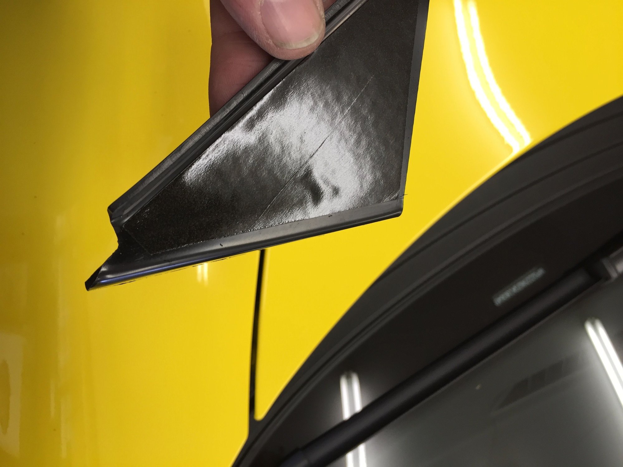

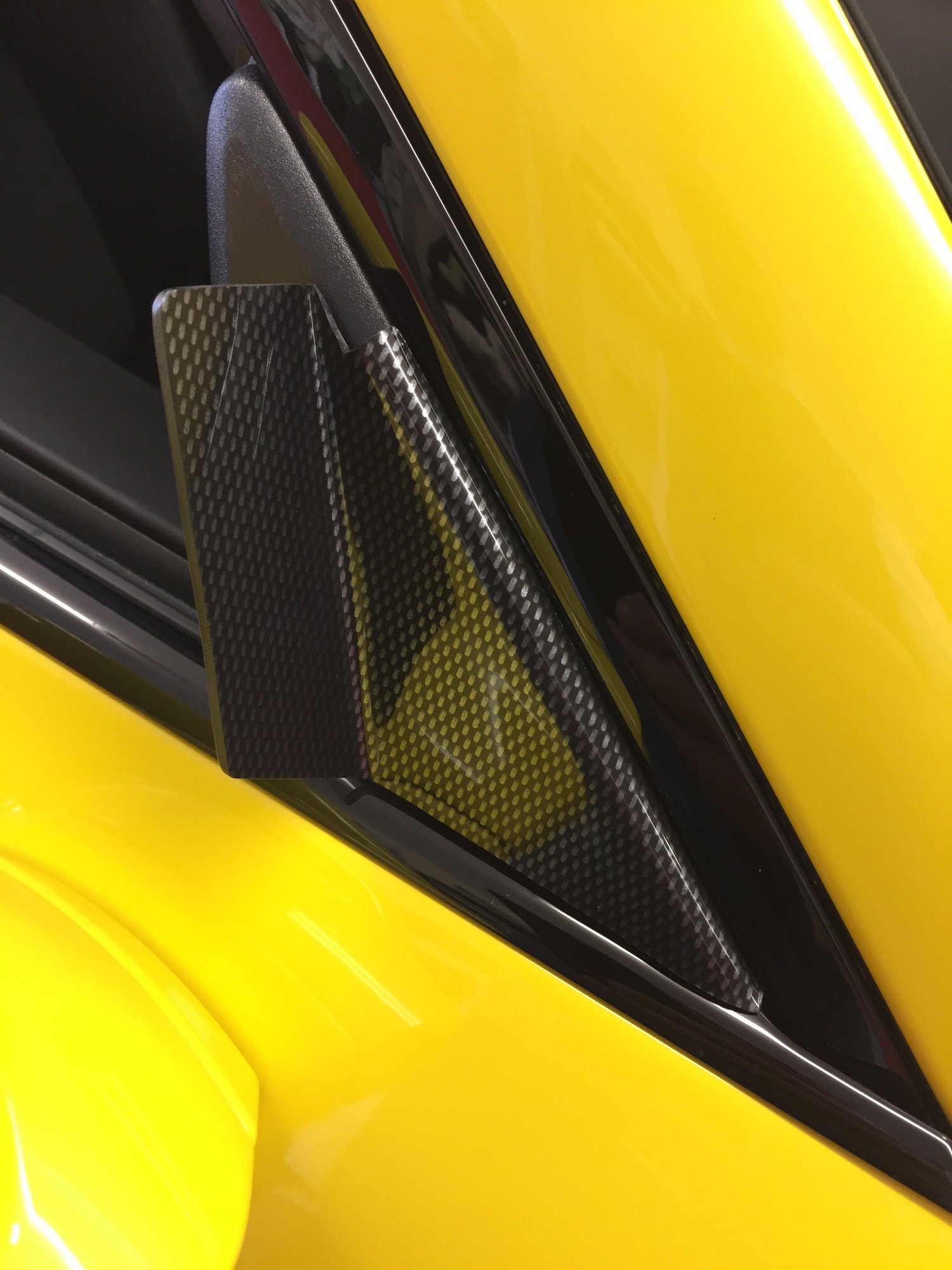

I made a set from Carbon Plastic Sheet. I do think what they want for them is a bit steep, so I thought I would make a pair in 2015. (The pictures are the first ones I made.)
Buy the sheet here: https://www.ebay.co.uk/itm/3mm-Black...EAaVJtH-fIZzRQ
Cut the shape out of very thin card first, draw around it and cut it out of the plastic sheet. Use 3M double sided tape to apply. They come back off easy too, no marks.
You need a heat gun and a couple of straight edges in a vice to bend it around. I even made the curve for covering the joint at the front leading edge by bending it around a screw driver shaft.
It files and you can polish the edges super smooth. They even look like carbon. We use this stuff on the off road bike frames.
I even used the same cut out for my new 991.2 GTS off the GTS Cayman in March this year. Ok I had to made the first one twice as I over heated it. If your ok with DIY it takes and hour tops.
The rough edges I smoothed out, they then look like factory fitted.
