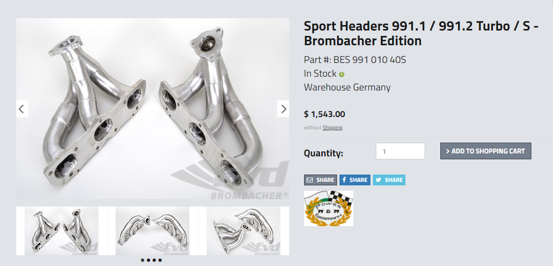

Is it the equal length of the tubes that smooths the exhaust flow? Or does it have more to do with the design of the merge collector?
I ask because I am also interested in the headers from FVD Brombacher:
https://www.fvd.net/us-en/BES9910104...r-edition.html
Both. A rotary vs flat collector influences the adjacent primaries differently. A rotary collector influences adjacent primaries equally, a flat collector does not. A similar statement can be made with primary length; equal length will give consistent flow performance from each primary. The Brombacher header you've shown here is not equal length.
