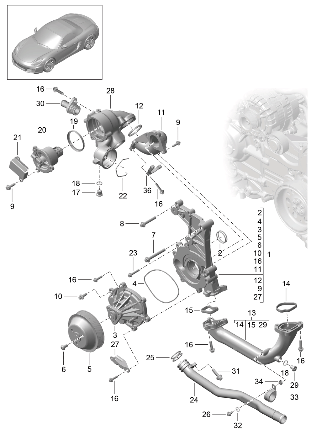

Can you tell me one specifically you are referring to? "The plastic tube that cracked is a known weak link on the engines"
Part number 13 in this image. Porsche part number 9A1-106-026-31. I found it at porschemarinparts.com for $62.73, list price is $90.41.

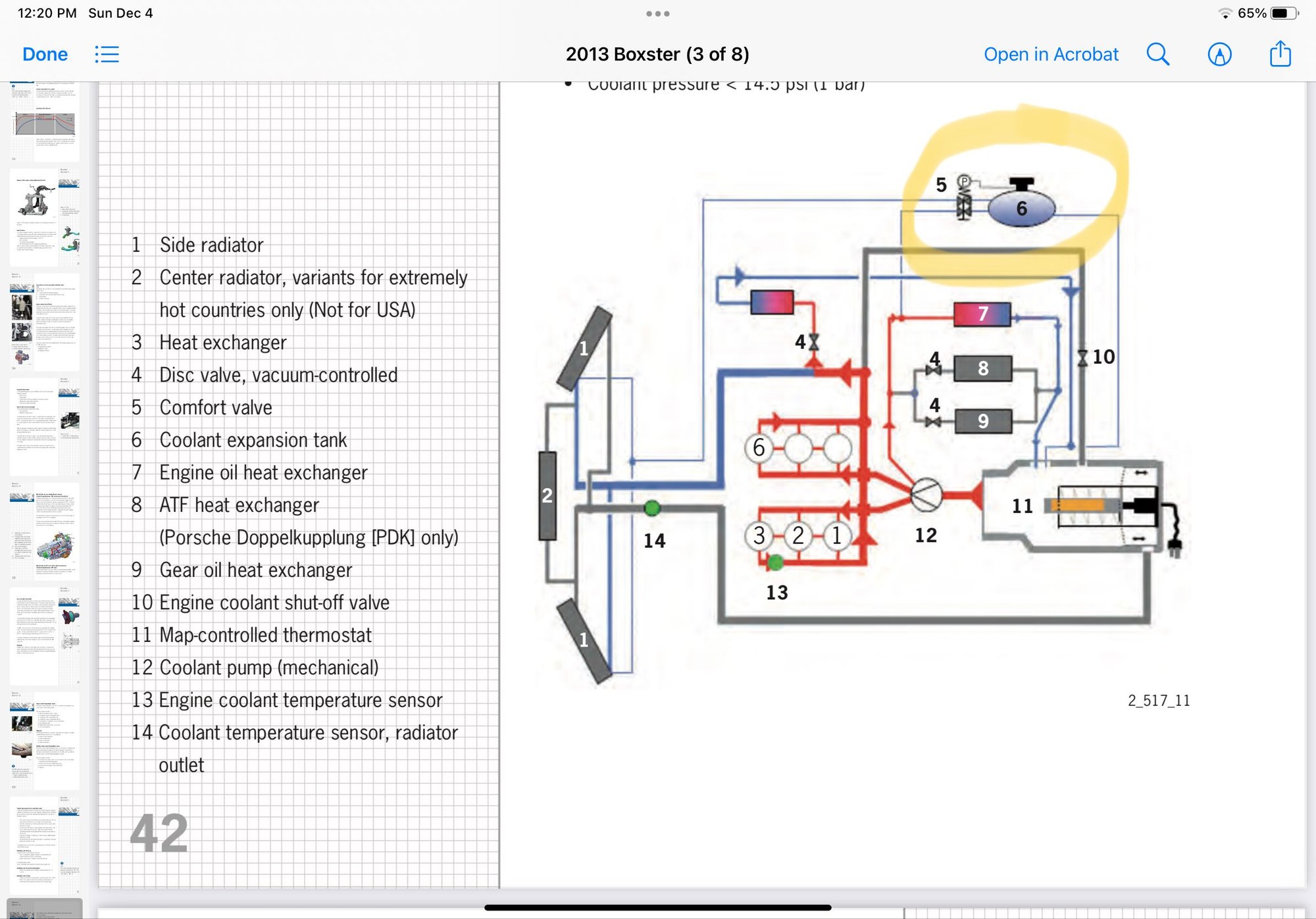

^^^^This. I also have performed two drain and fills on my 981CS and used the Airlift with great results. Once for a FF1 engine mount insert that requires radiator hose removal and again for a center radiator installation. I do have a large 60 gallon compressor and was able to pull 25” of vacuum but there are tricks with a small compressor by doing it in stages that should also work. I think that the more complete the drain that the more successful the vacuum fill is and not for a top off​​​​​​. I did leave the top engine cover loose for a few heat/cool cycles and added a few ounces of coolant to make sure I had a complete fill before reinstalling the engine cover and carpet and trim. There is also a air bleed (comfort valve #5 on diagram) which is a network of lines from the tops of the radiators and heat exchangers and high spots in the system to the valve at the top of the coolant expansion tank that vents the air pockets internally to the expansion tank. That control valve can also be manually flipped to an open position and can go through a heat cycle for a more complete bleed……at least that’s my theory 🤔.
