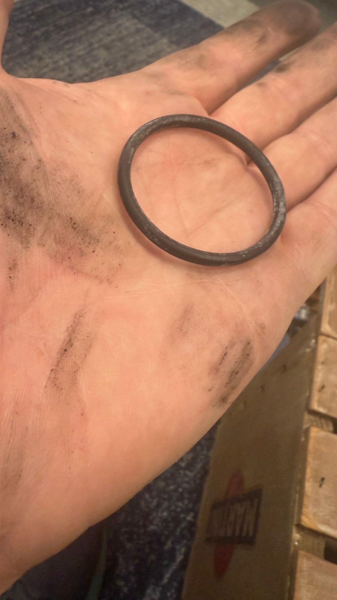

Found this on garage floor. I’m not even sure it came from my 964. Engine is out and did suspension/brake upgrades.
any ideas?
any ideas?
That looks similar to the o-ring I just replaced in my oil cap.

What material is it? Looks like it has some rust / exposure dust on it but hard to tell.
Rubber. It's cleaner than my hands...which makes me think it could be a different project that somehow camo'd itself on the floor during cleanups.
