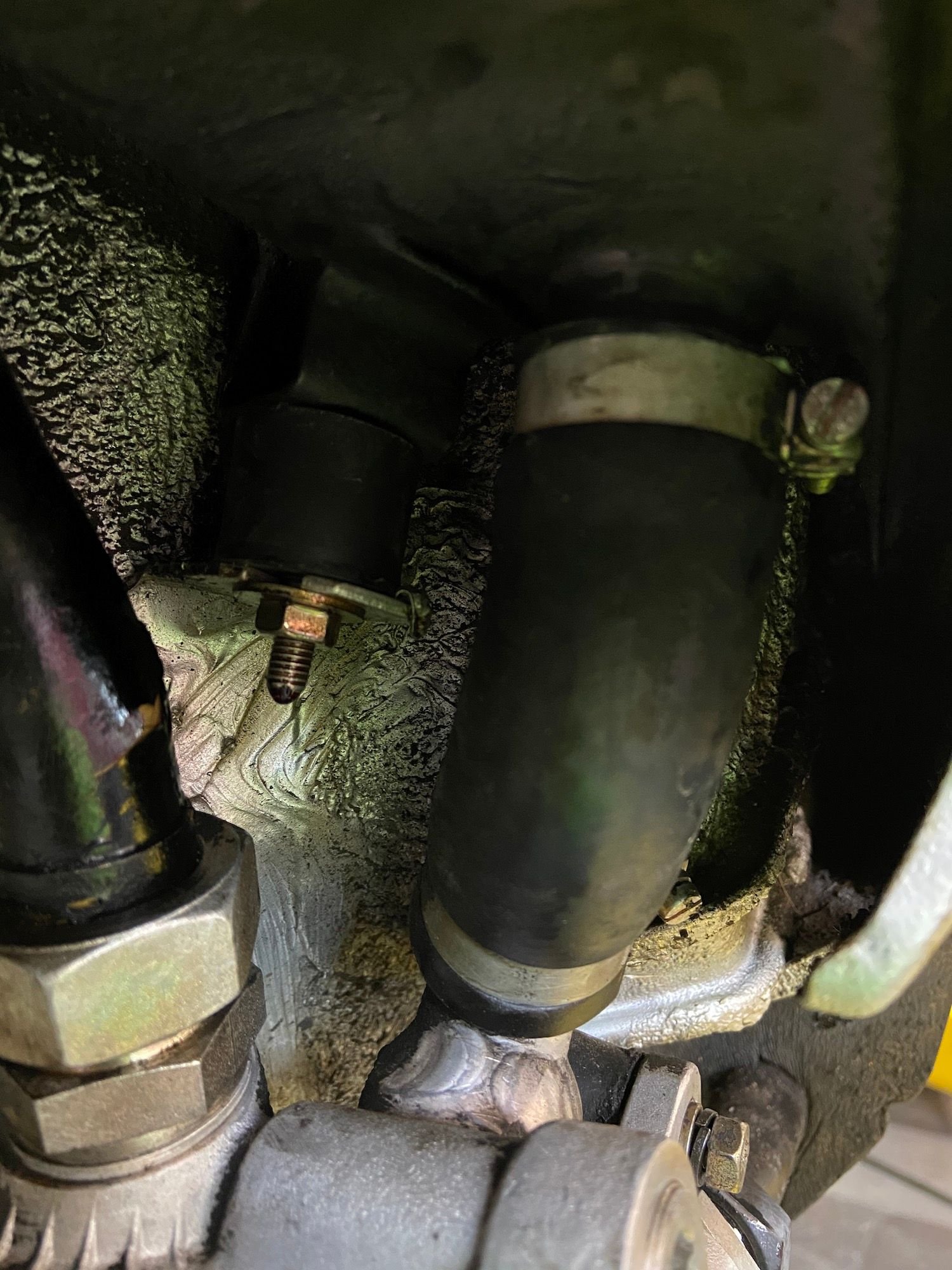

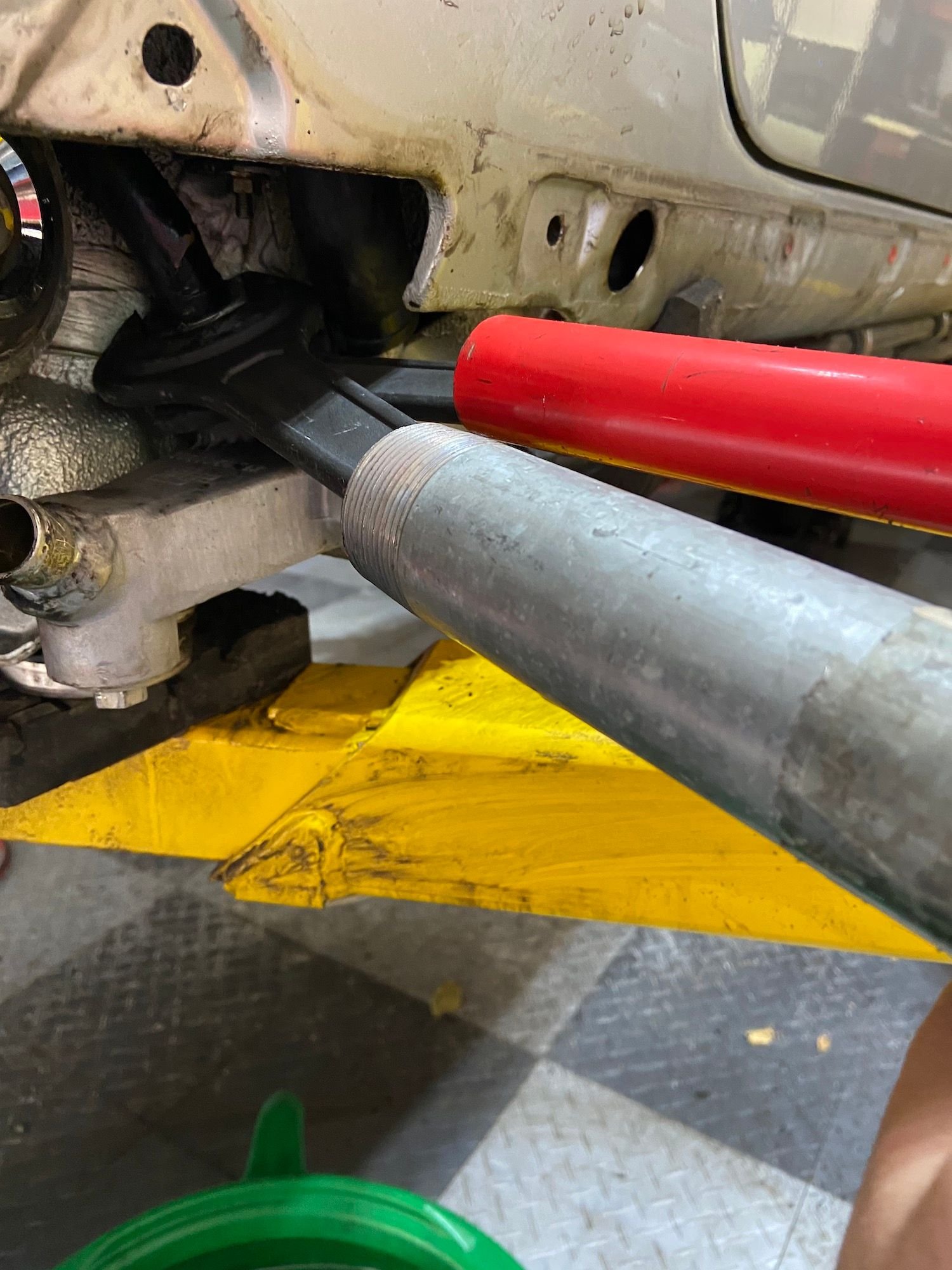

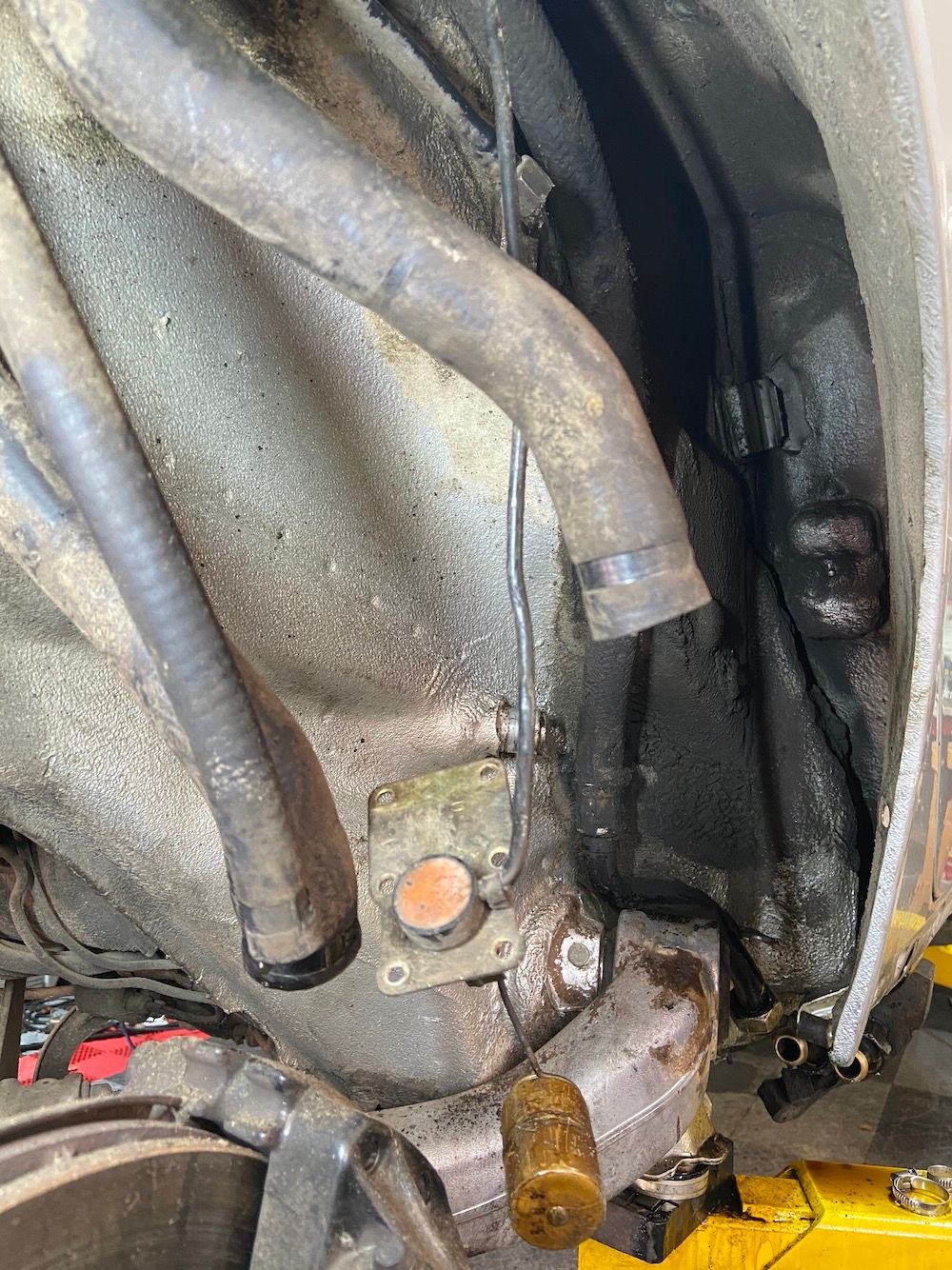

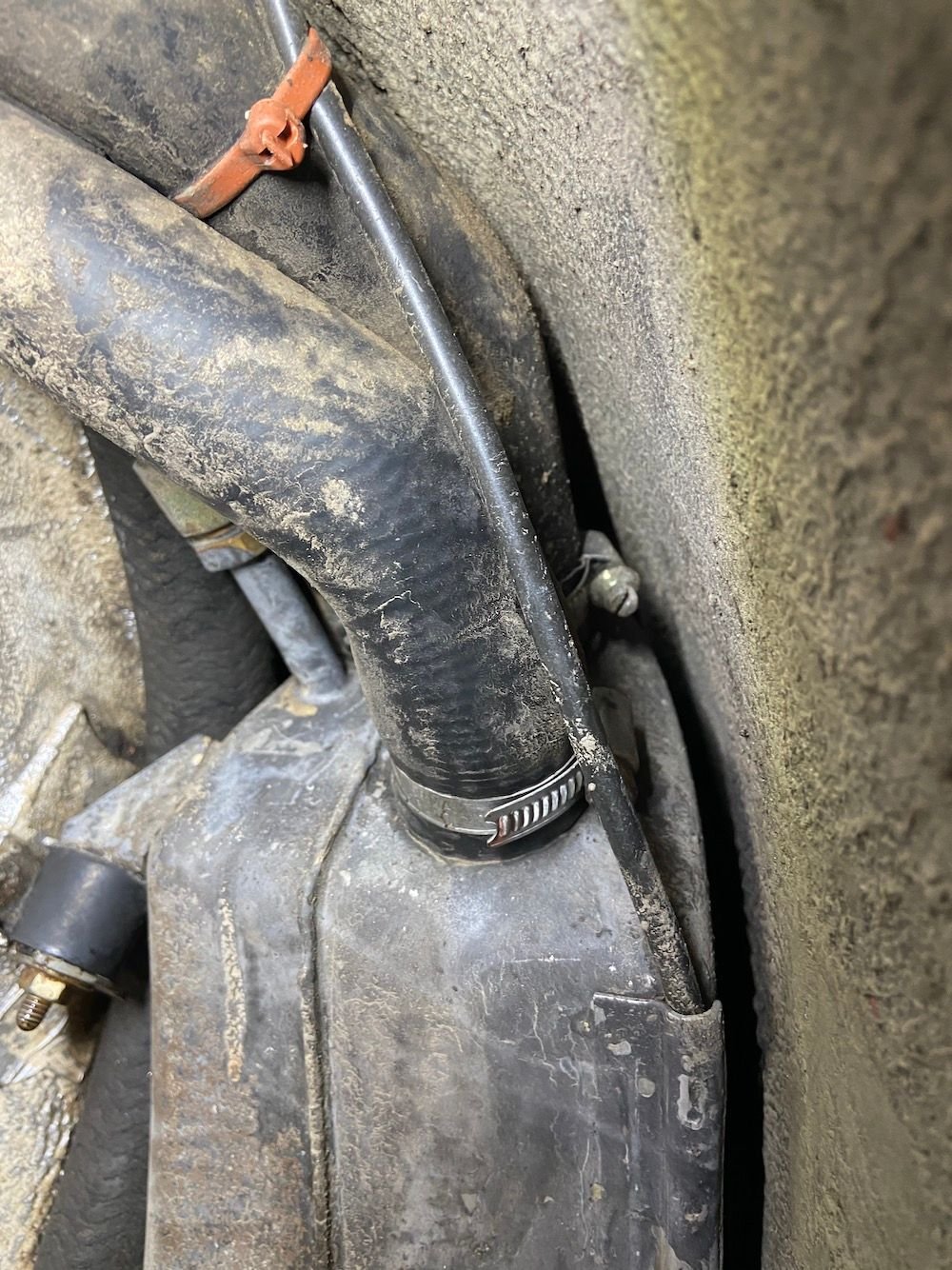

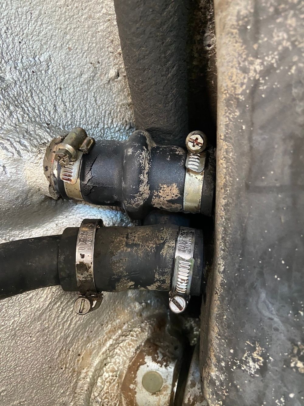

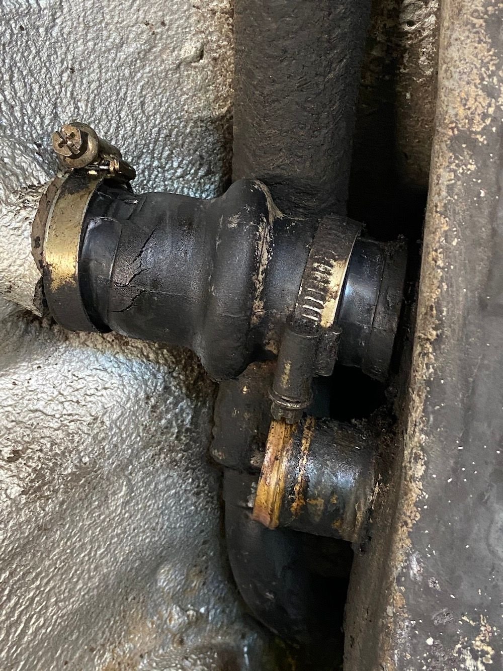

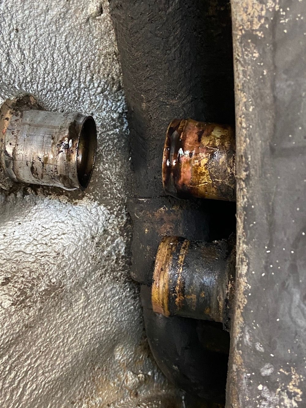

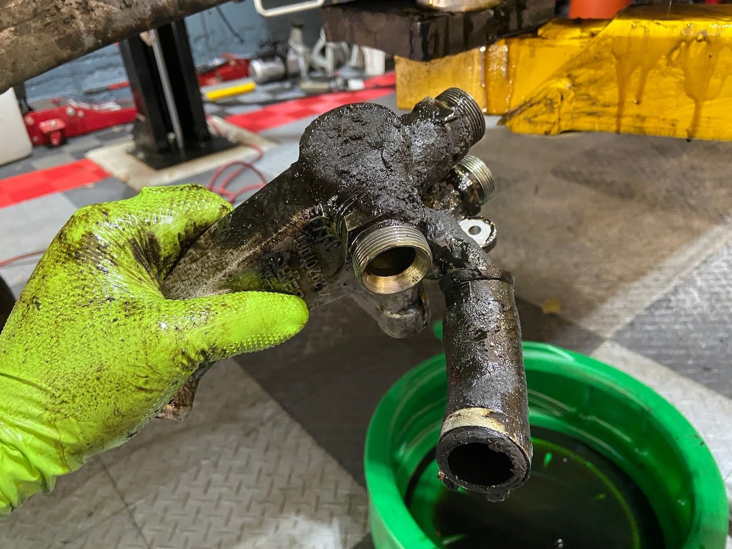

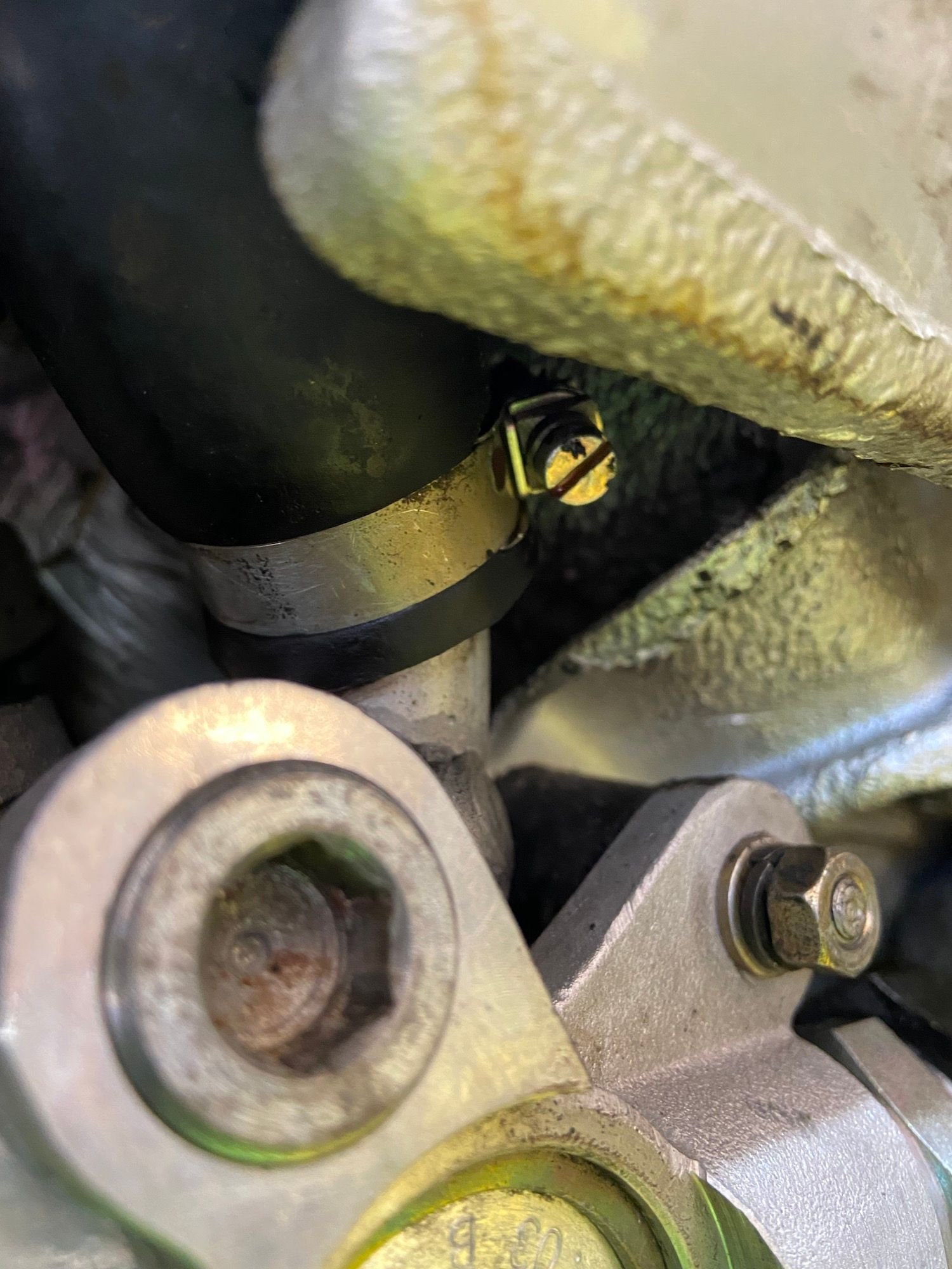

Alright! Thermostat housing successfully extracted. I used the Sir Tools oil wrenches and some pipes to get some extra leverage to loosen. Of course I smashed my fingers in the process, and I knew it was coming, but my smashed finger was worth it. I loved Goughary's turnbuckle trick documentation but thankfully didn't have to run to Home Depot to reproduce.
From the Oil Line Madness Thread:
I bought myself a nice set of Hazet screwdrivers recently because I always hated my Craftsman ones. These have a little hex nut at the base of the handle and it came in handy to get some extra leverage to loosen one of the screw clamps where a flat blade screwdriver is all that is possible.
My handy leverage pipes because I have the strength of "Mr Burns" (Simpsons reference) in my arms.
Look at this nastiness hidden behind the thermostat housing (didn't get to it with the steam wand).
Now to dump all clamps and parts into the Ultrasonic cleaner after a quick clean in the regular parts washer.

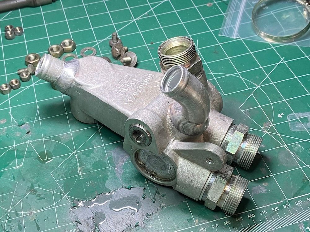

Thanks, I think, I will add it to the parts list. And thanks for providing these links to me on Thermostat overhaul.
https://rennlist.com/forums/964-foru...-overhaul.html
https://rennlist.com/forums/964-foru...t-fixed-3.html
My thermostat after ultrasonic cleaning

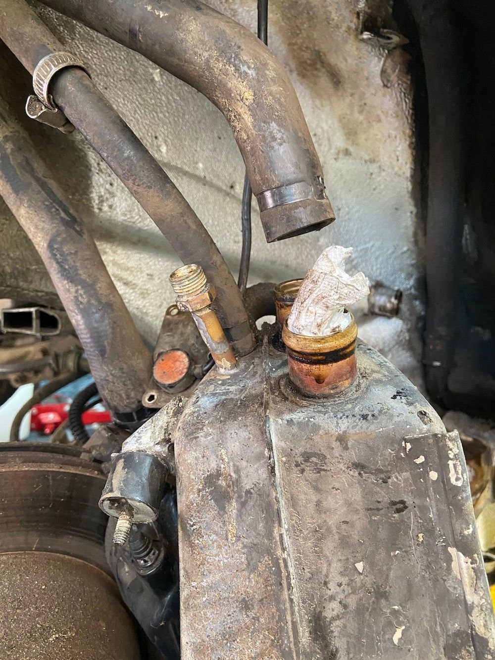

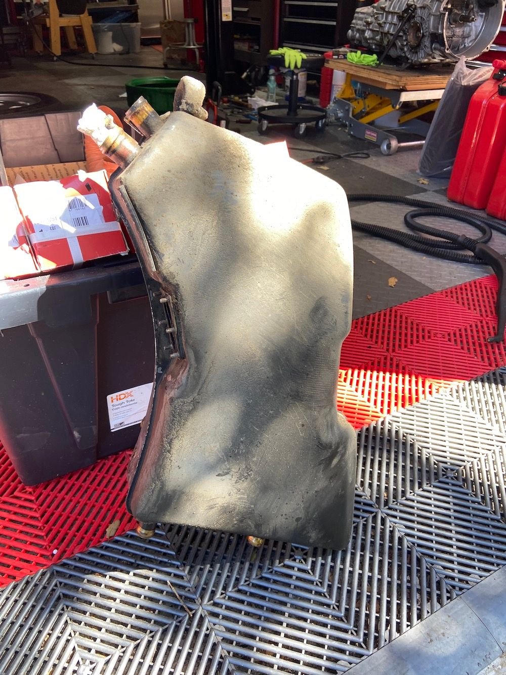

And the tank is out! This job totally sucks but I took my time and everything went smoothly. All that is left is to remove the main oil line. Hope I can break it free without removing the rear bumper.

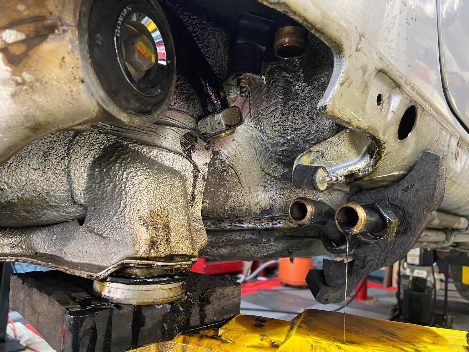

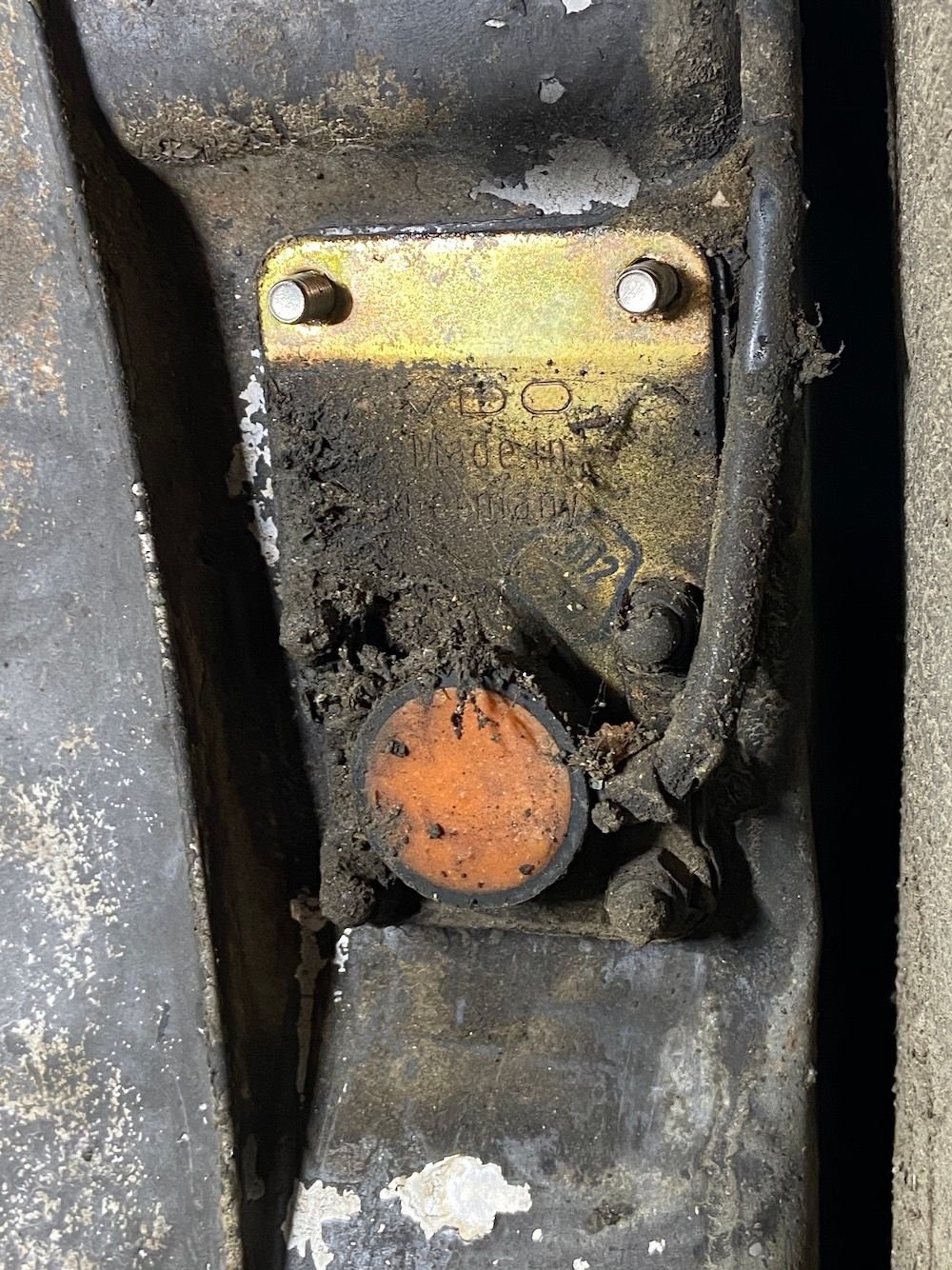

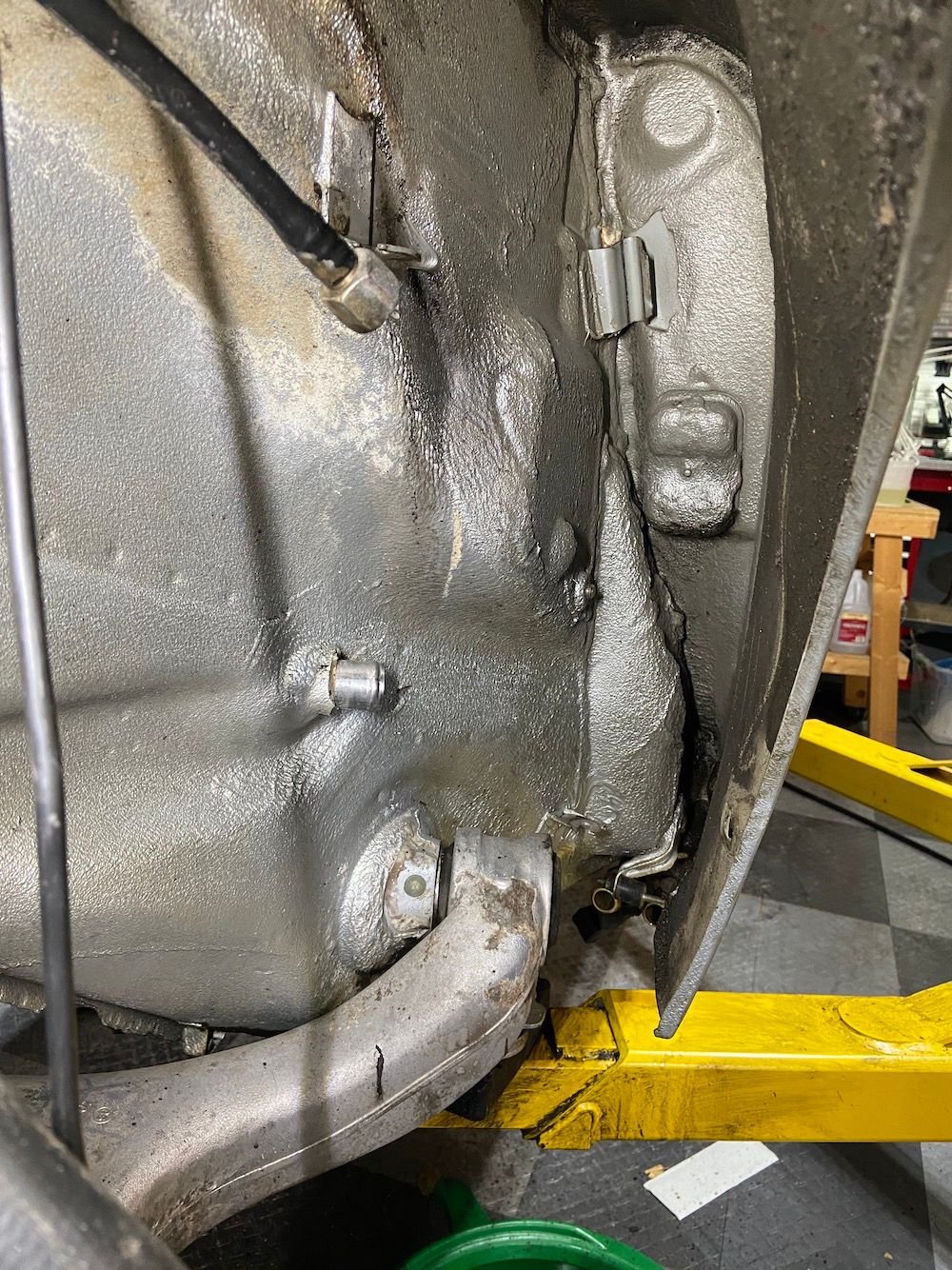

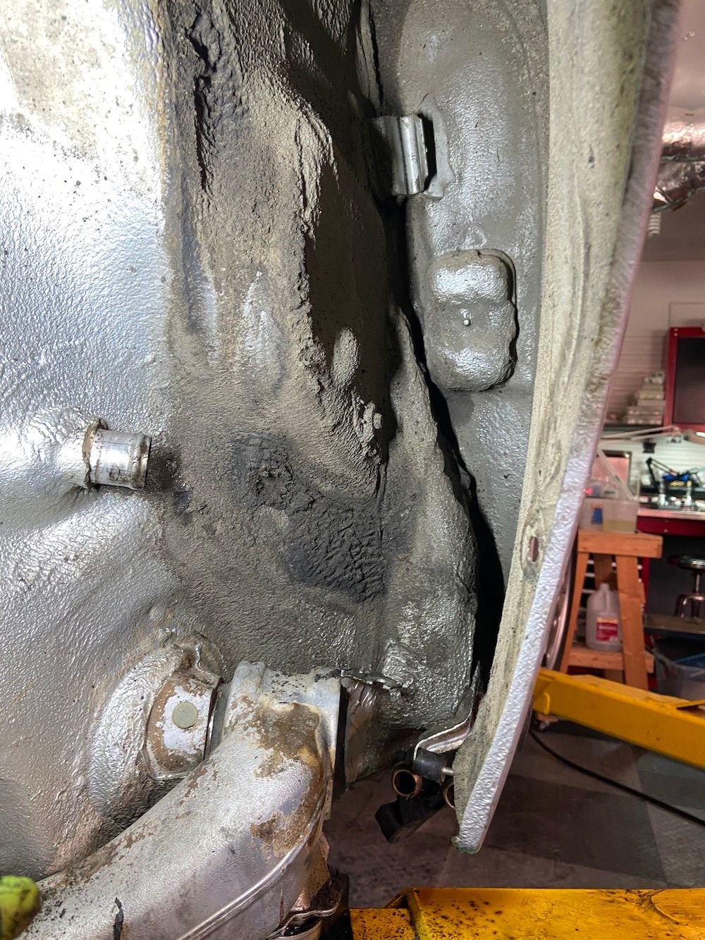

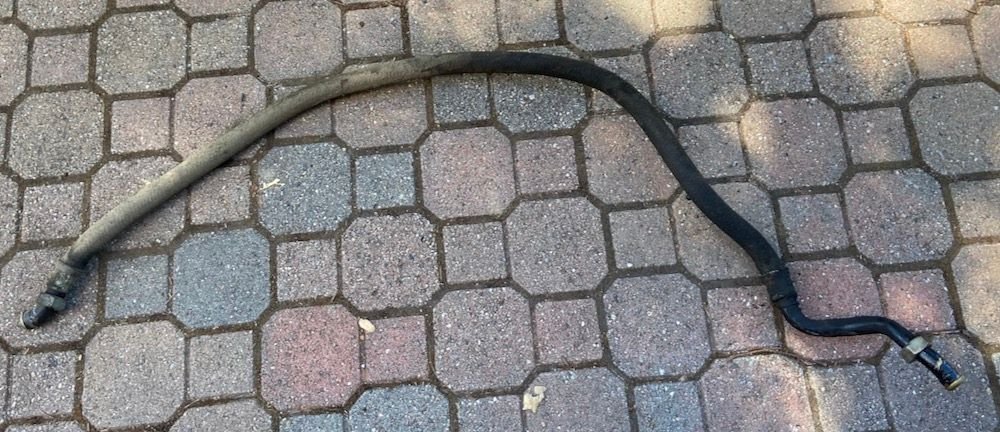

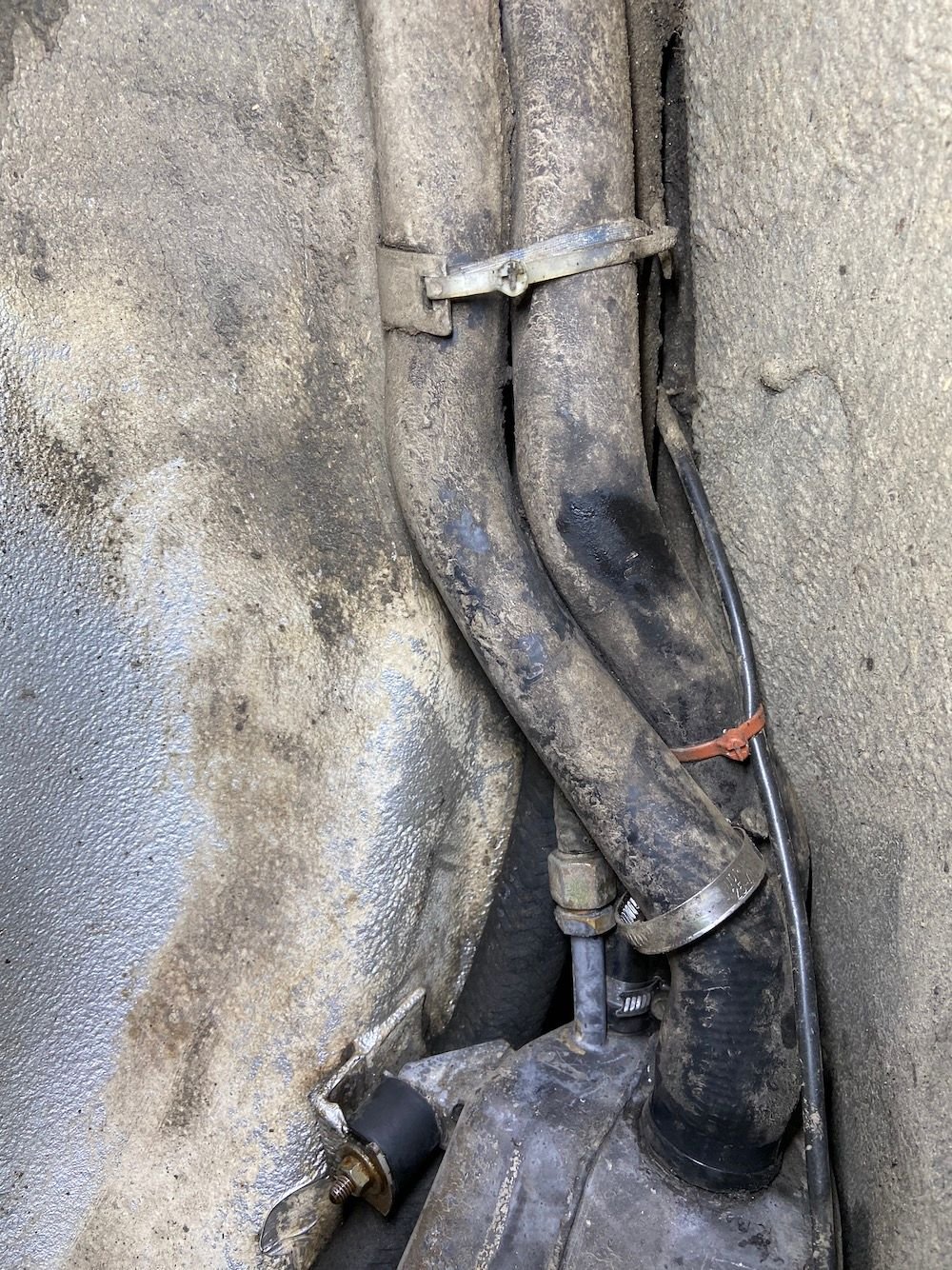

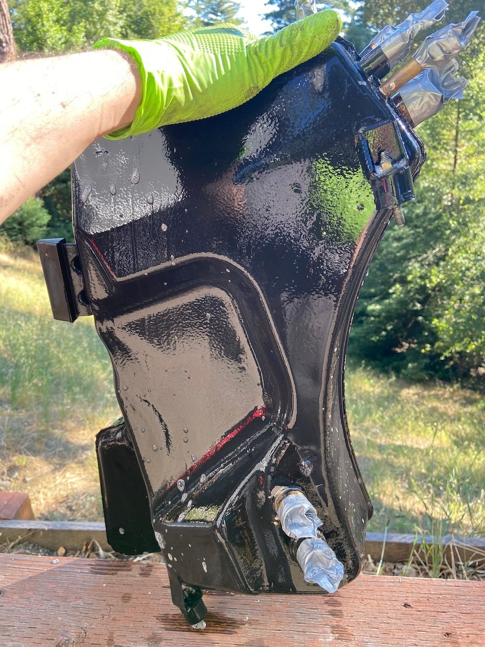

What a mess. Now I need to order parts an re-assemble. I got the main line out without removing the bumper with the Sir Tools oil line wrenches and my leverage pipes on the end to crack it open.
The main oil line is ok but I don't trust it. I will look into getting it rebuild at Elephant Racing and report back.
Carefully washed up the tank keeping water out of the inside. I will probably flush it with oil before install in case any spec of dirt got inside.
Oil tank area BEFORE steam cleaning.
And after (and yes Goughary) careful not to get water in the lines, you would have to aim the nozzle directly up the pipes to do so.
It is ready for re-assembly. Hope I can get parts before my upcoming 4 day weekend but plenty of other work to do.

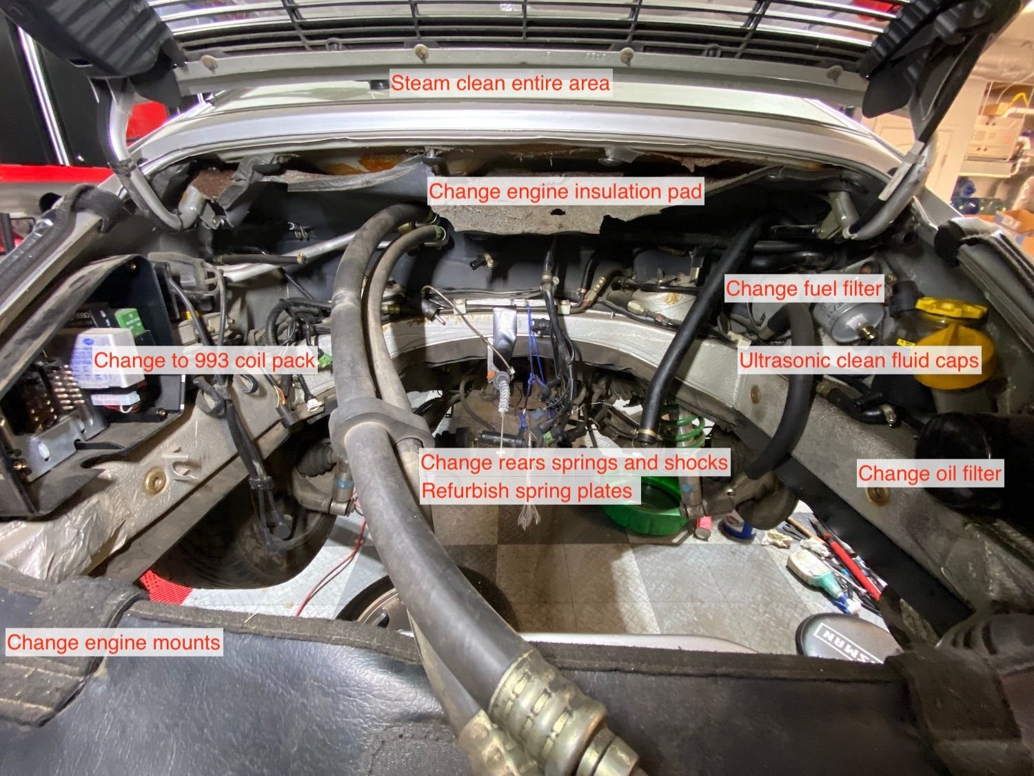

Here is my project for the long weekend. I won't be able to get to it all as I don't have all the parts but first it starts with steam cleaning.
