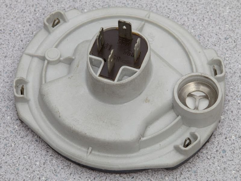

Thanks! Any guidance on upgrading to LED headlight bulbs for the popup headlights on a 1978 Porsche 928 Euro with the 8" lights?
I've not seen a euro 8" but if this looks like the bulb retainer (held in the reflector by a spring clip) look here:
https://rennlist.com/forums/928-foru...id-or-led.html
These fanless H4 units have worked well for me. I have since put Lasfit bulbs of different types on all of my cars.
https://rennlist.com/forums/928-foru...al-shroud.html
Lasfit has apparently mostly abandoned Amazon so I ordered directly from their website, recently.
https://www.lasfit.com/products/fanl...9003-led-bulbs
