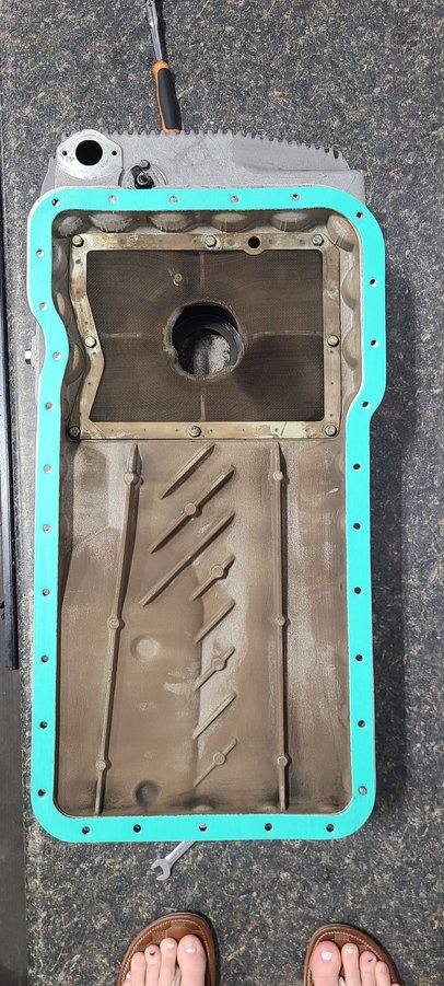

As always I appreciate the feedback. We have been making the pan gaskets for nearly 20 years after we developed the silicone gasket.
About two years ago our seal manufacturer offered a new gasket material - similar to GB's I believe - which as GB says is superior. This is a readily available gasket material and not some special material made to order.
Initially, we found that using the same tooling as for the silicone gasket, produced a gasket that did not quite fit as per this post. There is no "give" in the material versus cork and silicone.
We then made adjustments to the tooling to better accommodate a rigid none flexible material.
I do not know the customers name so I cannot see when we supplied this gasket. Had we been contacted - we are very approachable - we would have responded accordingly.
To ensure an even better fit we will supply an oil pan to the manufacturer and if necessary make adjustments to the tooling.
As for shipping - this is a large seal and not flexible - we ship in a special box. Shipping prices continue to increase and are out side of my control.

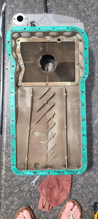

Sorry for the delay. That UBER oil pan gasket in this thread, was one of our first batch made using the silicone OP tooling. As I do not know the customer I can't research any further - we sell about 20 a month.
We improved the fit about 18 months ago after Sean found the same issue as Speedtoys. Shame he (speedtoys) did not contact us but I am sure he had an ulterior motive 8>. We could have easily replaced it and overnighted one of our current gaskets - but there you go.
Sean had just removed a GB gasket from a customers car (nothing wrong with it just replacing a pickup seal). We had the chance to compare one on top of the other. There is a slight difference in a couple of the holes but certainly not enough to cause a fitment issue.
The main difference is the four holes at the front but a little flex and the holes line up.
But to ensure our gasket is perfect, we are sending an oil pan to the gasket manufacturer, to ensure a 100% fit with upgraded tooling.
Pictures for comparison. TOP = 928sRus Bottom = GB
