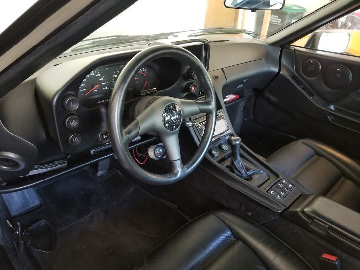

Great video. Man, your streets are wavy (lol). Why didn't you go past 2nd gear? Also, what it that screen above the center dash vent?
That is one of the several mods from a previous owner. It's a GPS system that they attached to a PERFECT dash. 😠🤦‍♂️ The owner's manual was included in the sale. It runs off a CD that has specific regions on it. When it boots up, it trys to show me San Francisco. The CD runs in the player that's mounted to the passenger under tray. At some pt I'll see what it'll take to remove it but that's a ways down the road.
