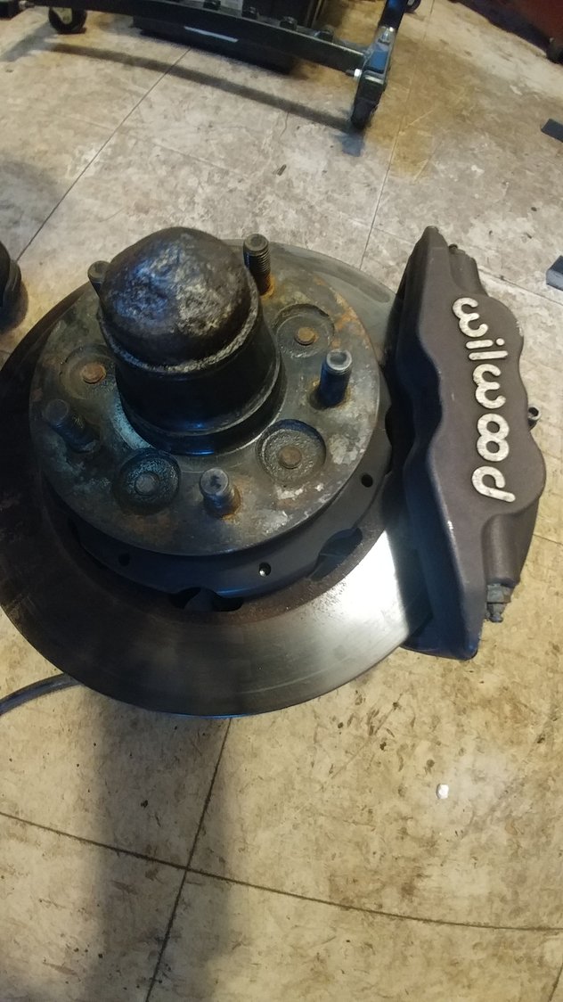

As to the brake argument Greg is making, for those trying to play along at home....Greg doesn't like the fact that the 330mm rotor being used is larger than the brake caliper / pad.
The 330mm rotor in question is from a 2011 or so Cayenne: a 4,700lb vehicle
Largest stock 928 rotor is the GTS @ 322mm
Here is the original thread where XChop shared his development of this setup:
https://rennlist.com/forums/928-foru...otor-swap.html
Running a larger rotor in such a way is a "budget" way to increase the size / power of your brakes. I found this post on another forum that explains it better than I could:
Of course bigger rotors improve braking performance.....even with the same calipers and brake pressure (the other two variables in brake performance). It has more torque (force x distance to moment) due to the longer moment. It also has more 'metal' passing through the caliper for a given rotation.....and finally on the thermodynamics side, there is more mass in the rotor to act as a heat soak, and more surface area to dissipate said heat. All positive things for a brake system.
This technique has been discussed at great length in this forum and for the most part, an accepted practice.
Here is one of the original threads on the subject with Kibort researching how to stuff larger rotors under the stock calipers on his race car:
https://rennlist.com/forums/928-foru...he-rotors.html
After some race miles:
https://rennlist.com/forums/928-foru...e-results.html
Here is another Rennlister going the next step stuffing 350mm rotors under S4 calipers:
https://rennlist.com/forums/928-foru...e-upgrade.html
As Greg also pointed out, this practice is never used (that I'm aware of) in OEM applications......kind of. There are cases where manufacturers increased caliper / rotor size but did not increase the size of the brake pad.
Pad size can also come into play, my research did not easily pull up what size pad is used with these Willwood calipers.

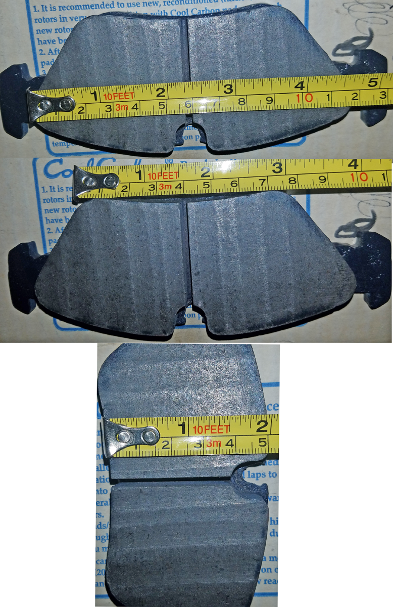

I'm actually concerned about the pad area of this caliper. A stock 944 turbo has a much larger pad area than this caliper. Lighter, less power, less acceleration/speed potential. Dramatically larger brake pads!
Brakes work by friction. Friction turns to heat. People install larger calipers with larger pads in order to "absorb" this additional heat, as the power potential of a given car increases.
These calipers have pads the size of stock "early" 928's. They are going to stop adequately, until the pads overheat. You drive the car to "cars and coffee" it's entire life...no issue. You drive it like a "Pro Touring" car it is supposed to be...you are going to die.
Anyone want to go 200mph in this car and have to stop in a big hurry?
Hell, let's make up some adaptors and fit thsee calipers onto a Veyron. Would save some significant weight and the brake pads would be 1/50 the price of stock pads!
Of course, everyone here knows (hopefully) that would ne a ridiculous idea.
Yet, these front brakes are the perfect application for the potential of this car?
The choice of calipers, for this car, is severely mismatched to the potential of this car!

Ok, to pad volume. I was curious myself.
Originally Posted by GregBBRD
Look at what is contacting your rotor. You have approximately the swept pad area of a 1981 928, which is 6.9 square inches per pad. I doubt your swept pad area even gets to 1983 928S specs of 8.1 square inches!
Not questioning, just curious, where are you getting your numbers? I was trying to find them somewhere without having to manually measure them.
However, I am holding a set of new 78-82 pads
Willwood Pad in question:
Stock 78-81 Pads:

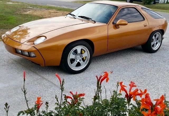

I've got the Wilwood/Xschop kit installed on Just Peachy. (3,083 lbs, 1/2 tank fuel) Was running in group 1 (very fast) a few years back at 3rd Coast....no problems with fade. (MY1980). T
