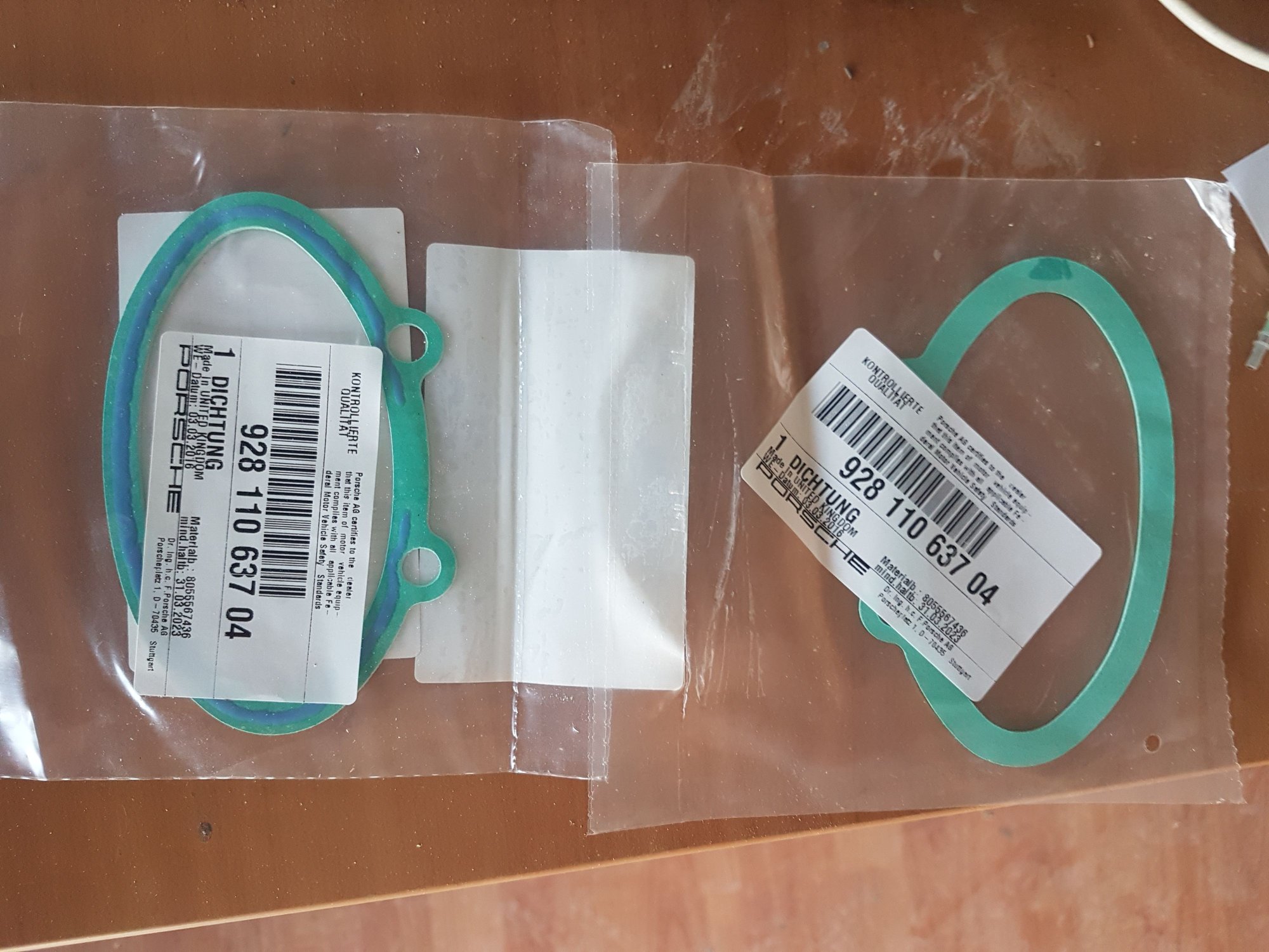

Hi, i have searched and read 928 oc guide and dwayne garage extensive intake refresh guide. Very useful. Now questions :
1 :intake gaskets must be positioned with a particular sealant, or no sealant?
2 blue oval gaskets : one side is yet covered with a blue sealant, the other side isn't. Which side of manifold is supposed to face The side with sealant?
3 have i to put some sealant on those blue oval gaskets?
My car is a '92 gts...
Thank you.
Francesco from italy

This picture showing a pre sealed side and the other one, no sealant.

No sealant on intake gaskets.
It's too long since last intake refresh for me to remember about the throttle body gaskets - I don't even recall whether in my case one side had sealant on it!

blue side goes to the main intake., not the frog/throttle body side

No sealant on any intake gaskets. My gaskets had the blue stuff when they arrived but I think it is just a positioning aid and IIRC the old ones had it toward the intake. I'm sure someone here will pop in with the official answer but if not I will check my garage tablet for the disassembly photos and repost. My car is a 91 S4 auto.
