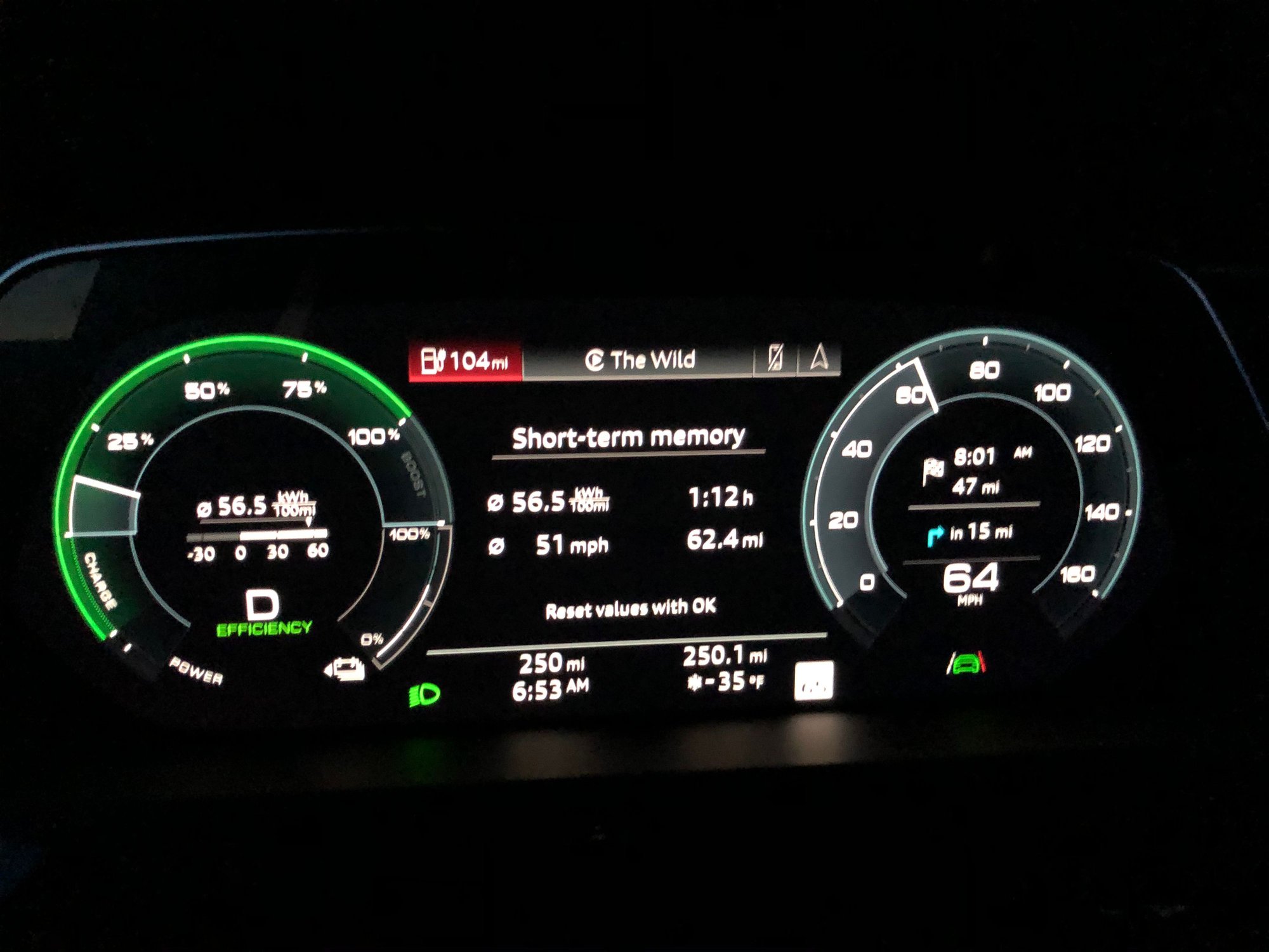

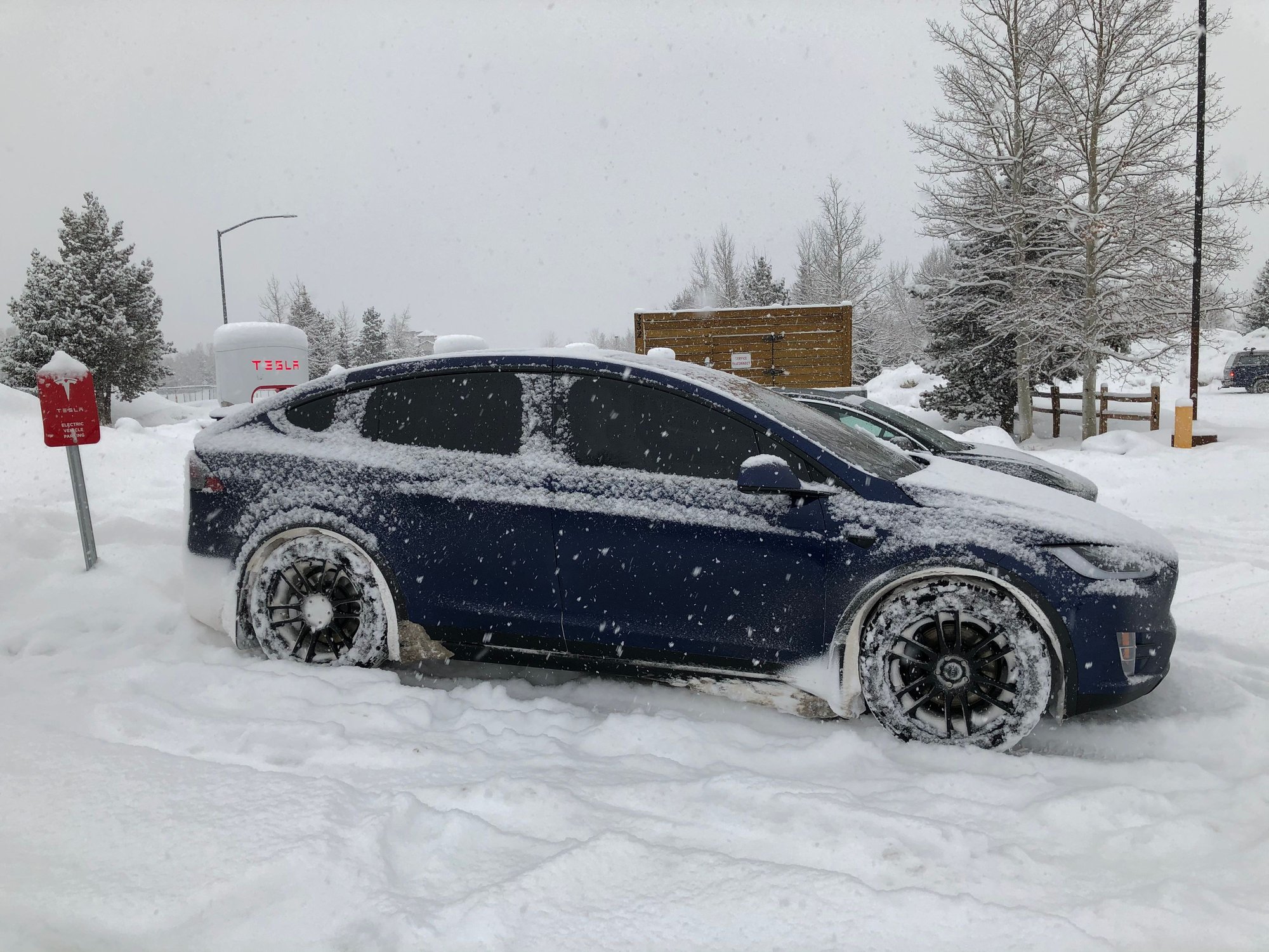

I have regularly driven numerous EV's (Tesla Model X, Audi E-tron and Taycan Turbo S) in sub zero temperatures. The Audi and the Taycan see about a 15-20% hit when below zero. The Tesla was closer to 25%. The Tesla was worse because it didn't have thermally insulated glass.
Consumption was high in the picture because we had climbed from 6300ft to 10,000ft on our way to Copper Mountain. Round trip from Manitou Springs to Copper Mountain is about 250 miles. We have been doing this trip in freezing temps for several years with EV's. A quick top off in Frisco (15-25%) is plenty to make the journey. I've also done this trip in blizzards without a significant hit to range.
