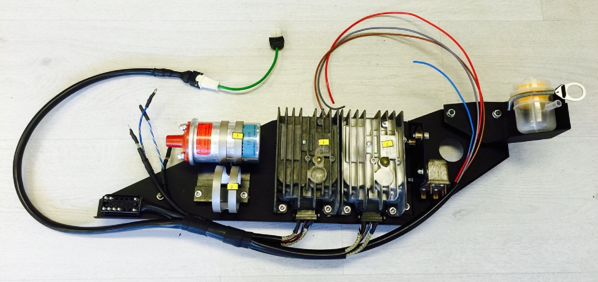

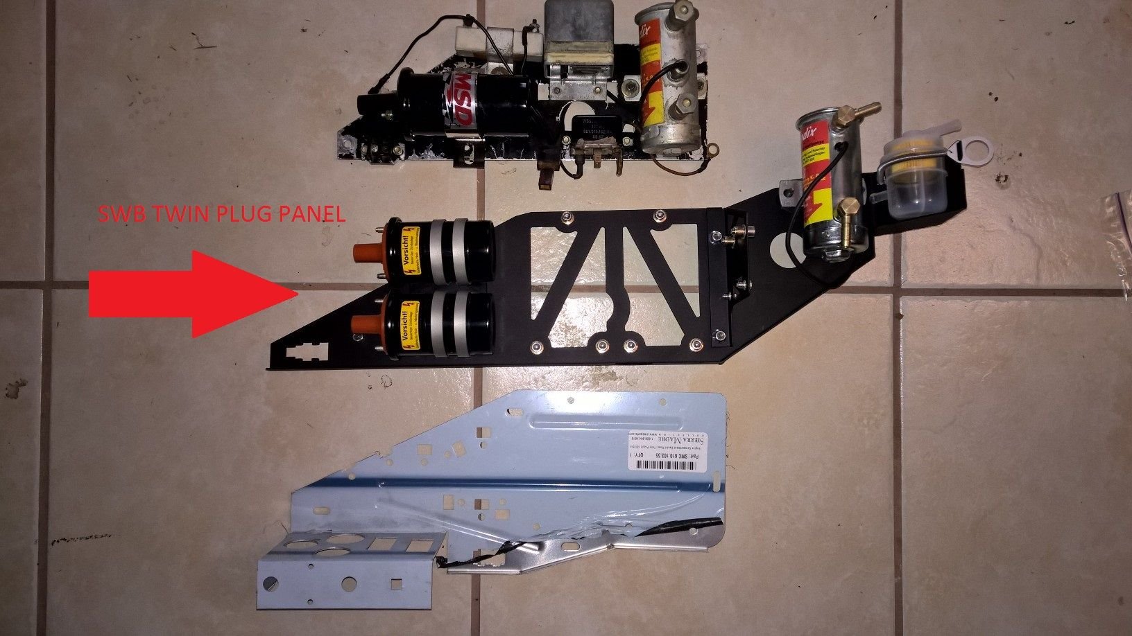

Talking My Twin Plug Project - Update
It's been awhile, ahem , since I've last posted (2002). Some pics to share, almost there...
Aaron Burnham creation...once unobtanium...
6 more holes in 69S Spec Engine! Going to run with Webers...
Custom panel for SWB side by side SWB & LWB Twin plug panels
Jim Tidwell Custom Panel w/ Kroon Custom Harness
Twin 14 Pin Harness, by Kroon.
Hopefully the last few steps won't take 13 more years!!!
