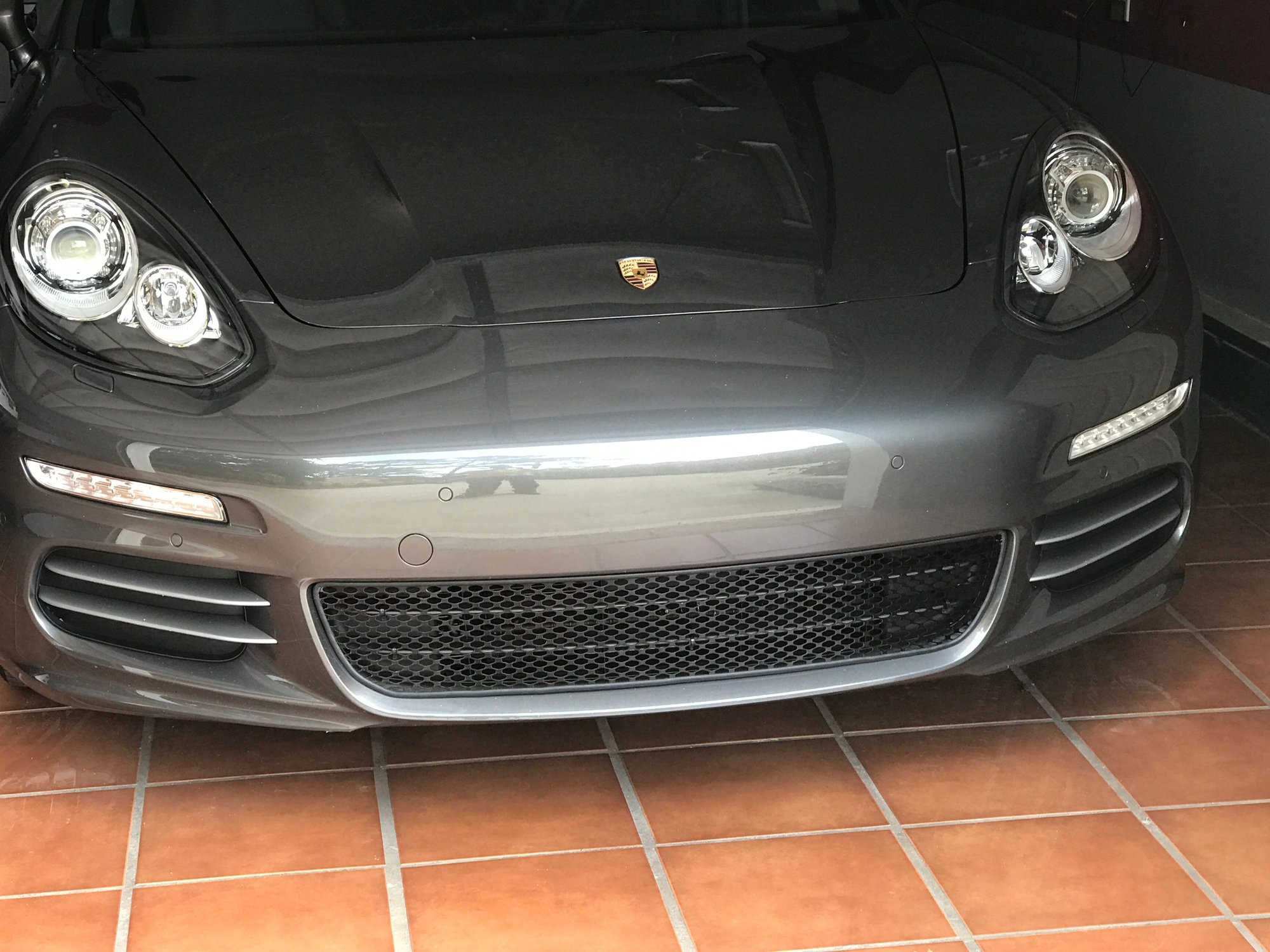

picture before and after will post video of installation step by step tomorrow
project cost 65$ and 2h of installation.

moved my mash grill from outside to inside of the bumper picture before and after

To put the mesh grill on the inside, you have to remove the front bumper. From there you can remove the two plastic pieces on both sides of the bumper. They are held in by some clips. After you remove the two plastic pieces you should be able to place the mesh grill on the bumper. Then simply put back the two plastic pieces. When you put these pieces back they should be holding the mesh grill against the bumper. From there I put a couple of zip ties to make sure it is stable and doesn't move around when driving. Hope this helps. Let me know if you have any questions.
