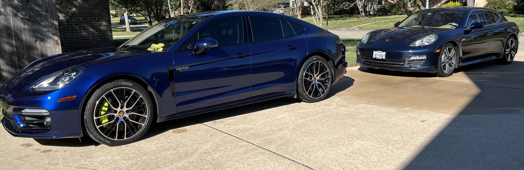

I just purchased a very slightly used 2023 Panamera 4S E Hybrid to replace my 2011 Panamera S. Both are great cars.

beautiful blue. How do you like to hybrid pick up and power?
