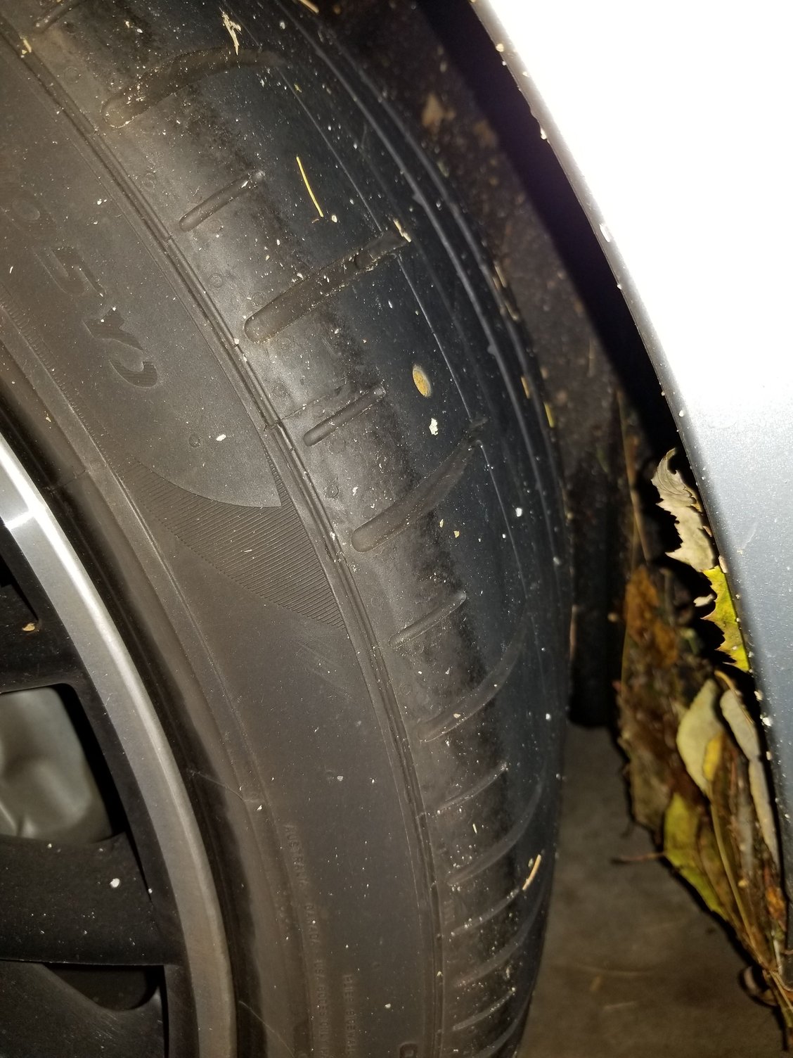

Funny enough - I was just about to get tire/rim insurance this weekend and just picked up this nail this morning. Can anyone tell if it's repairable? Ie: is it in the sidewall or in the tread? Seems to be right on the line.

No. Too close to sidewall.

Figured. Thank you for checking! Any specific place to get these tires? Seems pricey everywhere

tire looks bald to me maybe just a pic.

The car has just 3k miles on it.. Probably just a bad picture

I've had punctures like this plugged and backed internally, it works but I wouldn't do any high speed hustling. Strongly recommend an internal inspection to make certain there's no tears or separation.

Maybe. What does the tire shop say?
I've had nails like that patched. It's possible.

The tire shop didn't want to do it.. I got a replacement, getting it installed today.
