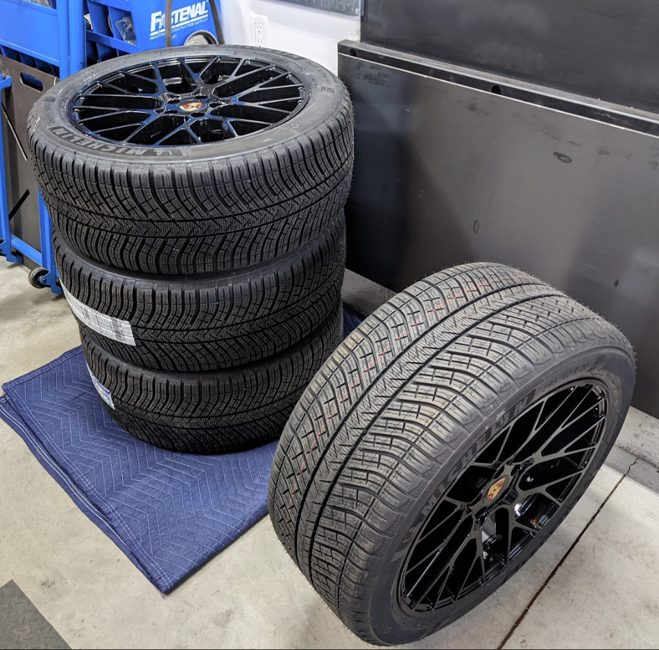

I'm running OE size 20" RS Spyder replicas, 265's front, 295's rear with Michelin Pilot Alpin 5 SUV. Also in Canada, it's been a great setup, but where I am we're more often cold bare/wet pave than snow covered and so I didn't want to give up performance in those conditions...they drive more closely to the summer setup (OE Latitute Sport 3's) than anything.
Deep/often snow, the 235 with 19's and going to an XIce less performance more wintery tire might be a not bad idea. Though I don't feel like I lack any traction in snow on the Alpin's compared to the Latitude XIce Xi2's on another one of our AWD SUV's.

I have the same 20" RS Spyder as pictured above for our 2022 GTS. They work great and look great. Bought them from Porsche and persuaded dealer to give me a pretty good 20% discount on them since we bought the car from them. I have seen some sets of OEM winter wheel/tires on Ebay at better pricing than dealer full price.
I have the same setup but with the prior gen PA4 tires. Highly recommended and you want to go with a staggered setup not square. If there is lots of deep snow probably better to go with the Xice option.
If you're looking for a set try CEO Tire in Scarborough. I ordered the same setup for my sister's new Macan GTS with PA5s and she is very happy as they look great + OEM. Best price in the GTA and their service is great.
