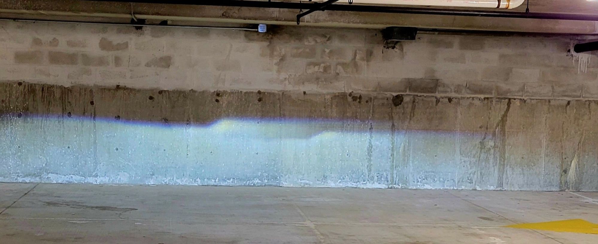

Old May 18, 2023 | 06:15 PM
bretttlang's Avatar
bretttlang
2nd Gear
Joined: May 2023
Posts: 2
Originally Posted by VAGfan
Try it...first put a small dot on the screw, with a sharpie, so that you can return the screw to its original position.
I asked at the dealership and they tell me this is standard for a German car to have the drivers side lower for oncoming drivers and the passenger side higher to illuminate signs, but I've never experienced such a prominent dip.
I used the dot method this morning and adjusted the left/right but i haven't been able to get rid of this V on the drivers side.
Old May 18, 2023 | 06:47 PM
ilovemaui's Avatar
ilovemaui
Joined: Apr 2019
Posts: 852
Likes: 332
From: Dunnellon, Florida
I believe the V is to reduce the light into the incoming vehicle as not to blind them.
Old May 19, 2023 | 09:49 PM
jbx2's Avatar
jbx2
Joined: May 2010
Posts: 161
Likes: 56
From: Pennsylvania
That's the cut off line = normal
