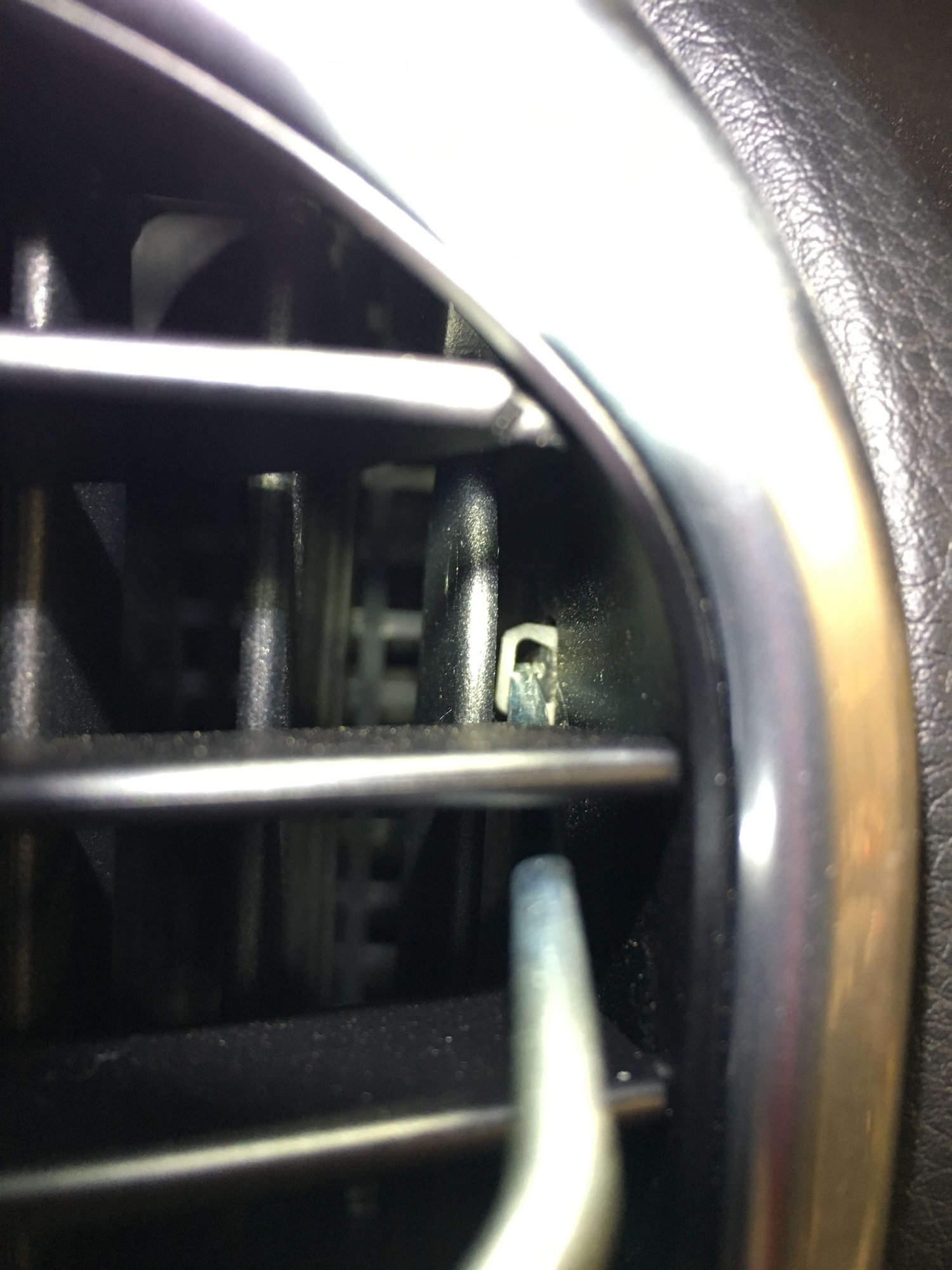

Is it really that bad, taking the vents trims?
Not at all, ive done it probably a dozen times since i bought the car. Small but longish flat head, do the bottom inner clips first while pulling on the bottom of the vent. My passenger side vent comes out completely with just that one clip undone, my driverside needs the out bottom clip as well but then it just pops out.
It's not too bad if you take your time. Get a set of these cheap stereo tools:
Amazon Amazon
And then it's pretty easy:
