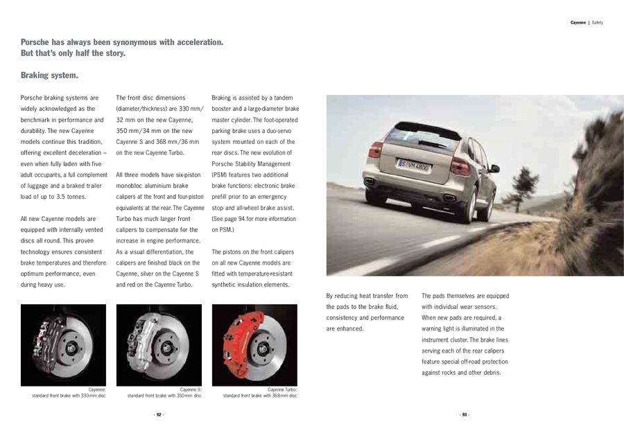

I did all of my homework, yet still coming up short. Having a VERY hard time find a good set of ceramic brake pads for MY08 Cayenne Turbo due to the upgraded stock brakes on this MY.
I wanted to go with Hawk, whereas they list 2 different pad numbers as compatible. However, both were not compatible
Of the two threads I found that were related, both people aborted their search and put on the much more expensive / non-ceramic OEM pads. Stock Part # 955.351.939.62 .
I have a new set of stainless steel brake lines, Castrol SRF brake fluid, and a Motive Brake Flush System just waiting for this to get sorted out.
Does anyone know if any good options (besides OEM) for the 368mm rotors standards on the 08-10 Cayenne Turbos?
Note: These are the bottom-mount pads for the red calipers. Minimum 18" wheel clearance.
Update: Aftermarket pads are available from EBC and Carbotech. Part numbers can be found here for all options found in US.
Correct Pad Shape - 368mm
368mm Rotor and Caliper

2009-10 Turbos have different brakes than the 2008. In 2009, they adopted the brakes from the 2008 Turbo Power Kit as standard. This may be the key to your fitment issue. I'll look around and see if I can find a correct set of pads.

Great. Thanks for the help. I didn't know the MY09-10 got the 380mm Turbo S brakes. I thought the only appreciable difference from the MY08 was the newer PCM version.
If it helps, they have also resumed using this caliper in the Panamera. I believe both the Turbo and GTS are using the calipers.
