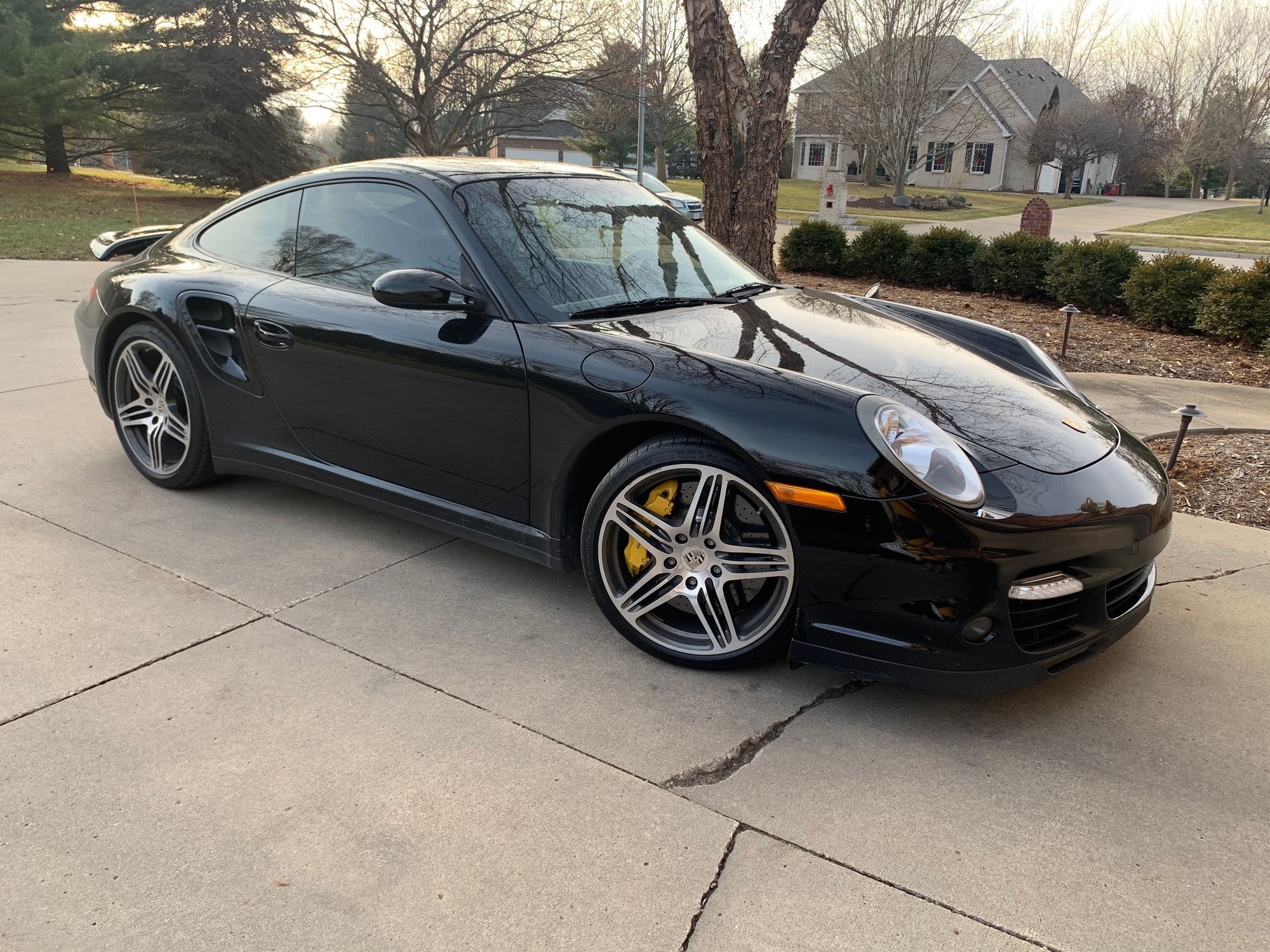

Hi guys! I bought a clapped-out 997 turbo as my summer project while home from undergrad while I prepare to move on to medical school that needs a rebuild or an engine swap. The goal is to get the car back running which is going to take some work. It has metal in the oil but not a lot, but the cylinders look great and everything looks great, but only taking down the engine completely will say for sure, I have never worked on cars before, and id like to learn on rebuilding this care. Im not a super-smart guy but I am persistent and stubborn which is why I think I can handle the job. What are my engine options? I can always do a 3.6 Mezger from another turbo but I am curious what other motors can work? Is there a specific motor that can be swapped and have the best reliability? is $17,000 too much for a Mezger turbo with under 50K miles? Let me know if you guys have any ideas
Here she is, and she's got good bones!
sure appreciate the help fixing the car up mint!

You are about to go to Med school, you scored a clean looking 997 Turbo for what I have to guess was a song, since you called it a summer project. And the neighborhood in the background looks pretty swanky. From what I can see, you appear plenty smart. I'd pull the engine and get to work. You tube is your friend. You'll have a beautiful car to commute to school in &/or probably flip it for a hefty profit if it's otherwise in good shape.
