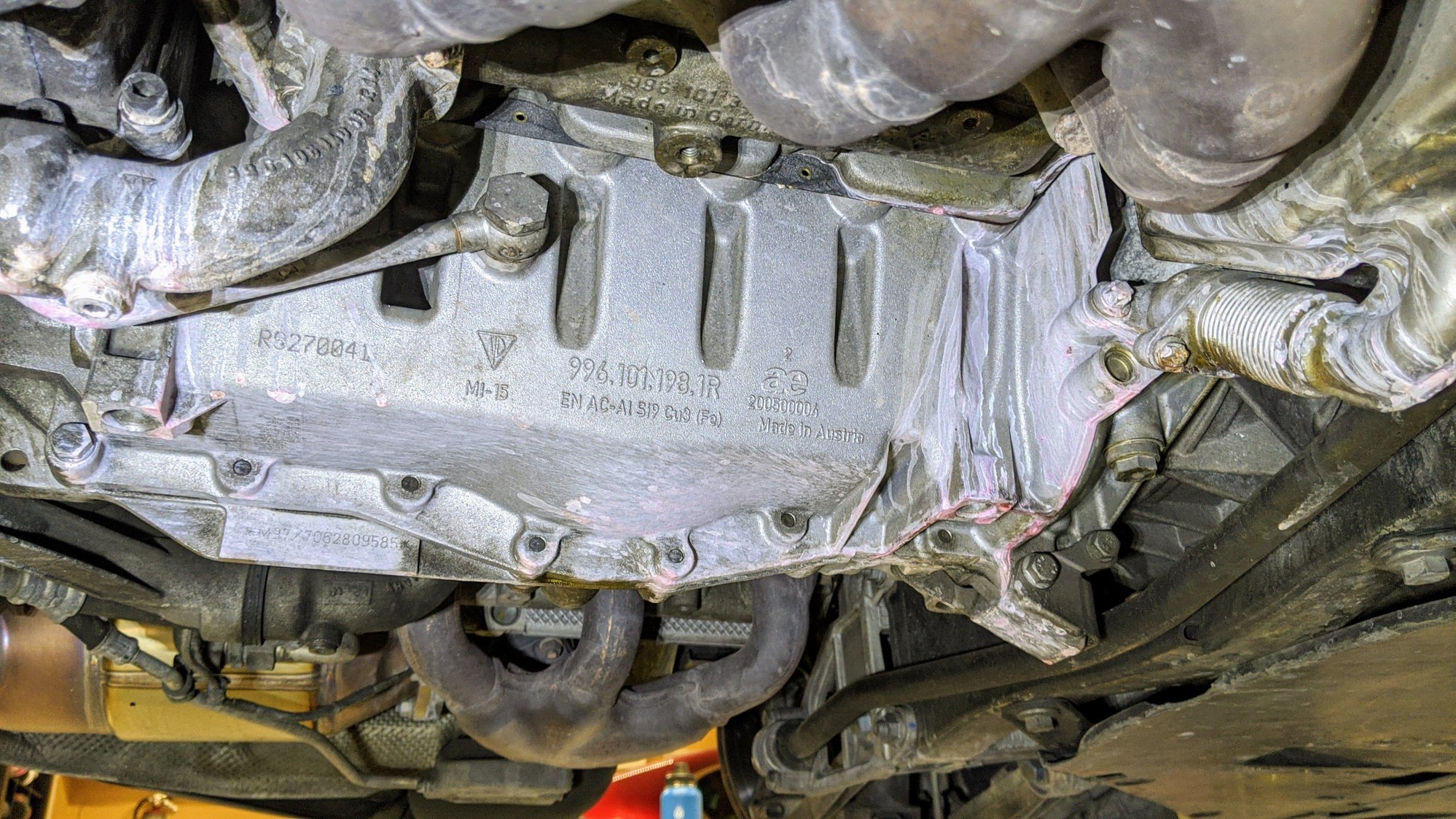

Engine out and parts have been ordered.
All the coolant lines are in great shape 85,000 miles.
Elbow broke off on removal.
Will follow Ed's (lliejk) lead on the master parts list he generated. thanks for the homework.
And a special thanks to Alex (jeebus31) for supporting me through this project. We shared the cost of the timing tool.
After a drive 2 weeks ago, could smell coolant
Plastic on rubber with hose clamp crime
As she sits now

Man you stripped that motor in record time! Time to make it better than ever.

Very typical area. I believe movement exists in that particular return line. Here is mine.
a nightmare when it does happen to you! You can be sure it will no doubt about it! You are saving a ton of cash and getting to know your car. It’s the best feeling of all. I can tackle anything this car throws at me. Ain’t worried about anything. My repair was done in 2016.

After you get all that fixed, then it’s the front hoses to the radiators. They employ “O” rings that develop flat spots. When the car cycles thru it’s heat/cold, expansion and abridgment. Misting of coolant will be noticed up front specifically drivers front wheel-well area. One way to test it when car is cool, squeeze the lower and upper hoses to radiators. Mine both leaked. Passengers side are fine for the moment. Good luck and have fun!
