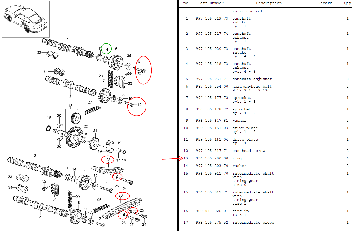

Need a bank 1 intake cam. Part number I was given is 997 209 73.
Would like to fine one domestically if possible.
Is that the correct (current) part number for that cam?
Are spun cams generally replaced or repaired? What's involved in the repair?

Mine were corrected at a friend with a machine shop

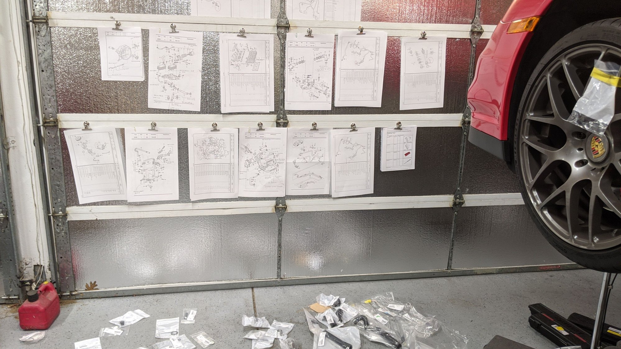

You guys are amazing. Watching those videos gives me anxiety. I would never remember where to put everything back. For goodness sake, I have some mechanical skills but I can't even get the lift in my garage to work right. HA
Old Jan 15, 2021 | 06:44 PM
  #80
jeebus31's Avatar
jeebus31
Joined: Oct 2017
Posts: 1,321
Likes: 436
From: HTX
I tagged every hose and took tons of photos/videos to help with reassembly, and got really familiar with the parts catalog. Once you get the lift working, you can get this done as well!
