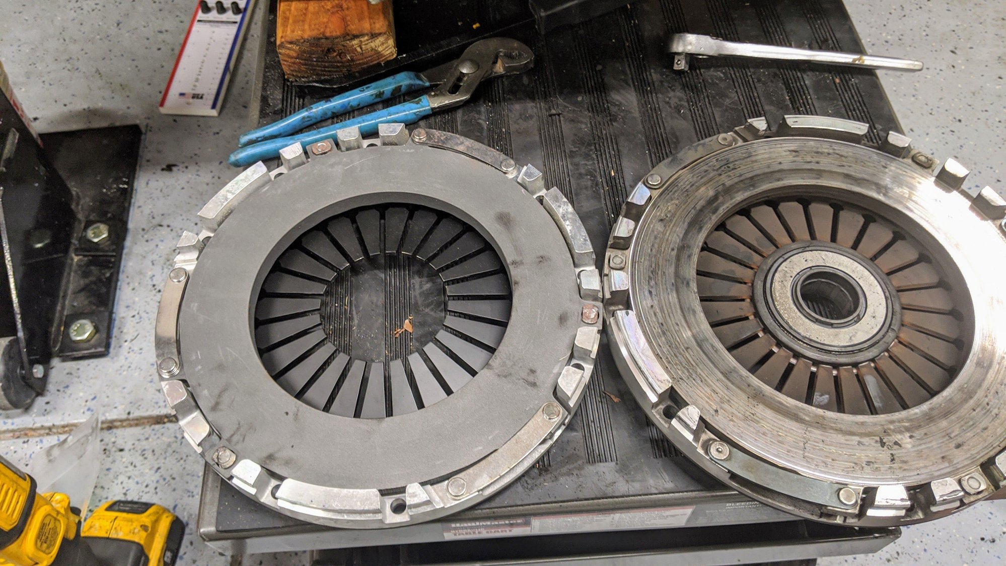

new disc has no springs
RMS looks good perhaps an aftermarket seal?

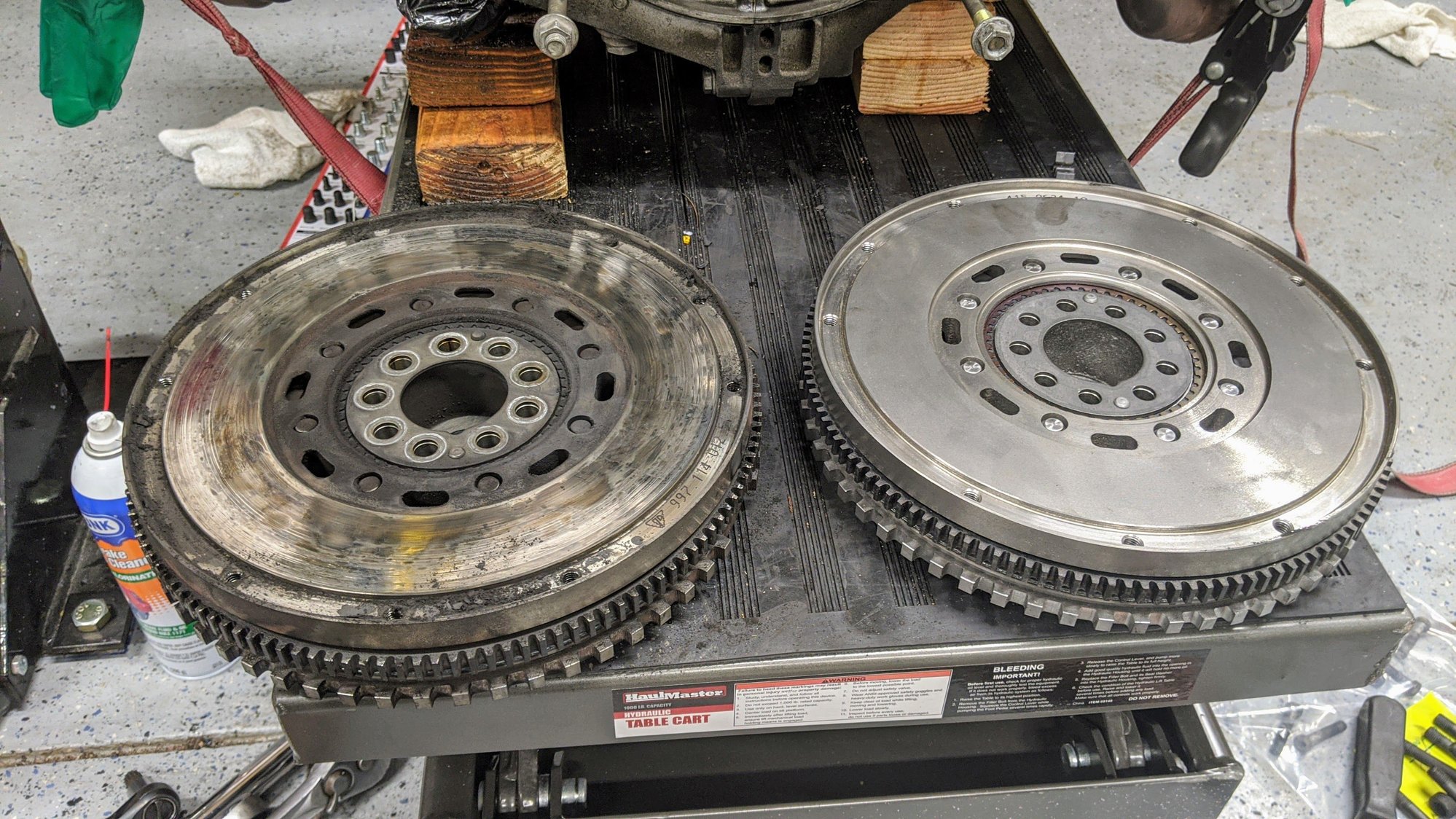

Nice & shiny! You did a much better job cleaning up those housings for the coolant pipes than I did.
I am curious about springs vs. no springs. That normally means SMFW vs. DMFW. Did the flywheel change? They both "look" like Dual Mass flywheels, but I can't quite make out the part number on the old one. Only reason I ask is that normally, for a DMFW, you do not have springs on the friction disk. I wonder what the clutch felt like engaging?

The new one is also a DMFW, the new clutch disc has no springs.
Seems like the stock setup is springs on both.

That lift table is awesome. I see you did the Atcbi5 modification to it.😂😂

Yes, thanks for all support across all these threads one heck of a job.So many o-rings, hoses and torque values to track down.
having the second cart made it easy do replace the clutch.

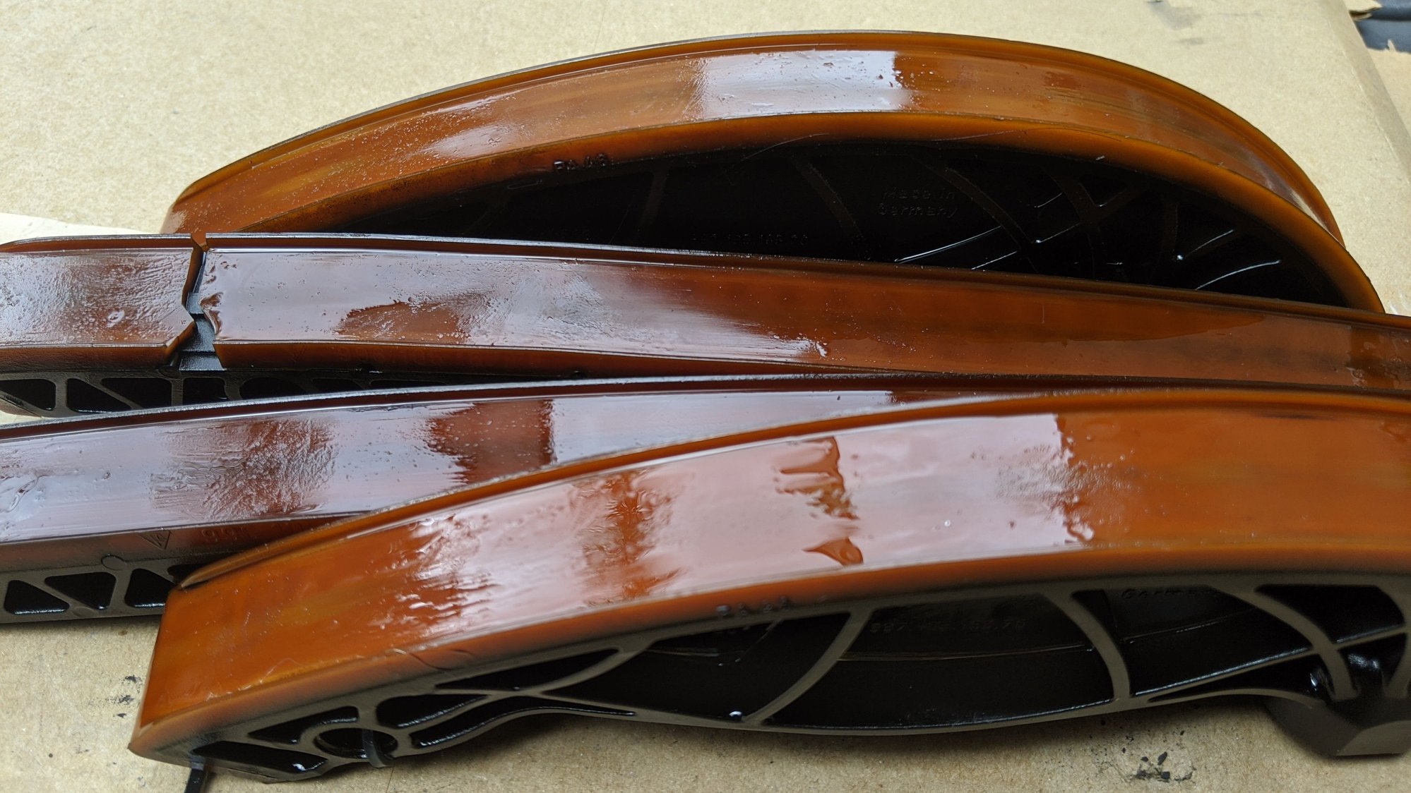

Update been quiet and dealing with the cam issue and some parts I missed..
Got new cam rings ordered and front chain guides.

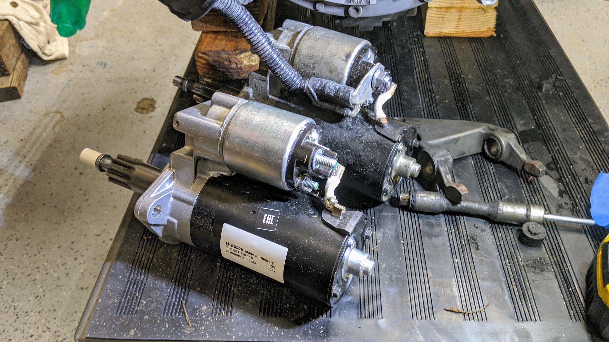

Took a few tries to get the oil pressure up before installing the fuel pump fuses.
New starter sounds like a 3rd turbo.
​​​​​​​took a few weeks longer than planed but happy at 5 weeks part time.

25. replace (2) chain tensioner springs
