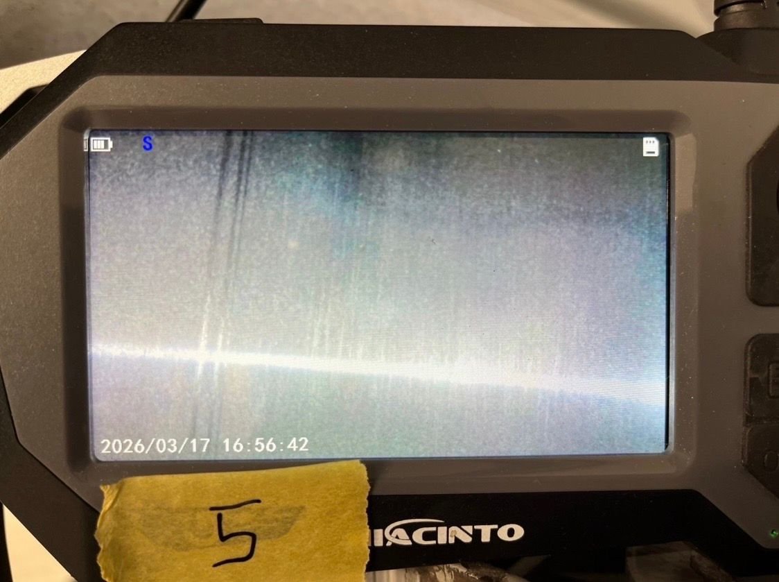

I live in Japan, and I found a 2004 997.1 C2S in manual with 38,XXXkms. Car has maintenance records from Porsche, full aero kit, Sport Chrono, and a sunroof. It was the first one I looked at,
but I DID look at others...and I simply ended back where I started.
I asked for a borescope before purchase, and I still have not sent funds. The results are in:
- Cylinders 1, 2, and 3 present nothing noteworthy.
- Cylinders 4, 5, and 6 present as follows:
Those two streaks in 5 and 6 are the worst of it.
I now call on the collective power of the 997 Owners that frequent this thread: what say ye?

There are a number of pros over on the “Porsche Engine Gurus” FB group. Have you tried posting there?

In my humble opinion having seen many a score .... The concern is not really the two lines but the very early sign of scoring on the second Pic to the right . The fact of the matter is most of our cars have some extent of this and with propper oil changes and start up procedures can mitigate this inevitable for quite sometime . This is the one thing that really enrages me with the brand , that it took decades to finally resolve this defect thru many generations and models and they never took full ownership of it . Shame on Porsche.

IMO the heavy marks on #5 & #6 are concerning with only 38,000 KM's or 23,600 miles. However many Bore Scoring issues happen when the engine has less than 60K miles and not surprised it's a 3.8L "S" engine.
You didn't follow your homework and shop for a 3.6L ....Just kidding but will **** off the anti-BSI peeps
If it were me I'd find another example. This scoring is only going to get worse
Thats why it's important to get a BSI performed on the 997 engine. It's a bummer scoring happens and imagine paying today's prices for a scored engine
....I've mentioned it many times but shopping for a higher mileage 997 example (70K-110Kmiles) that has little to normal cylinder "streaking" is smart shopping. Why deal with owning a top dollar low mileage/scored engine when it will only get worse and have poor resale value??

Not a big deal here

Pulling on your experience with 15 borescope'd 997s, how 'bad' would you rate this?
Knowing that most cars can 'live with it' with a proper engine warm-up, the right motor oil, and changing the oil at earlier intervals than suggested by Porsche (and using your gambling metaphor) what are the odds the pictured 'scoring' becomes a serious issue?
Car is ~$55k, I have still been running searches for 2004-2009 911s in MT just about daily, to include this morning. For Japan, nothing else comes close in terms of price and MT. The disparity here is real: it's mostly GT3s for sale...

Hate bursting your bubble but selling that car when the time comes will be a bitch. Scoring is only going to get worse.

I've sent the images to some shops to ask them what they think. I'm of the mind that there are a ton of people that have scoring, do not know it, do not take care of their cars, and are STILL enjoying them...but I am paranoid in general so I wanted to get other opinions.

I believe the 997.1 (and earlier water cooled) non Mezger motor cars can bore score. I do support you on borescope there.
100% - I'd never buy a 997.1 without Bore Scope Inspection and I should have made that clear in my above posts and will correct it.
Meanwhile the 9A1 motor may score, but the primary failure there is more likely to be cold seizure (easily mistaken as bore score and possibly prevented with proper warm up procedures).
Streaking is another topic, and I'll leave it at that (refer to Slakker and their findings regarding the reliability of photos)
From my observtions/readings on this and various other Porsche Forums/Chat sites, cylinder streaking is normal cylinder wear.
