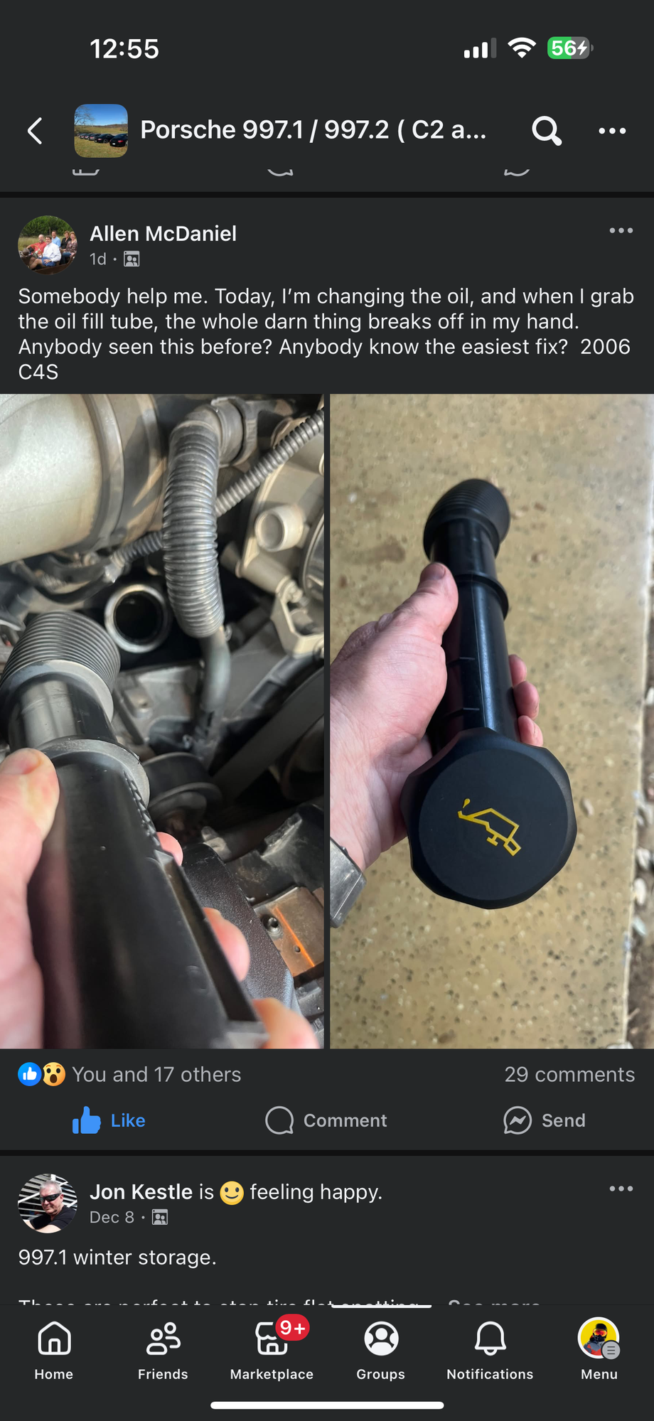

I would say it would be equally appreciated. For example. This person on the fb group literally just had his snap. Mine will likely snap at some point . When i tried unscrewing the cap, just the cap, to replace it with a new metal cap, the plastic brace/stand broke off. Which means the plastic tubing that connects to engine is basically done. Make a permanent fix for this and you have yourself an item you can sell.
There is already an excellent aftermarket oil tube replacement "The Antidote" made by Chris and his website is here: https://9ii.pro/
Also
https://lnengineering.com/9ii-the-an...ller-tube.html
https://lnengineering.com/9ii-the-an...-for-uaos.html
