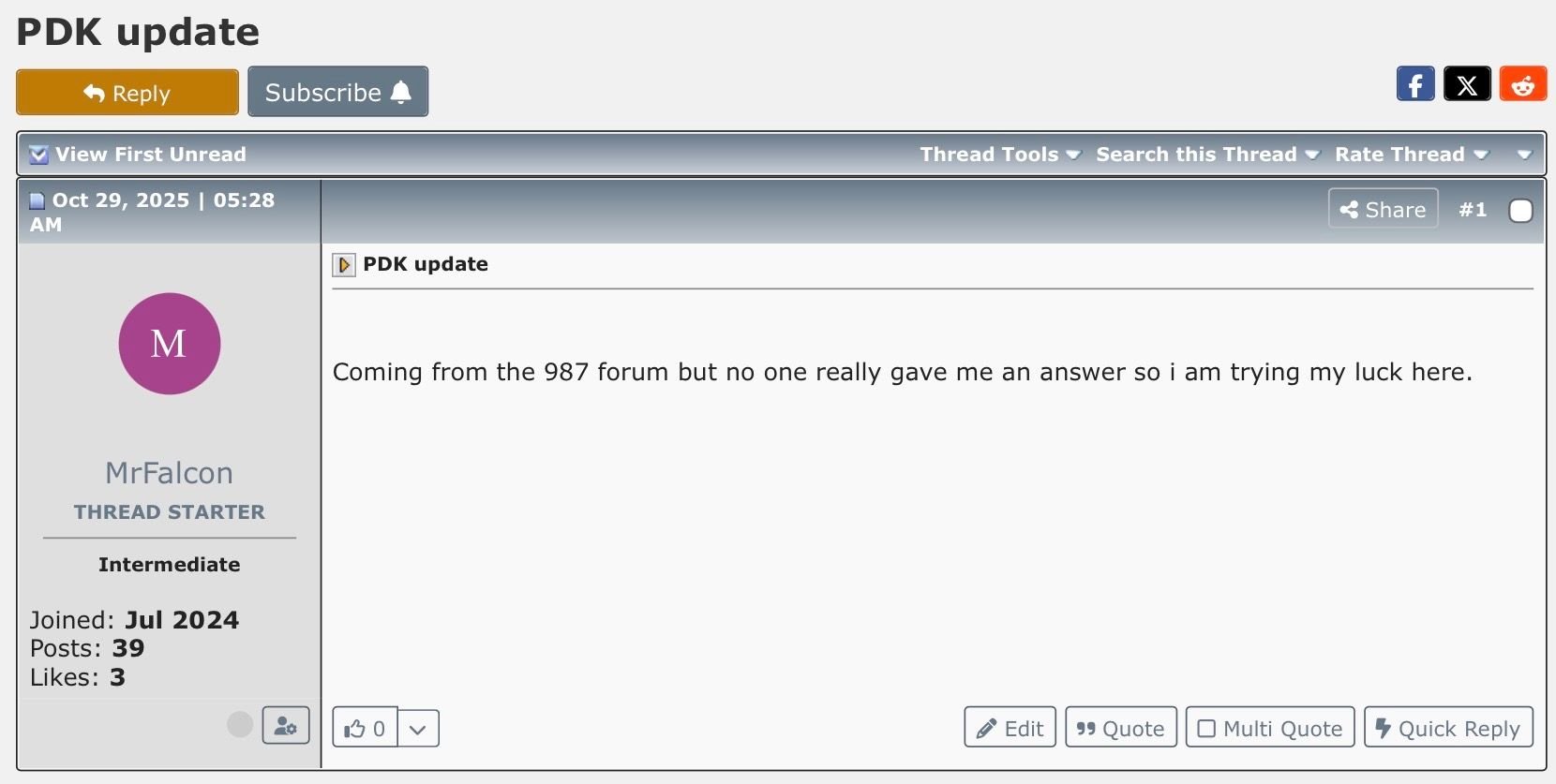

Originally Posted by MrFalcon
I dont understand?
This is a screen grab of your original post. Only one sentence is readable.

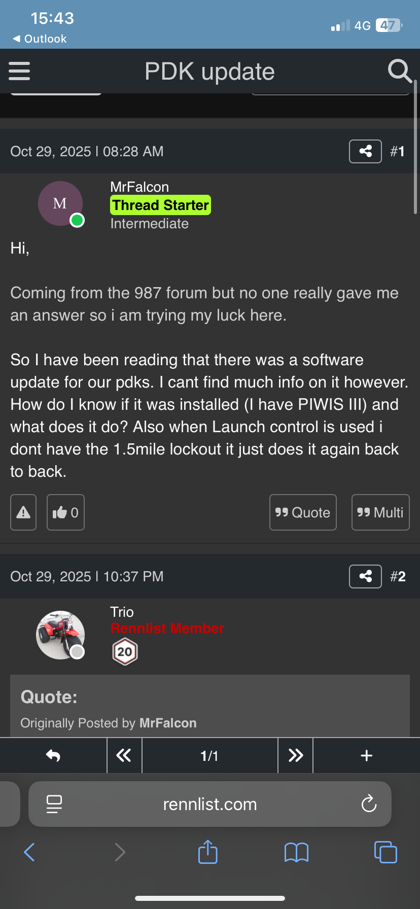

Oh bruh thats wierd. Well this is what it says for me:
Old Oct 31, 2025 | 11:44 AM
