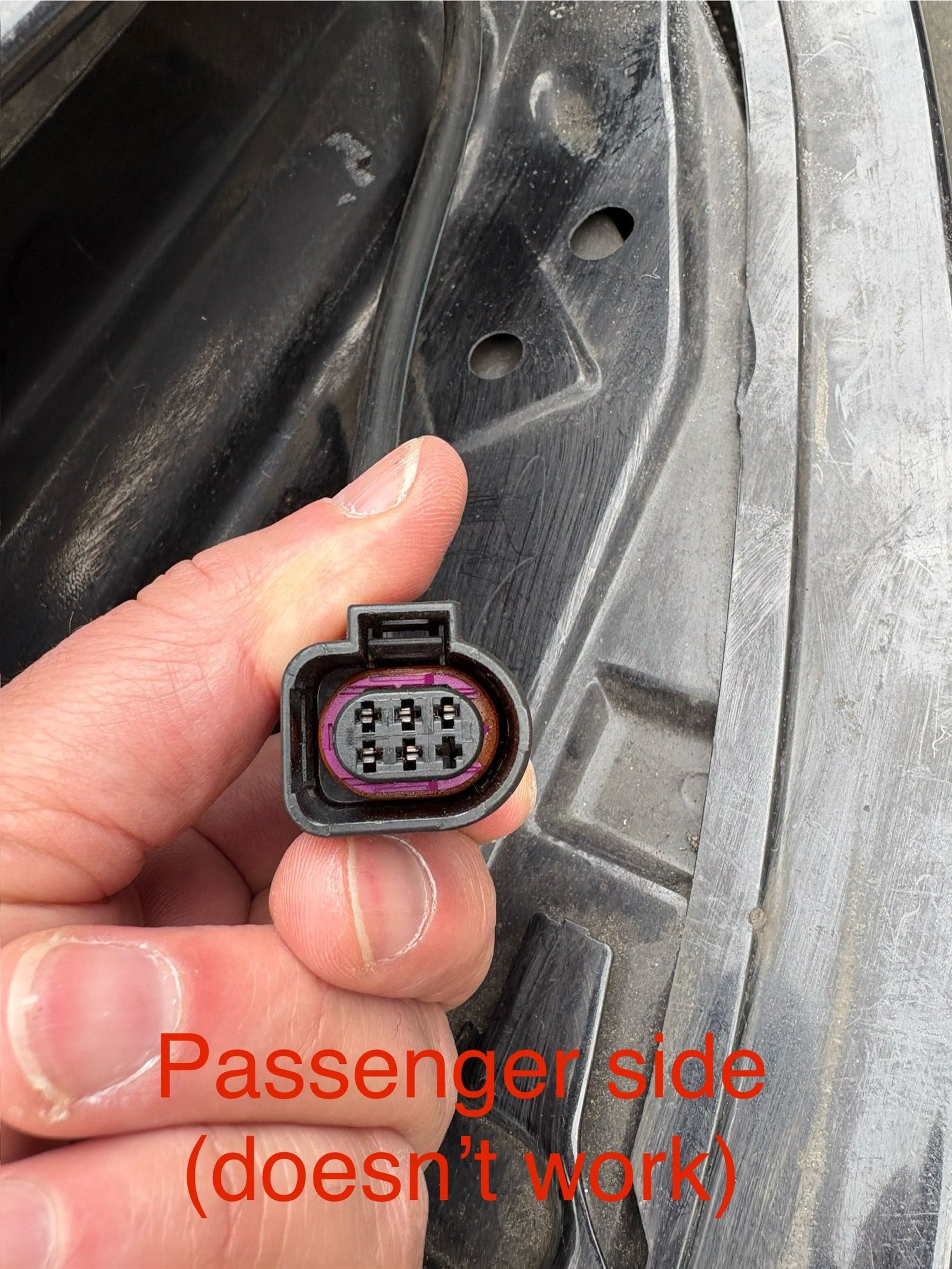

For the pigtail connector, I noticed that the passenger side only has 5 wires, thus 5 pins in the 6 holes. I believe this is due to passenger side not having the fog light wire, but if you believe a 6th pin is crucial, then I’ll install a new one when it arrives this week. See pics below.
I’ll also use the new wire harness that arrives this week because that will give me a chance to ensure that wires/LED bulbs are configured correctly, though I’m not sure how the previous owner could have messed that up.
​​​​​​​Rear fog light is only on driver's side and why the wire difference

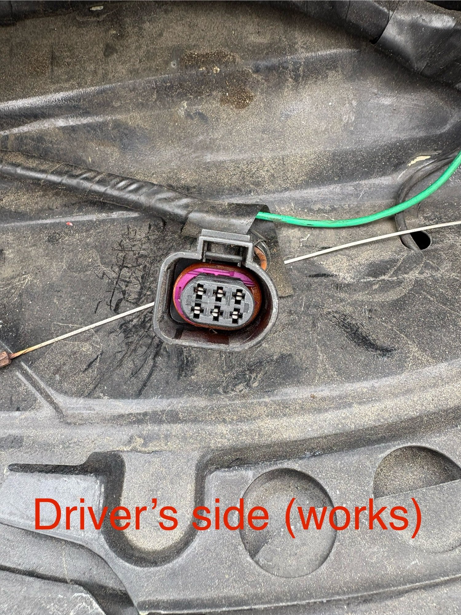

-Replace the pigtail connector that Petza914! referred to with a new one (see pic below). I don’t love this idea because I need to splice into the wires in the vehicle. That said, even tweezers (let alone needle nose pliers) were too big to get into the holes on the existing pigtail connector to ensure all were extended properly.
If I replace the pigtail connector and it doesn’t resolve the issue, I assume the problem is further up the line (and above my pay grade).There is something called a Turn Signal Flasher Lamp Blinker Module Control Unit (99761820100) that I probably don’t want to mess with.
Before I start splicing in this new pigtail connectors, does anyone have any more ideas? Thank you in advance!

It's the pins on the other side of that connector that gets pushed out and then don't make with the one you pictured properly or completely. However, with 2 different sets of taillights, it's probably not that.
I would do a test where you reinstall the original, non-LED taillights and see if you have the same issue as that will help narrow things down.

Thanks for this. I actually replaced the wire harness yesterday with a brand new one. The wire harness (with the pins) connects the LEDs to that pigtail connector. So, I feel like I narrowed the issue down to upstream of the tail lights and wire harness. I wish I had OEM taillight to test, but I don’t. The brand new Morimoto’s had the same issue—only on the passenger side. I really don’t think it’s the LEDs.
The pigtail connector is likely next. That said, if you or anyone know if the 2008 911 C4S (997.1) has a flasher relay and where that might be, that would be helpful. I don’t see it above the fuse box and I don’t see (or hear) it beneath the VIN plate from the frunk. Is it behind the speedometer/tachometer on a 997.1?
