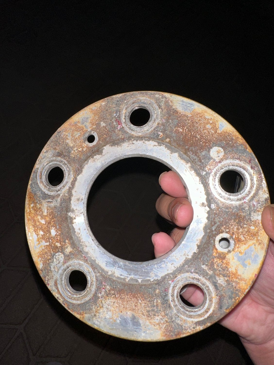

Hi all. Have got a 2007 997 Carrera. Recently I got new tires but they stick out well past the wheel arches. Car was lowered by previous owner thus while going over bumps the tire would run on the body. So I decided to remove the stock “spacer looking things”. Now the car sits well and looks well too but I was curious, are there mechanical implications to this? Also I’m not very mechanically oriented yet so what I have removed may not be the spacer at all lol. Did the 997 come with stock spacers?

5mm spacers came as a factory option on some models, and standard on others (GT).
Attach a picture or I can’t be sure you didn’t remove your hubs. Haha.
All jokes aside- if they look like large washers and are screwed to the hub, yes, those are spacers.
You are unlikely to notice a performance difference.

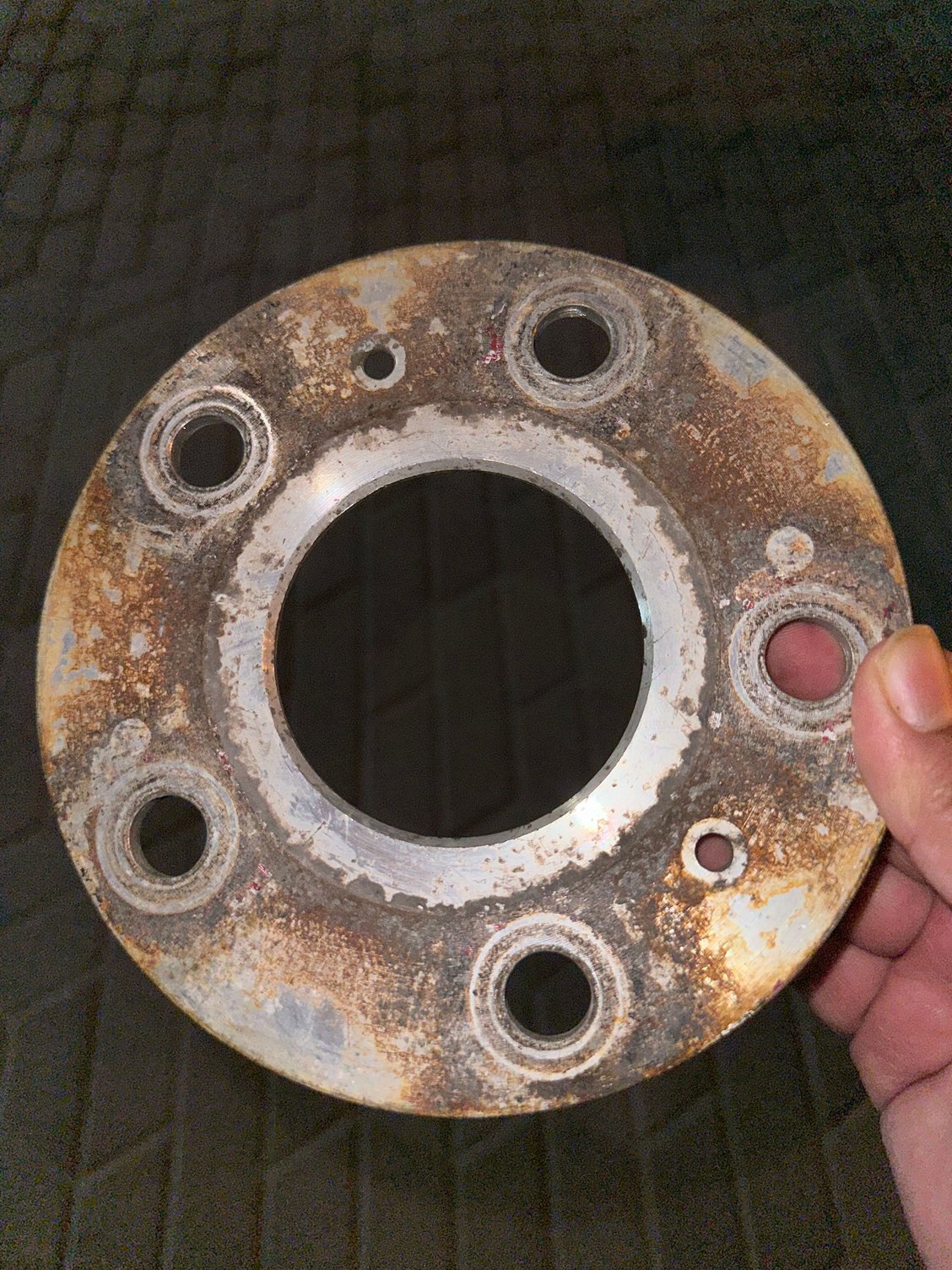

I have attached the photos. Don’t recall them being mounted with screws. They were just…on there lol.

Get rid of those - for one, they're not hub-centric and can cause vibrations, and they're all rusty which may keep them from sitting perfectly flush against the hub or wheel.

Those are the optional from the factory 5mm spacers. Yes, rusty/dirty, but are a factory original part available as an option.
