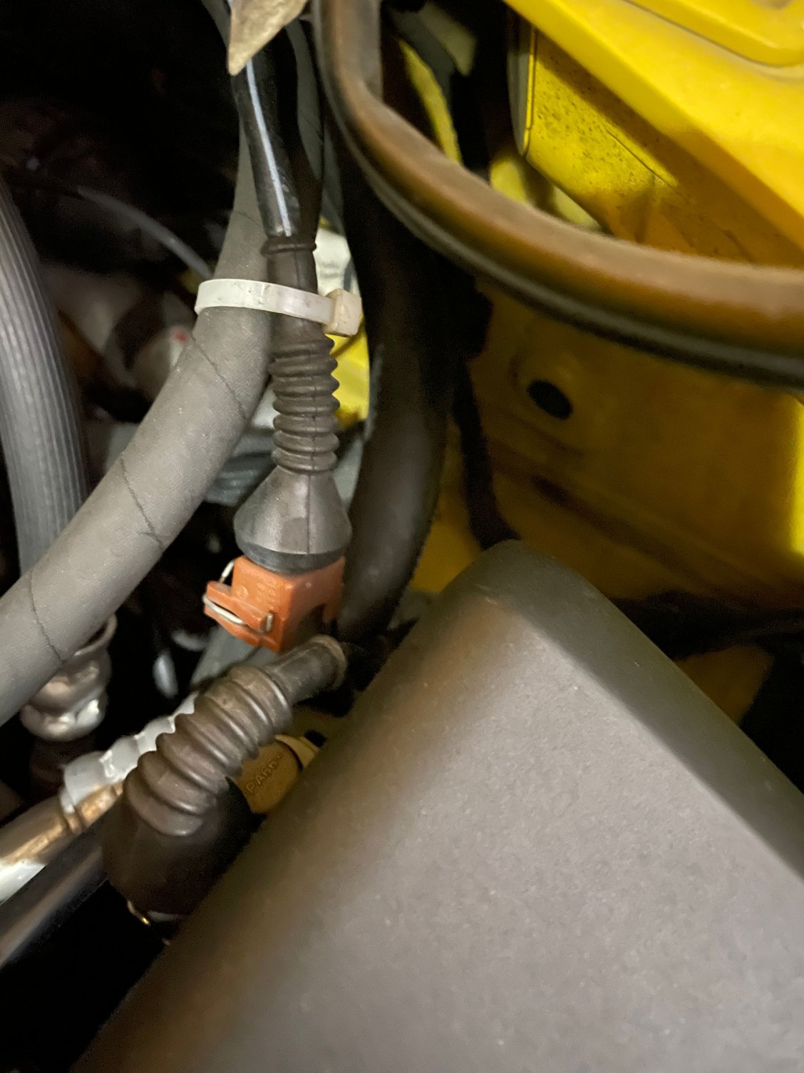

Hello all. It’s been a long time (6 years) since I’ve been in the Porsche game and I have a inquiry about my new to me car. Long story short, I bought a 2007 CS2 Cab in speed yellow. It’s notable features are sport chrono and x51. With this particular combination it is supposed to come with PSE.
After I get the car home and I’m checking it over more closely I find that there is no vacuum lines running to the actuators on the cans. The vacuum line at the upper left of the engine bay has a plug in it and the change over valve is just zip tied to the side of the engine compartment.
My questions are as such:
1. With all of the lines disconnected am I permanently in “loud” mode or “quiet” mode?
2. Can someone post the correct vacuum line routing so that I can reinstate the switchable exhaust functionality?

If the PSE is on all the time you should hear the deep gurgling sound on startup and wonderful sound of deep throat exhaust.
I'd guess with the vacuum lines removed PSE would be "ON" but someone with more knowledge on subject will chime in.

I bought my 06 with PSE in July and the PO also unplugged the PSE cable and zip ties it to another line. Mine is always on.

With no vacuum going to the valves, you're in loud mode all the time. Attached is a PDF showing retrofitting PSE to a non-PSE car whichat have the line routing info in it.

Thank you guys for the quick feedback. I guess that I won’t be doing anything with it since I’m in the PSE always on mode.

It's pretty nice to be able to have control of the mufflers, like when leaving the neighborhood early in the morning or driving next to a cop..All you likely have to do to get yours working is plug the vacuum solenoid in and run two vacuum lines to the muffler valves.
