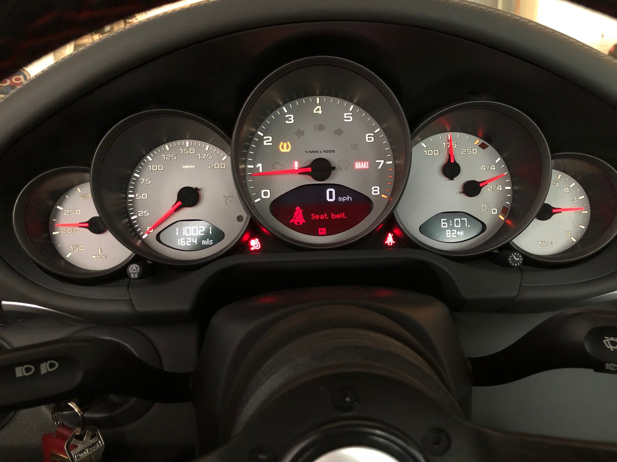

Driving home today I began observing the oil pressure about 15 minutes in on the freeway. Temp was slightly below the hashmark in between 200 and 250. I was in 6th gear coasting about 70’s right below 3k RPM and I found the pressure floating between 4-4.5.
I took my exit and at the first stop light, the idle was around 2-2.5
In my garage idling I watched it again hover around 2’s and weirdly shoot up almost to 4 a couple times. Definitely wasn’t sitting at the .08-1.0 you mention above.
I assume this isn’t “normal”? Car is an 07 S, just passed 110k. Bad sender? or another component related to the pressure system?
Afterward I went to the back and was easily able to unscrew the oil filler cap and remove it. The engine idle got a little rough and I could hear the hissing noise emitting. Placed the cap back on and tightened. Idle went back to smooth and normal and the hiss went away. Seems like the AOS is operating properly.
I have never had any engine lights or oil-related warning messages show up.
The lights on my dash are from dead TPMS sensors, air bag and my side markers up front have white LED bulbs installed.

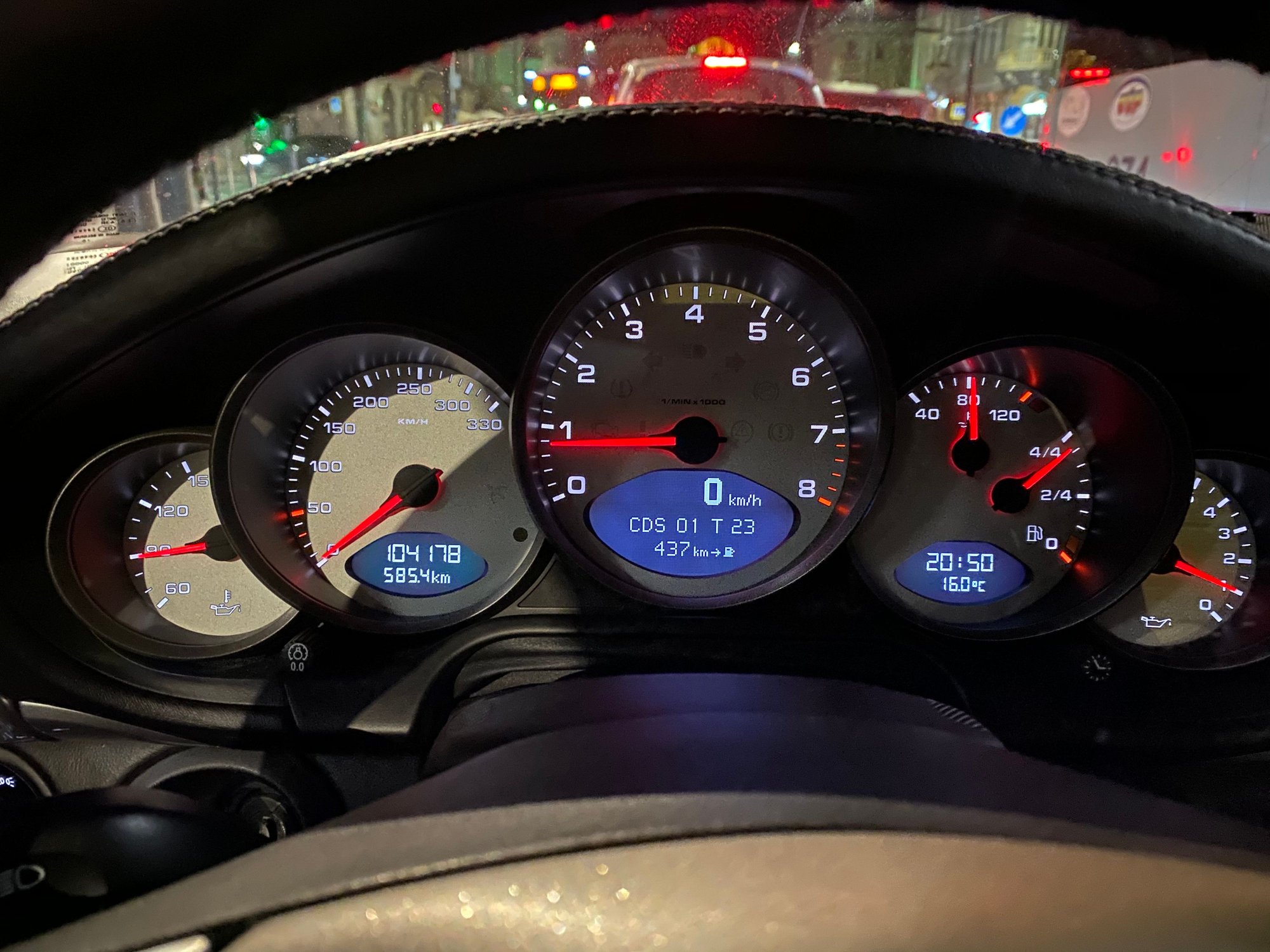

Thank you. Do you think its normal 0.8 - 1.0 at 100 degrees celsius oil at idle ? I saw many pictures of 997.1s where people had 1.5 - 2. I know that an engine doesn't need much pressure at idle, but I would be more comfortable having it higher.

What is considered normal for oil pressure readings? At cold start, warm idle, freeway steady 65mph-70mph etc. I'm just curious.
I get these readings, but I suspect I'm a bit low on oil pressure.
Idle cold : 5 bar
70C (160F) : 2 bar (or a bit higher)
90C (200F) : 1 bar (or just a little bit higher)
100C (210F) : 0.8 bar
I dont know at 110C (220) because weather is colder now and it didn't get that hot. But I believe it will get lower, maybe 0.5 ?
But if I rev it up, pressure builds up quickly. As stated above, it follows the rpm or even higher.
AOS had a small influence on the pressure, not as big as I hoped. I will put a manometer on the oil pressure to see whats real. Gauge can be off too, as the idle shows almost 800 rpm, but my diagnose shows 740 rpm.

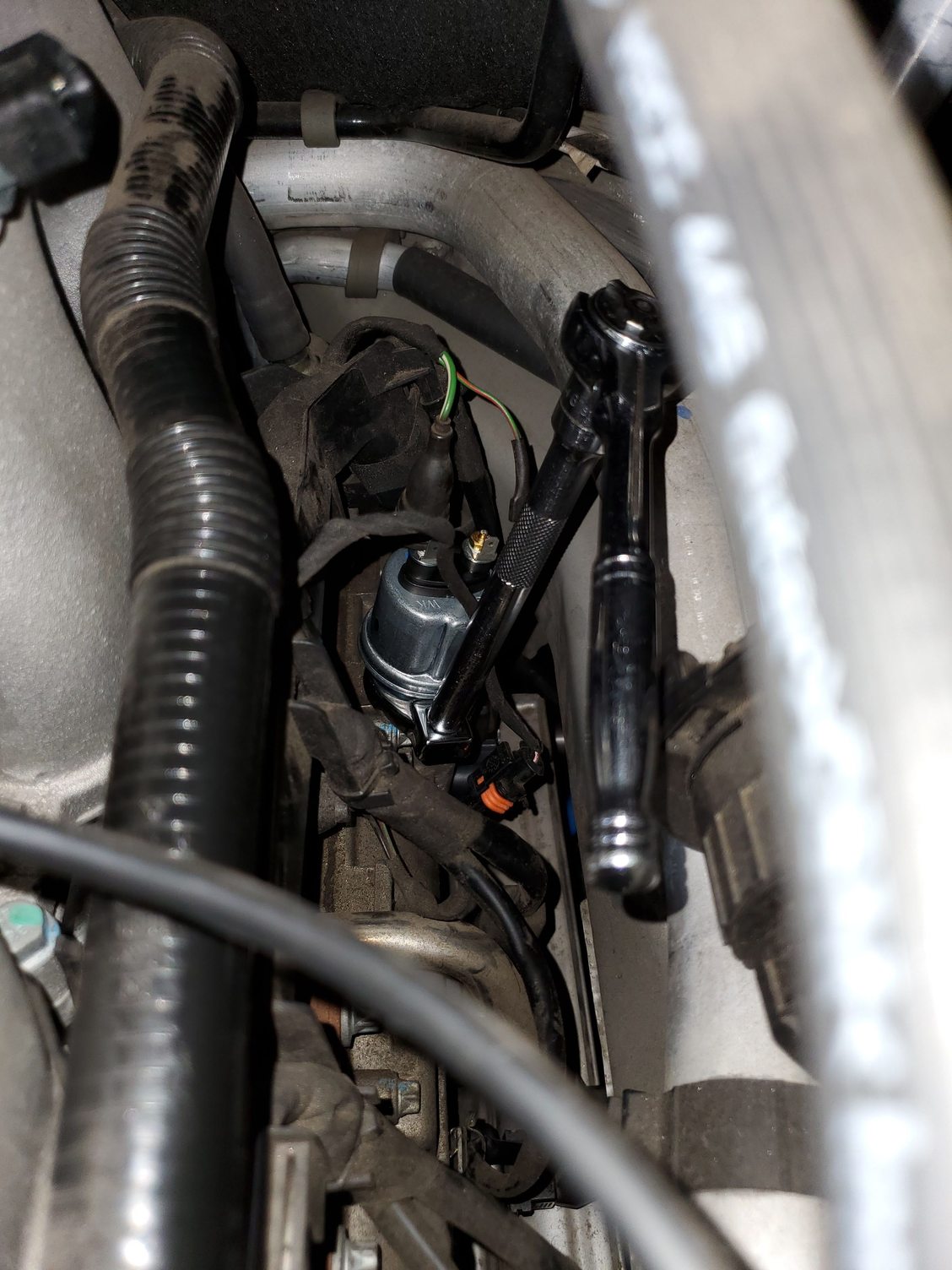

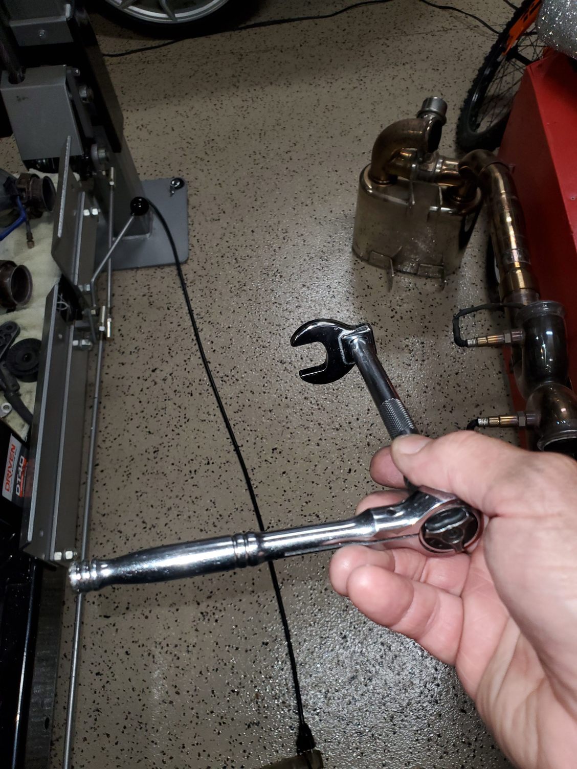

I changed mine because with the engine not running and the gauges energized, my oil pressure was reading about 2, not zero like it should. I always had excellent oil pressure because of this since I assume the sender was always reading about 2 higher than the true oil pressure. Wife's is doing the same thing. Will change hers when I do here next oil change as well.
Changing it is not very difficult as long as you have a crow foot wrench for a socket. Make sure you loosen the sender by the nut underneath the canister and not by turning the canister itself - reinstallation the same. On an M97 engine the sender is on the right side of bank 2 toward the front of the engine bay.
997.2 is different as the oil pump isn't speed dependent.
I know that on non-S cars is far more difficult, but on my car it was pretty simple. I found that mounting the two tubes between the intakes was the most challenging part. I bet that a skilled mechanic can change the AOS in less that 2 hours.
Can't compare it to my BMW e90, that was a PITA.
Idle cold : 5 bar
Great work getting that AOS fixed. As for your oil pressure, I agree, I like to see a bit higher pressure than 0.8 at 100 because at 110 it could be even lower. As you are aware, the pressure is directly related to temp and engine speed, so even a 50 RPM difference can yield a change in pressure.
What oil brand and weight are you using?
Mine is dead on zero while in accessory mode. Btw, I changed the oil pressure exactly the same way, from the engine compartment, only I had to cut and weld a 19 wrench to an extension. Crow foot wrench is a mistery where I live.
Thanks ! You are right, even 50 rpm can make a change. But from 0.8 to 1.5 at least is a long way ..
Car had only Mobil 1 0w40 changed at 5k, but when I bought it I switched to Castrol 5w40. I feel that if the engine is sane, it should produce a decent amount of pressure with any oil, no matter how crappy it is (ofc with the right viscosity for that car). I plan on going back to Mobil 1 0w40, but this time I bought oil from Western Europe, because oil produced for Eastern Europe is of lower quality.

Mobil 1 0-40 is more like a 30w oil after its seen some miles. So I would pick the thickest 40w oil you can find. It might only make a 0.2-0.5 difference, but it’s better than nothing. What about a 50w oil? Is that certified for your car?
Great photos... What size crow foot wrench socket?
found this video. If the space is too tight to get the wrench in because of the intake manifold, it looks like you can reach it and loosen it from the bottom of the car. Then twist it off with your hands from the top side.

crow foot is 19. You have plenty of space from the engine compartment. It’s far more easy than removing the coil shield and accessing from underneath.
