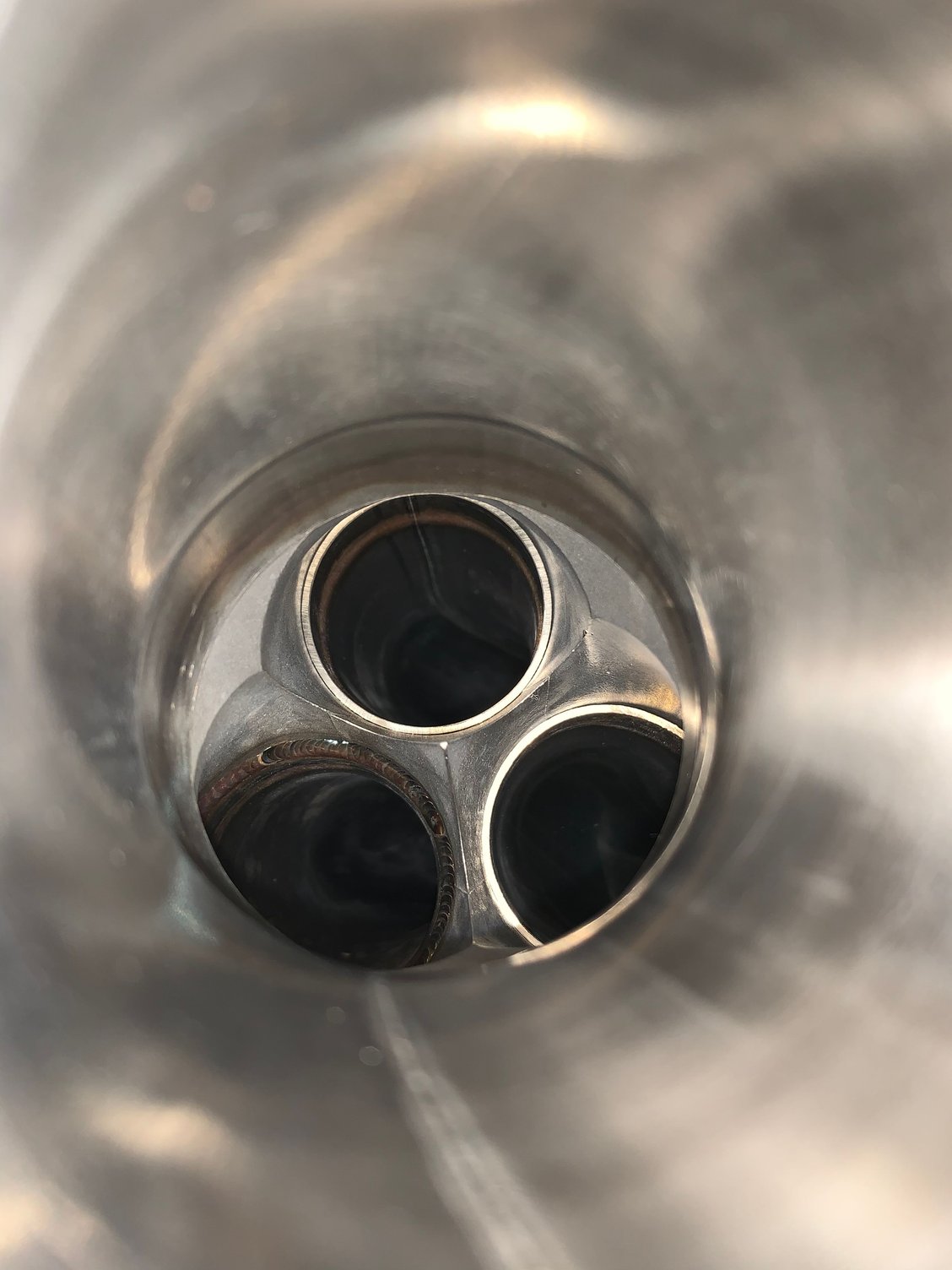

Post up a picture of the ones you're considering. The impotent attributes are how the merging collector is done and that the tubes are equal length with smooth paths so the exhaust pulsed stay sequenced. The X51 headers aren't much better than the stock ones IMO.

The fabspeed merge is perfect. And look at these details!

Post 1, pic 1. They look nice but so far no one has chimed in with a set. Grant it, I have zero issue spending more money when its worth it, Fabspeed is twice the price.
RTL5009, those pics are fantastic. Of course looking in the collector I see only 1 pipe is welded {weird} but the quality speaks for itself.

I actually submitted a ticket to Fabspeed on that. I figured it was purposeful to set the collector and then welding the outside but I wanted to verify.
