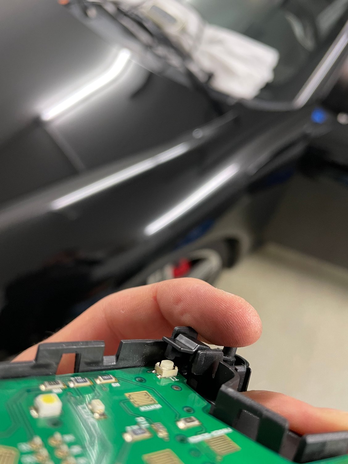

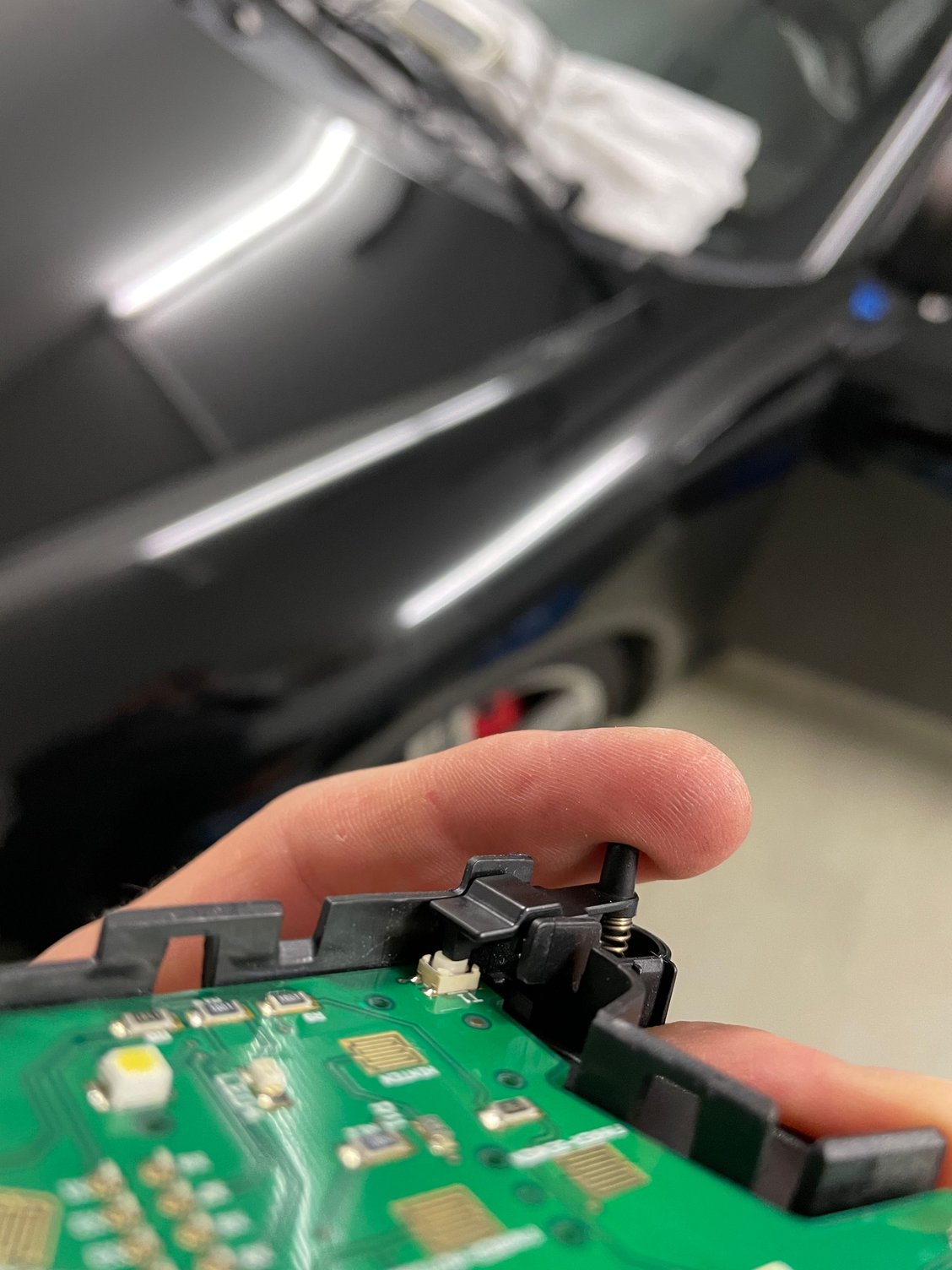

So here is the mechanical switch. Measuring the 4 pins, it seems to work correctly.
Cannot find any microcontrollers around it, goes straight to the main harness that attaches the door panel to the door.
Ideas what to look for next?

So are you saying that the switch is mounted to the board but doesn’t have any electrical connections to the circuit board?
if so I’d check wire continuity between the wires attached to the switch and wherever they terminate.
if it is connected (electrically) to the circuit board then look for broken solder joints.

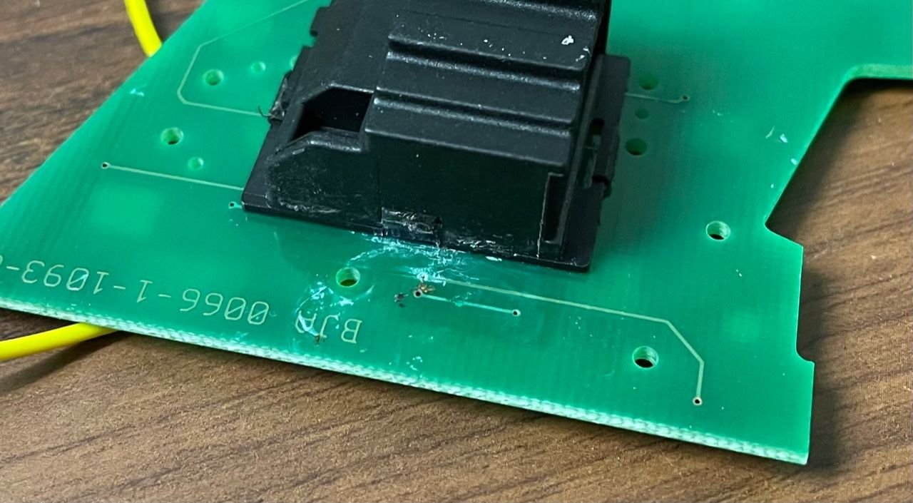

Ok, no wonder there's little to no information found specifically for the 997.2 and my issue (where everything else seems to work, except for the lowering when grabbing the inside handle).
As my understanding is that there is just maybe 1? micro-controller compared to numerous on the 997.1, it sounded unlikely that the micro-controller would be the issue.
As mentioned earlier, I had verified that the mechanical microswitch was working correctly, but apart from that I was a bit blocked until I got my hands on the wiring diagram.
Before that, I was doing some guesswork (figured out the ground pin A8, but not which pin would be for the microswitch signal), with the diagram, it was clear, A7, and no current was flowing between the Pin and the micro-switch.
I was very surprised as the PCB otherwise looked very clean on the front side, and there were no resistors etc. anywhere on the A7 line.. but now I was convinced something must be going on on the back side, which is a pain to get to (used a sharp knife to loosen the plastic connector that has been melted together..) Once I saw the back side, I could tell something is not right, and the final issue was actually the connection between the front and back (through the tiny hole). I know very little about electronics and how usual that is.. but sounds rare to me. Guess some work of humidity.
Even after cleaning up the PCB as well as I could it didn't work so I took the easy path and just soldered a new A7 line, and now it's working again
