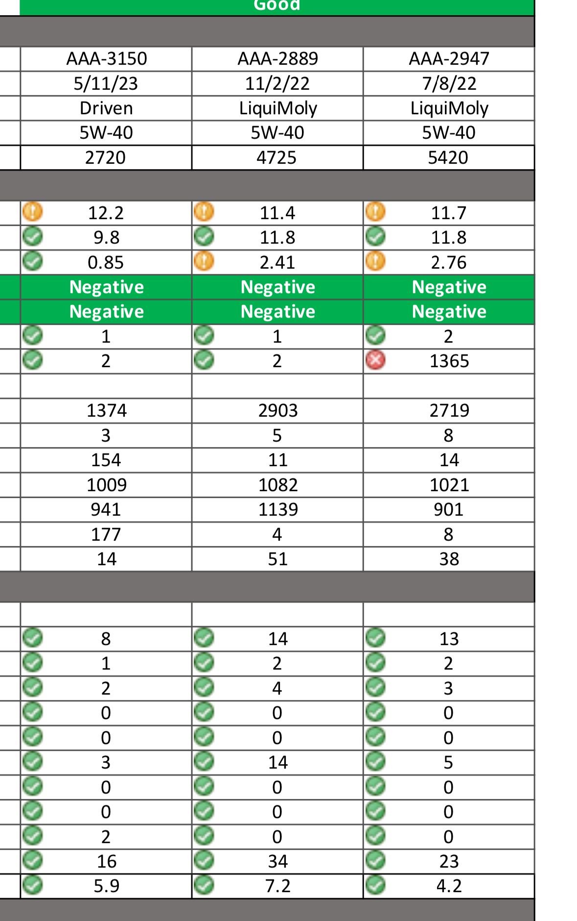

Did Lake offer an explanation for the 154 Magnesium? Unless possibly the previous owner was running an oil with it and there's just cross contamination. If you had been running DT40 or DI40 before that and there's no cross contamination I don't understand that high of a value unless possibly it's related to the special upgrades your engine got.
Also if I recall you recently got new injectors but I see your fuel dilution doubled, jumping up to 1.9% in the 8/21/23 most recent report -- is that with the new injectors? it is weird because your fuel dilution is twice as high as the previous sample but your wear is half (usually fuel dilution is highly correlated with wear metals). It's also weird your oil viscosity is better with the higher dilution.

Magnesium level was never discussed. Here are the 2 pre injector replacement reports and the 1st post replacement. Disregard the silicone spike, I used the wrong collection bottle and it leached into the sample apparently.

haha ya I remember that about your Si It is sort of weird though that your most recent report went to 1.9% fuel dilution... those should both be summer blend fuel looking at the dates making it even more strange.
EDIT: for anyone that comes along reading this later, based on another thread it seems highly probable that this was due to the HPFP
