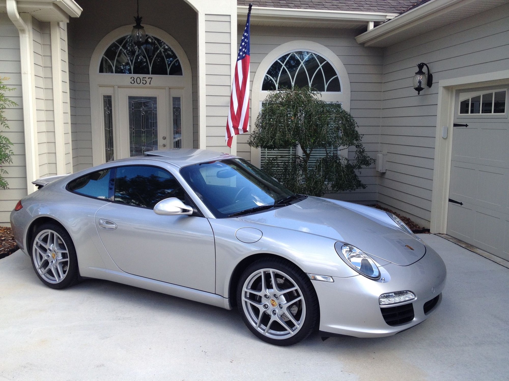

Make it easy and get a 997.2 C2 or C2S. That'll help you avoid going off on the IMS tangent. That's what I done when I was looking for my first Porsche. Found a very nice '09 C2 in Florida on Autotrader. Excellence Magazine has a nice Buyer's Guide for $14.95 that's a very useful reference. I also recommend joining PCA on the Test Drive membership that gets you contact access to member ads.
Seller's picture of the car I purchased.
