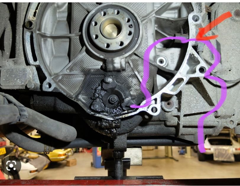

can somebody please explain. Dear jake. Would love to retrofit my car with your solution but need to be sure first. Have 997 m96 motor. 2005. I need to inspect this via a borescope and you told in one of your videos about an option.

Is this sensor (red arrow) when pulled an entrance for a endoscope to identify the IMS flange and so the version? Small vs. Large ?

I think I am on something. That’s the crank shaft sensor. Easy to remove. There you can put the probe endoscope in there and bring it down to the IMS flange I believe.
I think you are too. Let us know any tips and tricks, and your results, if you try out the endoscoping through this sensor hole. The nut size endoscope-viewed perceived difference (13 v. 22) should help you determine the IMSB type without having to actually measure the nut.
