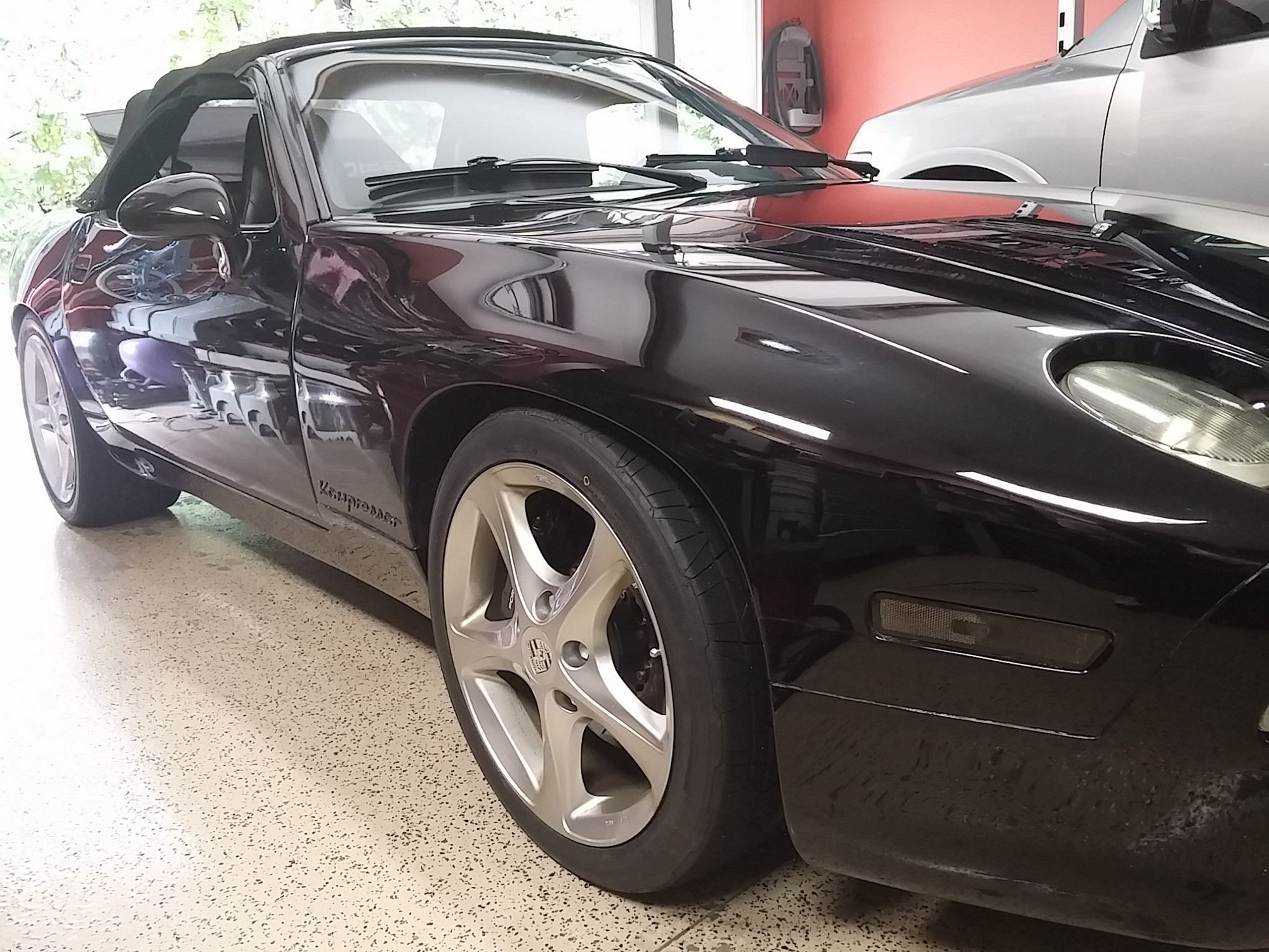

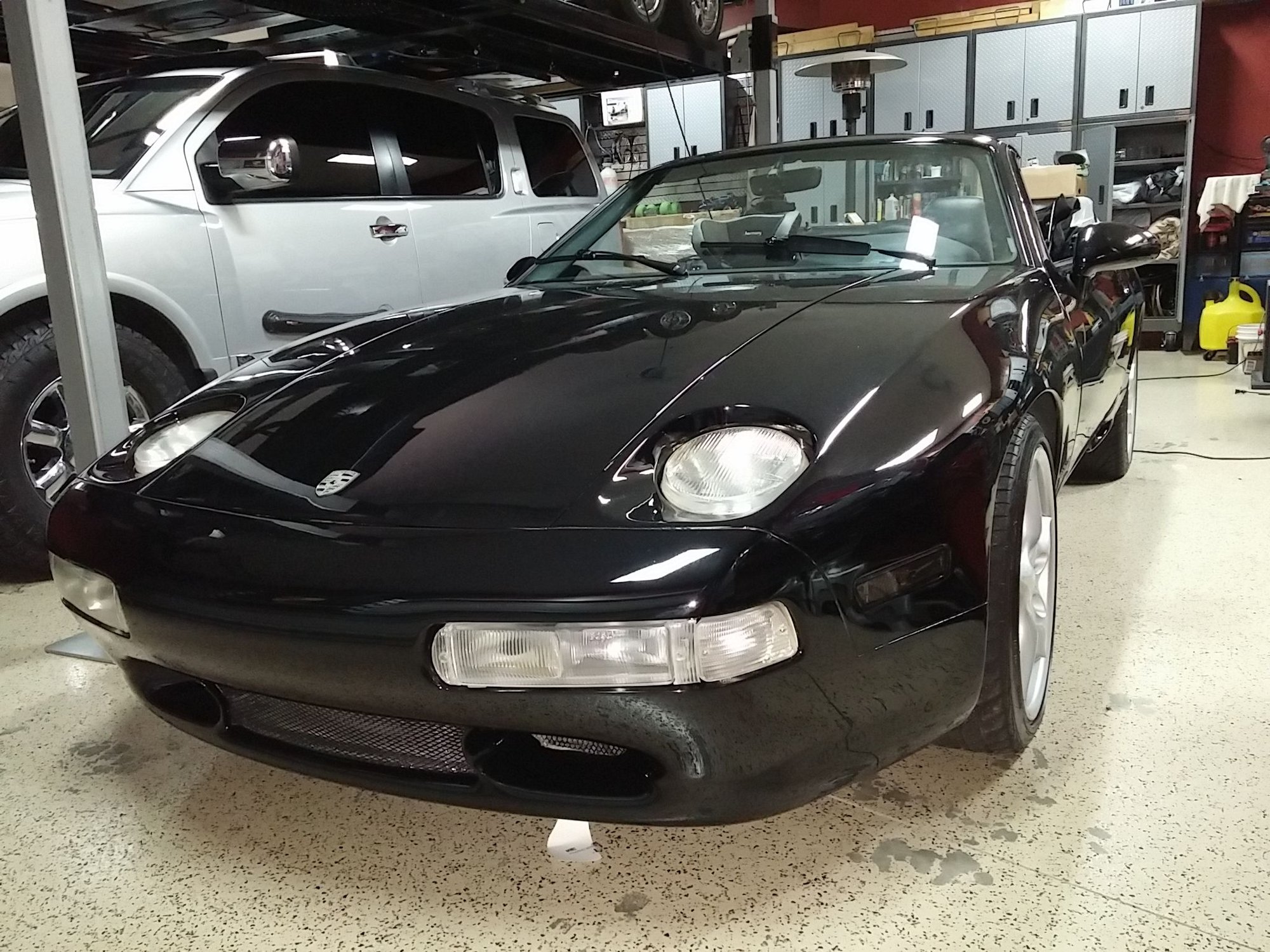

Be very careful with those cutting compounds and an orbital polisher, especially on a dark car. If you're too aggressive, you will cut right through the clear coat into the paint and a detail shop won't be able to bail you out. I also do not like orbital polishers on dark cars. They create swirl lines that reflect as curved scratches when the sun hits them a certain way. I do any polishing or compounding by hand and in straight lines the way wind would flow over the car - finished product looks much better with fewer scratch reflections that way.
Both of these cars were done by hand with a Turtle Wax Jet Black Kit, yes Turtle Wax. It's unique in that all the products in the kit are black in color so it fills any small imperfections. After the 3 steps in that kit (clay, polish, wax), I then do a final coat with Opti-Seal to make it last until the next year when I do it again.
