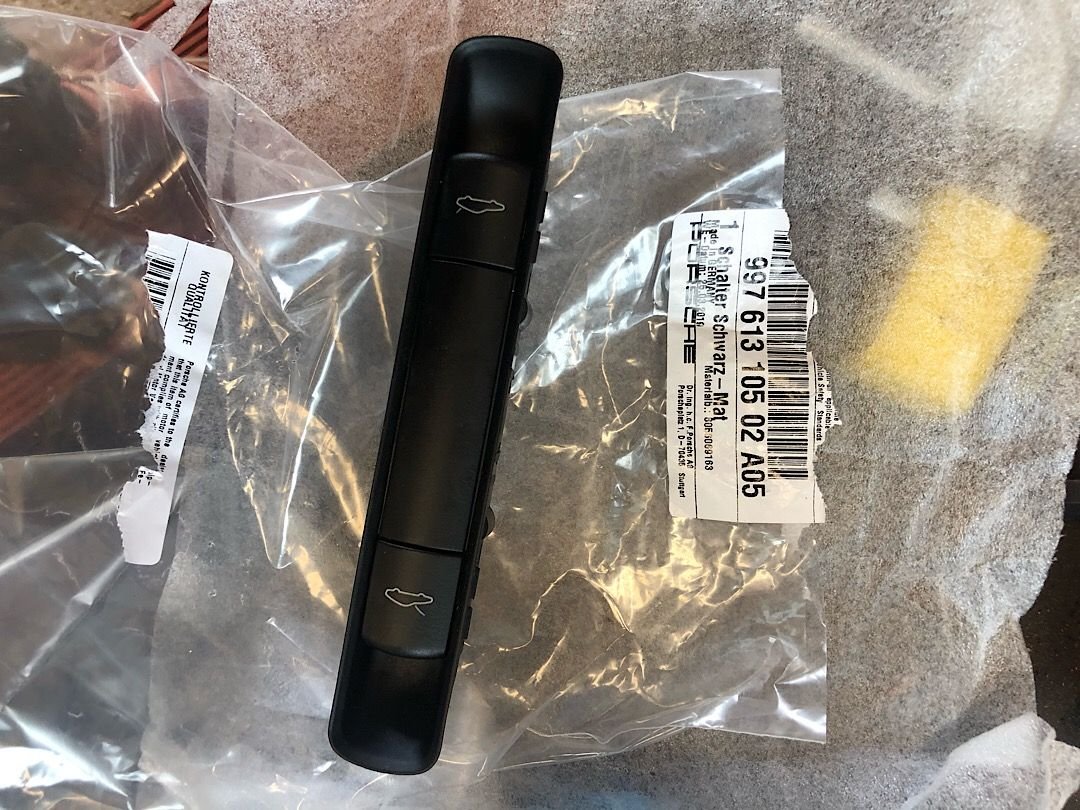

Hello,
My 997.2 C4S has developed a scary trend. The front latch opens without pushing release on fob or touching switch. It hasn’t popped while driving but does when sitting with engine off. I just had it detailed and I think they got water into either switch or maybe latch. Only other factor may be side clear side markers that were put in after detail. Anyone with a similar problem or ideas? Thanks.

Prolly a bad switch. Pull the switch and disconnect it. If the frunk stops popping open, just replace the switch.

This used to happen on my Boxster. Lift the switch, and blow some compressed air under it. Sometimes some sand/debris gets stuck under it and it pops open on its own.

Swapped out switch. Very easy and inexpensive peace of mind. 2 plastic caps cover 5 mm Allen bolts. Loosen about 5 turns and pop out assembly. 4 clips hold switch.

For the cost of $140 it’s worth not worrying about popping while on road trip. I expect the prairies will past briskly and really don’t want to be thinking about it. 😎🏁

Yup 😎👍

From the research I've gathered, this occurs due to the key fob being very sensitive. You might not think you're touching it, but even the slightest touch on the key fob can trigger the pop.
I replaced by interior truck lid switch (as shown above) and it did nothing to solve this problem.
