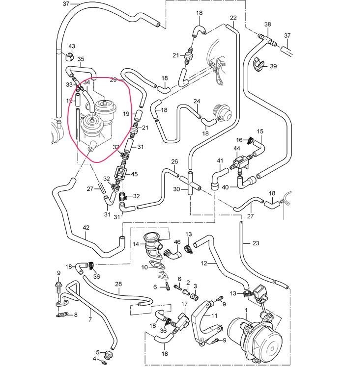

Looks like your divertor valves failing. They are located on top by the oil filter.
https://www.vividracing.com/catalog/...?cID=10&pID=68
