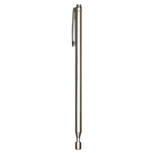

I've considered a 'worth their weight in gold' tool thread so this is pretty much the same thing. Going to kick things off with one that is super cheap and has saved me countless hours. I consider it cool because it saves time whenever you inevitably drop a bolt or nut into an area you can't easily reach or see - but it also saves your back picking dropped parts up off the floor.
Craftsman magnetic telescoping pen tool
