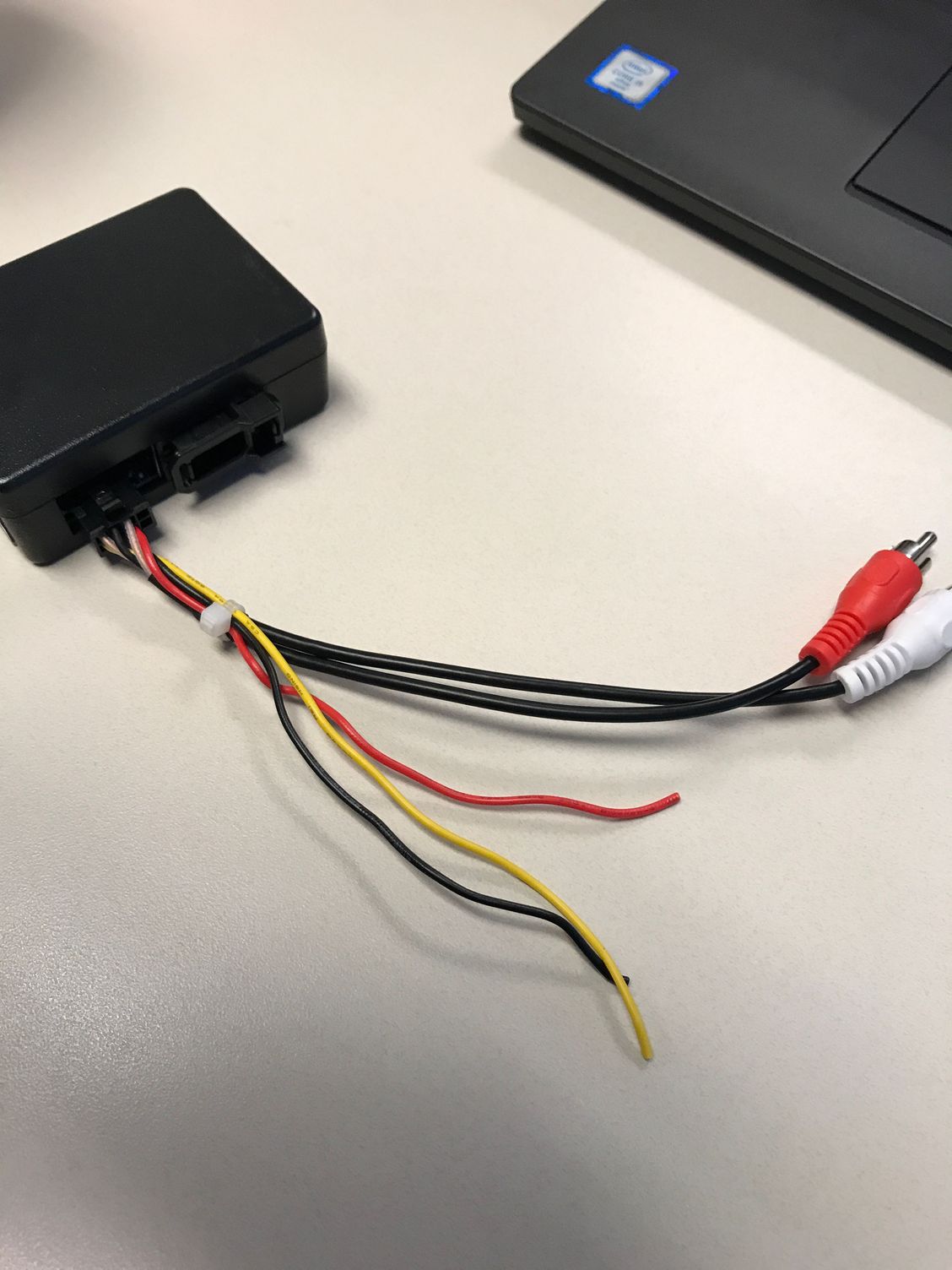

deviated
'03 C4S - I took the plunge and ordered one of the digital to analog MOST translator boxes from China. I do not have the Bose system and absolutely could not stand the output of the CDR23. I figured the worst that could happen is that it would not work and I'd have to build everything from scratch, anyway. Surprise! After a few weeks the box arrived. I got in touch with Rod at CAI to discuss my options. I was looking for multiple rear USB ports and chose the single Din Kenwood X701, though the Alpine was a close second. After speaking with Rod, he suggested that I send him the mystery box and he'd configure a custom wiring harness. Holy smokes, I jumped at the chance. After a week or two, everything arrived and was ready for installation. I also purchased one of the $20 MEGA interior removal tool sets from amazon. The initial installation had a few stumbles along the way. All of the issues that I had were my own dumb fault, as I mis-wired one of the lines out of the box. The system worked fine for about an hour, then nothing. Of course I had to de-install the new stuff and reinstall the original HU to test what blew. The original stuff worked fine. Then spent the night doing more research and found the solution. There's an unused phone connector in the bottom of the center column just under the cubby box (4 wires with female plug). The female plug has a green/blk (switched) wire that is the perfect solution for the spare wire (of the three) coming out of the Chinese Most box. The third installation took about an hour and WOW it's impressive and worth the small expense. Keep in mind, that I'm using the original speakers so nothing state of the art here. But it does CRANK and sounds about 50% better than the original system. Sound quality is below average by any modern standard, but it's passable and for less than $400 I get modern connectivity and pretty good sound. Really, just what I was looking for. Thanks to Rod from CAI, this was as close to a simple plug and go as I could hope to find.
Green/Blk wire in Phone plug
MOST interface box wrapped in anti-rattle.
9191
9191

#115
Join Date: Jan 2017
Location: Northwest Suburb of Chicago - AE #0956
Posts: 135
Received 0 Likes
on
0 Posts
MrZoop, thanks for the pictures and great explanation. That helps me when I finally get started...just thinking up of what type of receiver for the double DIN route.
Chris
Chris
