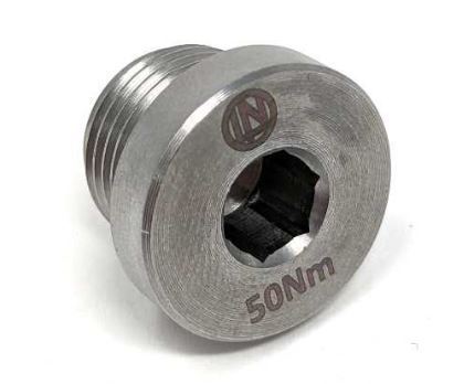

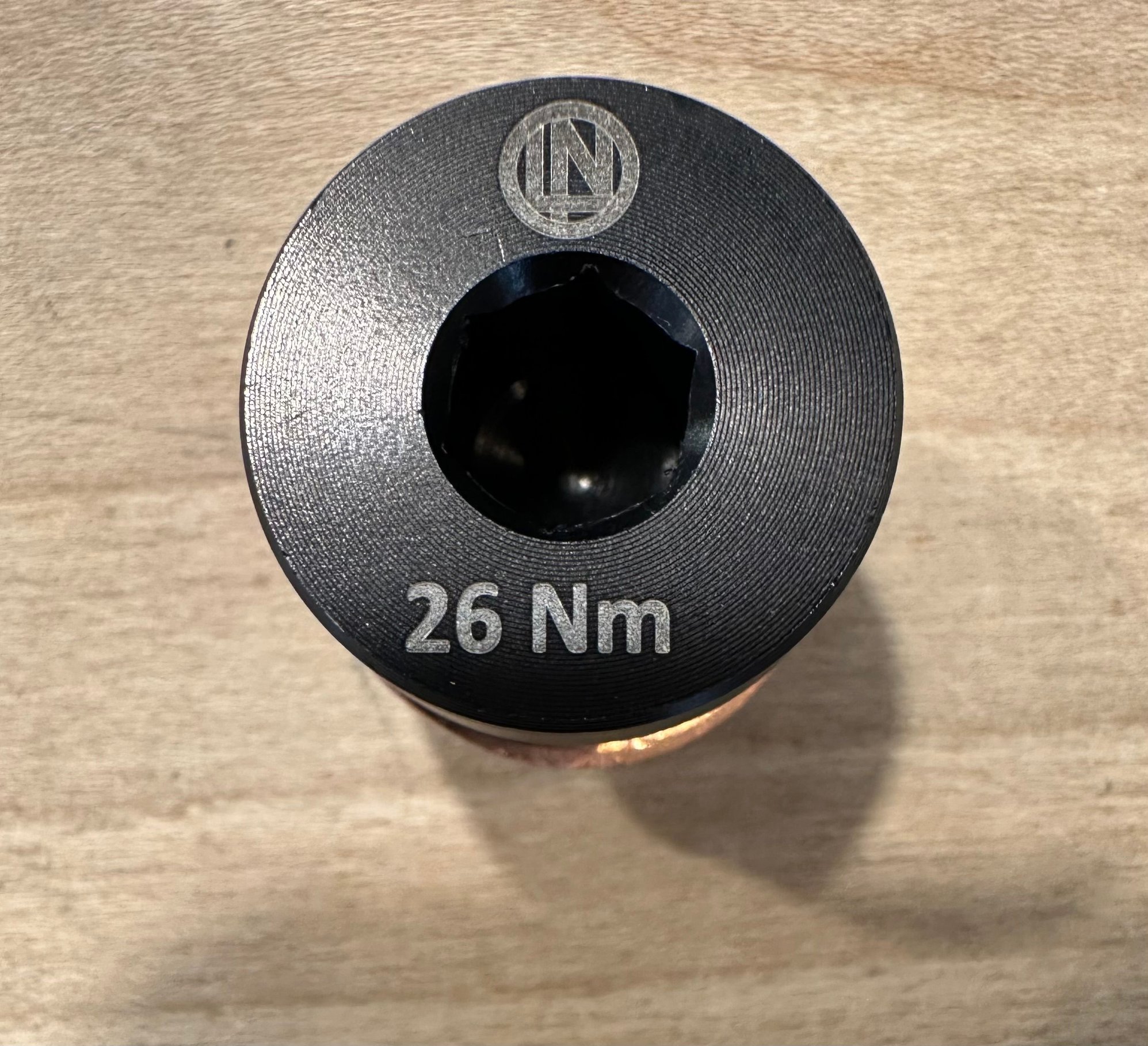

The torque specs are written on the face of the drain plug. For the older aluminum drain plug, it is 26nm or 19ft-lb. For the new billet steel, it is 50nm or 37 ft-lb. If you apply 37 ft-lb to the aluminum one, you will damage the drain plug and possible the pan. Here are the images to help with the data:
Aluminum is black anodized.
Billet is silver and all they sell now.
Cheers!

Confirmed - I chatted with LN and "go with what is written on the plug" is correct. The description on the site (at least for the trans drain plug) was wrong but I think they will update that soon.

26 Nm(marked on the plug) = 19.1766 ft-lbs.(so 19 ft-lbs) Always use a new crush washer. Mine has never leaked using this torque with a new washer.
