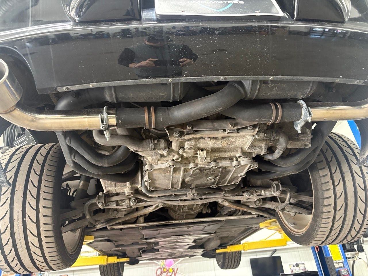

Just picked up a 2004 Carrera and it's got no mufflers (see picture). I think the way it's laid out I'm not going to be able to install an off the shelf kit, but I'm hoping someone here can point me in the direction of something that might bolt up OR mufflers I can weld in that sound decent (not sure I have space).

Hold on I just looked at their page and I think I'm a fool and I'm just missing the mufflers, I thought I had some aftermarket system from the headers back. This might not be as bad as I thought.

Looks like you just need mufflers.

It looks like it’s got stock headers that may have been painted/ceramic coated black (if it’s regular paint it won’t last long). Stock, or any aftermarket mufflers should bolt right up to the cats… you’ll probably need new tips if you don’t already have them… Good luck

I was told it's jet coated so it should last for a decent bit. I'm honestly relieved that they're the stock headers and cats, that makes life much easier.
