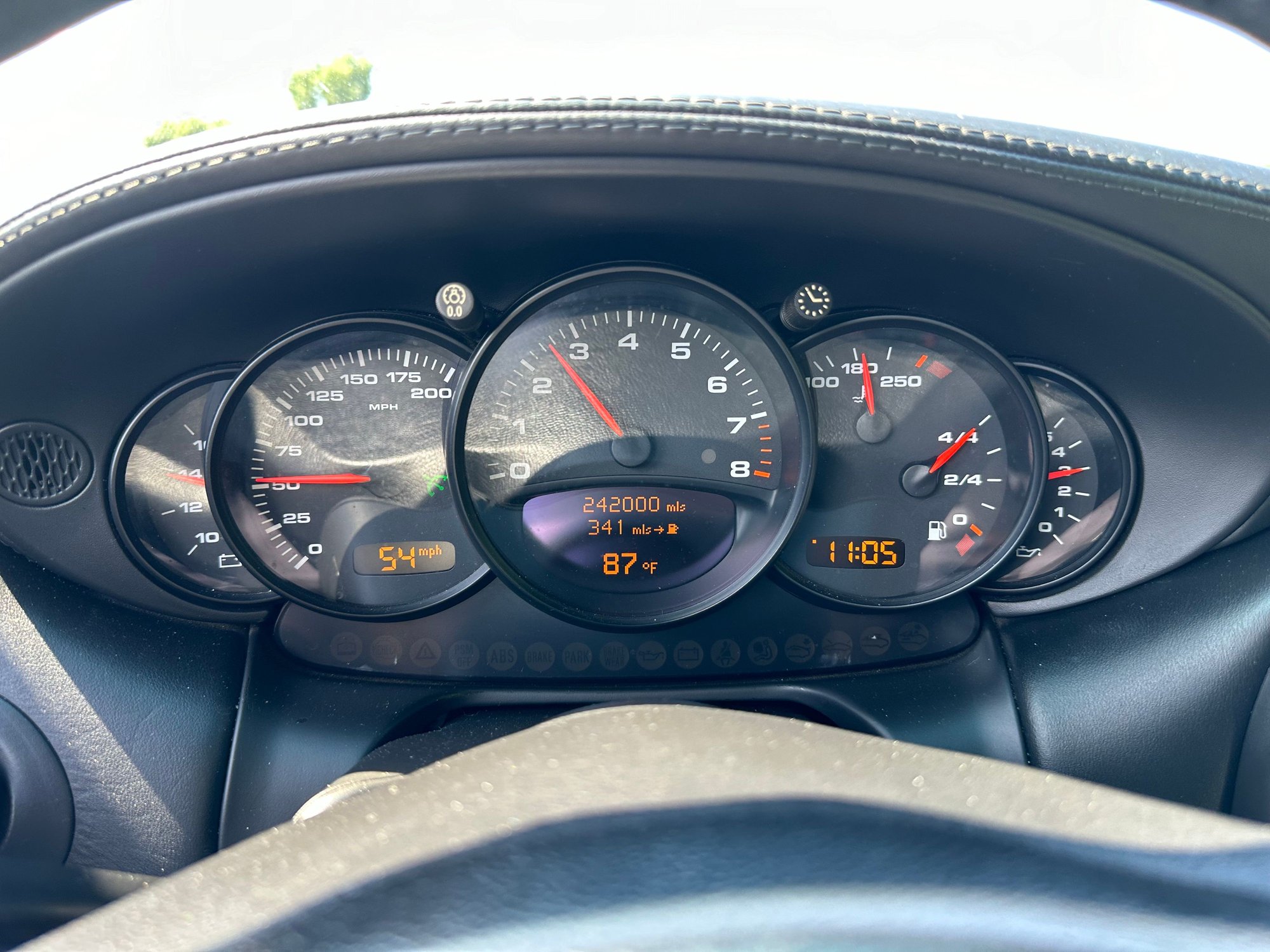

As a fellow owner of a 2003 C4S, I wouldn’t assume that there’s an urgency to fully rebuild the engine just because it’s at 130K. Save your money. If you have no signs of bore scoring and already have the IMS Solution, then you could still very likely double the current mileage with proper maintenance. Mines still very healthy at 242K+.

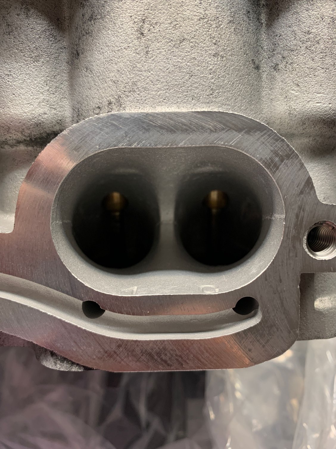

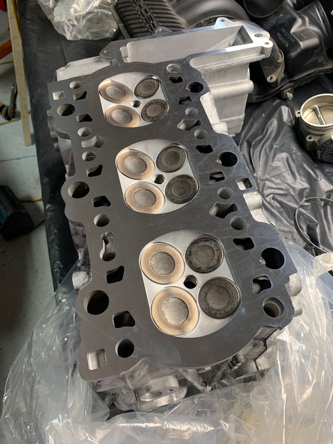

My heads went Hoffman for a full rebuild and stage 1 port/polish.
