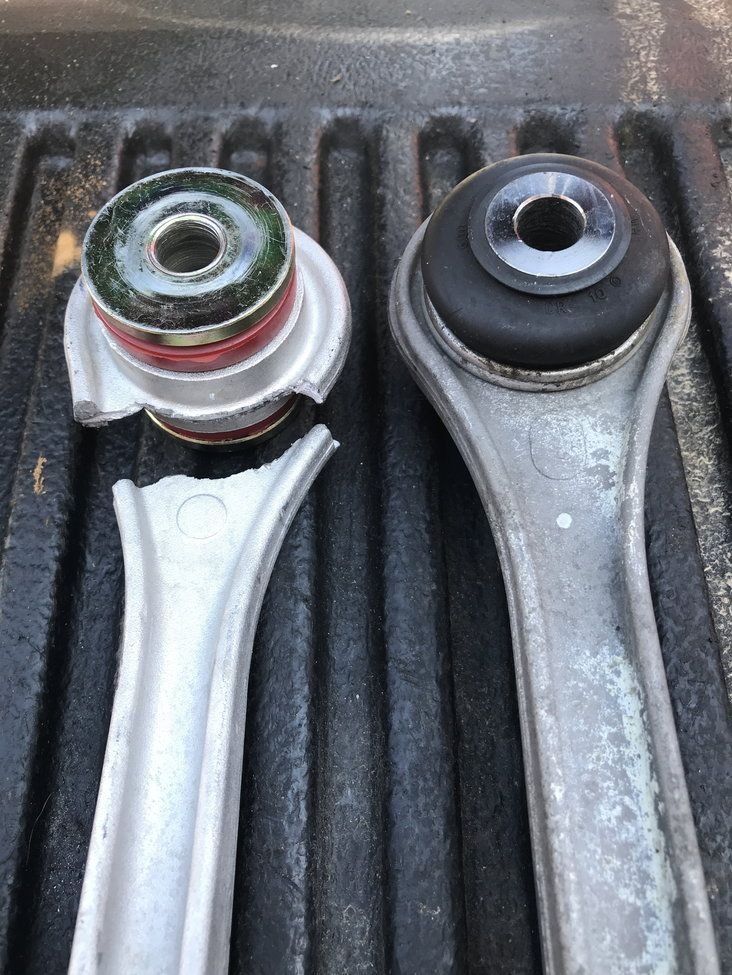

EPS is a company that has questionable products like their control arm. (see attached image) These things are known to break and have been mentioned on many forums. Obviously, the EPS control arms are made from substandard metal quality that could be dangerous or even deadly when they snap. Would you then trust a product that could potentially grenade your engine? Now regarding their roller bearing IMS product, Lee Jenkins of Hartech, UK sees a lot of failed EPS IMS roller bearings and posts them to the Porsche engine rebuilders forum monthly. Examine his most recent post. (attached below). Their IMS bearing product doesn't even sit flush on the shaft which has shown to grind into the IMS bearing flange over time. To make matters worse, they created a method to extract the Large Single Row 6305 IMS bearing on post 2006 engines. This a bearing that doesn't need to be extracted in the first place because it has very few reports of failure and is proven to handle the load of the M9X engine. Common sense would tell you that attempting to enlarge the IMS port by grinding into the case would introduce horrible amounts of metal shaving inside the case. What could go wrong?
