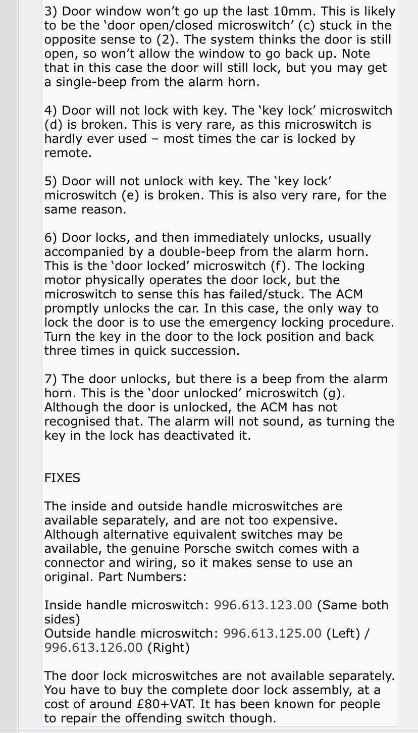

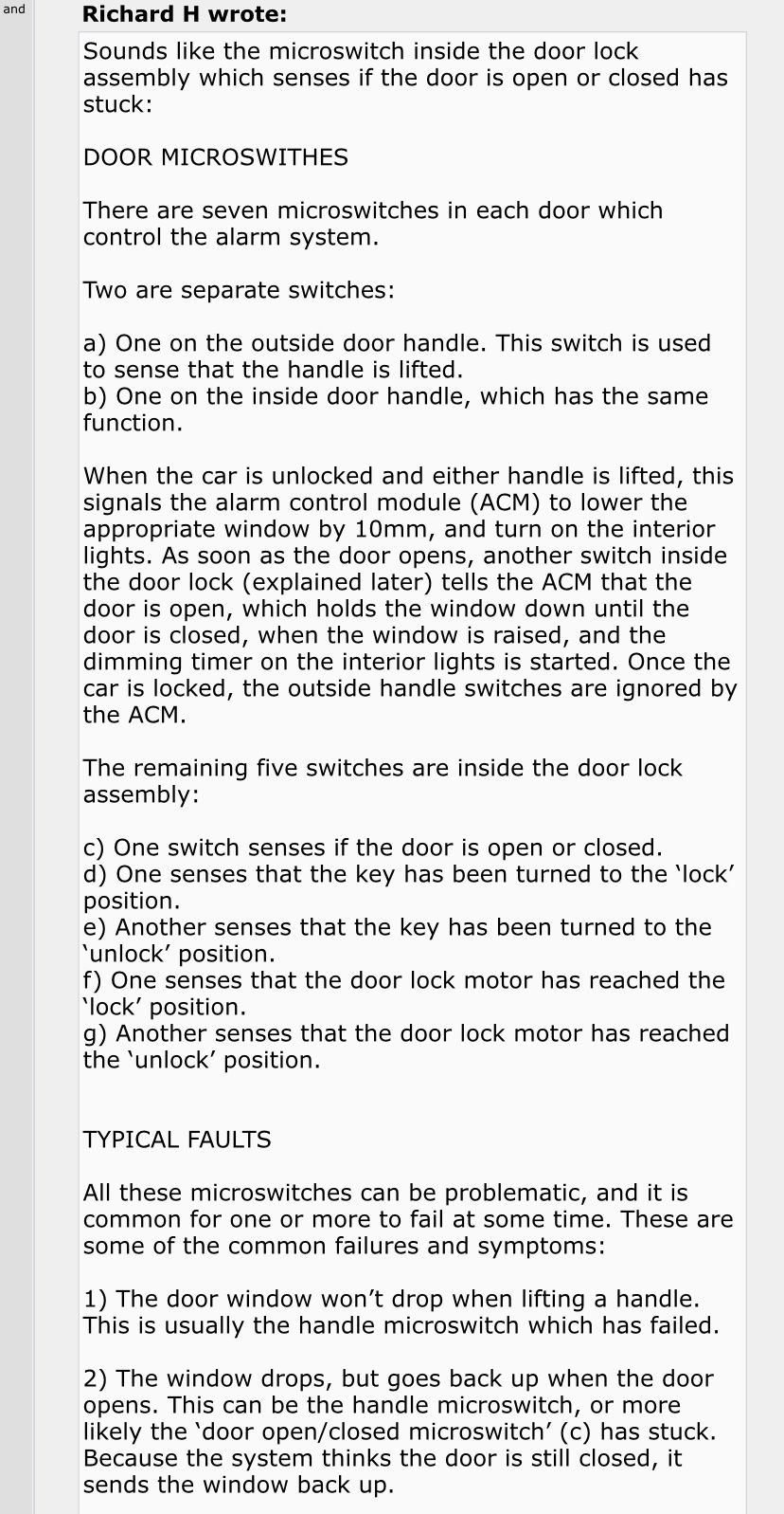

Old Feb 22, 2022 | 03:48 PM
Optionman1's Avatar
Optionman1
Joined: Mar 2019
Posts: 3,028
Likes: 2,162
From: NJ
Old Feb 22, 2022 | 03:49 PM
Optionman1's Avatar
Optionman1
Joined: Mar 2019
Posts: 3,028
Likes: 2,162
From: NJ
sorry these got posted backwards
